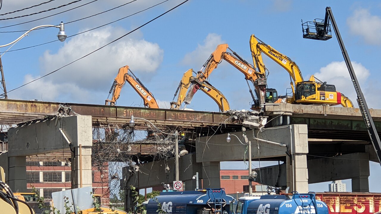

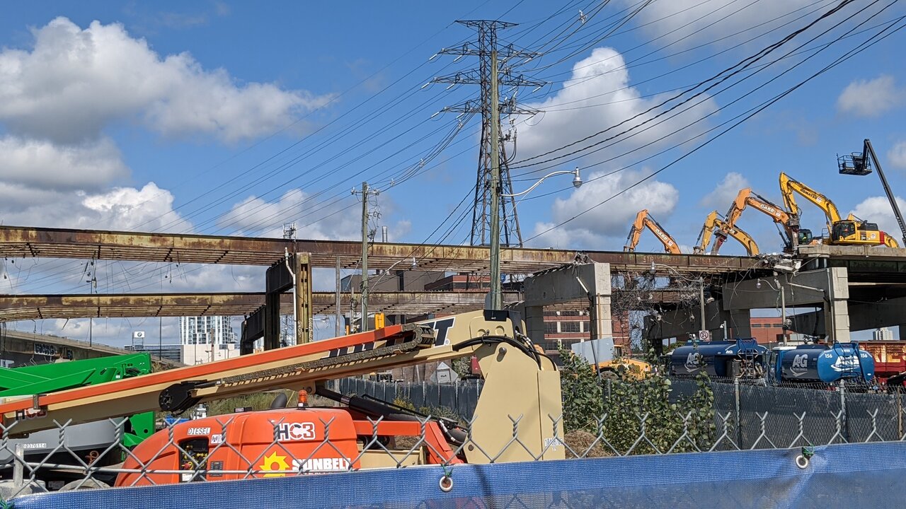

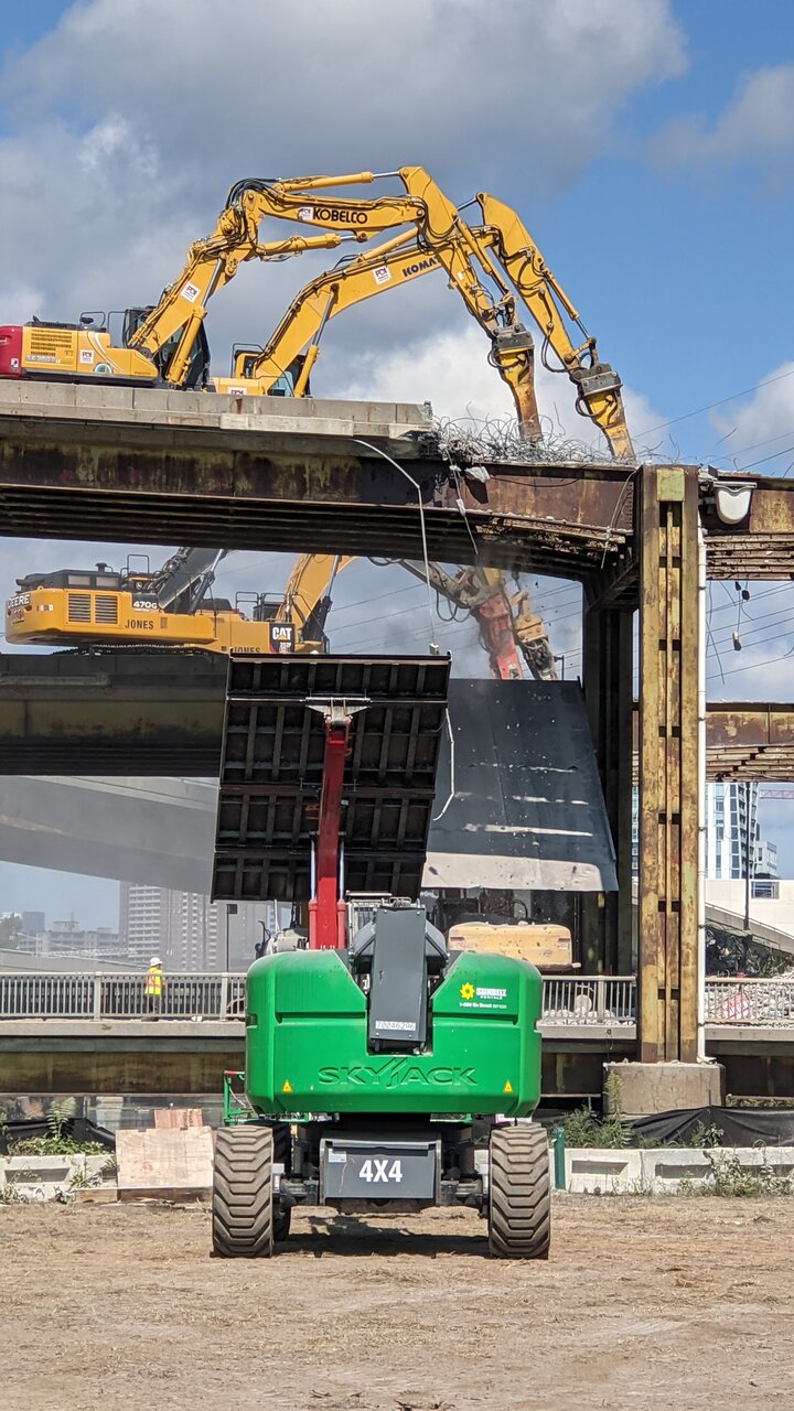

With the amount of equipment sitting at the east end of the ramp along with spare parts, time will not be wasted in removing the existing decking before removing the steel beams this long weekend. More equipment was arriving as I was shooting the area after I left the ramp area.
They were sitting up other equipment next to the Keating channel as well for protection of not having material falling into the water.
It took me all week to find a day to get the last shots of the expressway before it came down and it was tight doing it that day.
The area is going to look a hell lot better with this section gone and when the rest get moves to the north. Still better off removing the whole things regardless of adding an extra 5-10 minute travel time for 30,000 drivers.

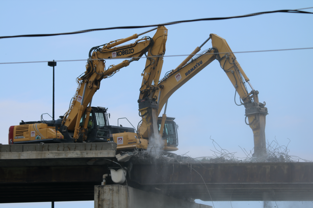

I took my family there tonight to watch from a safe difference. My kids were fascinated by it. I was trying to explain what I guess was the process, but would love an expert explanation of it. What are the steps roughly?
I guessed it was:
1) Remove ashpalt
2) Jackhammer away concrete and rebar of bridge deck
3) Cut and remove steel girders
4) Then jack hammer and remove concrete and rebar of bridge supports?
That's about it right?

That about right.
What I saw on Friday, no asphalt on the ramp with the centre median removed. Parts of the eastbound lane was partly broken up with a larger dump truck removing concrete off site to somewhere..
Don't expect to see any concrete on the roadway after this weekend.
May see a fair amount of girders/beam off the piers as well and store on the north side of the Lake Shore.

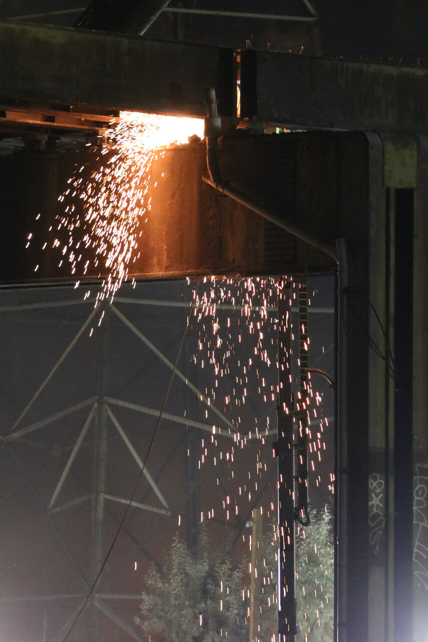

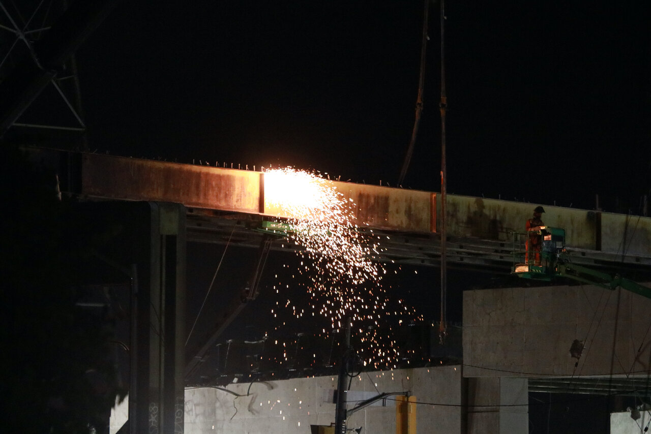

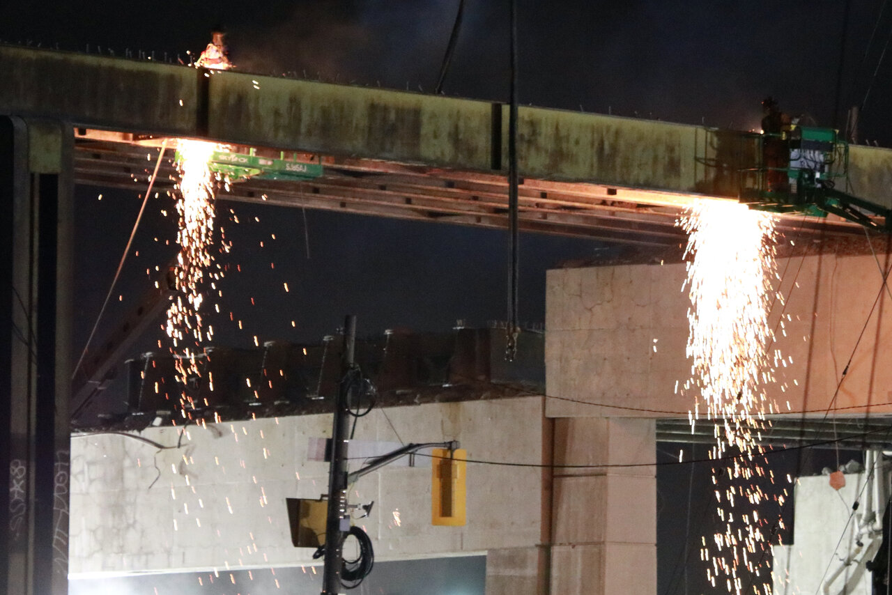

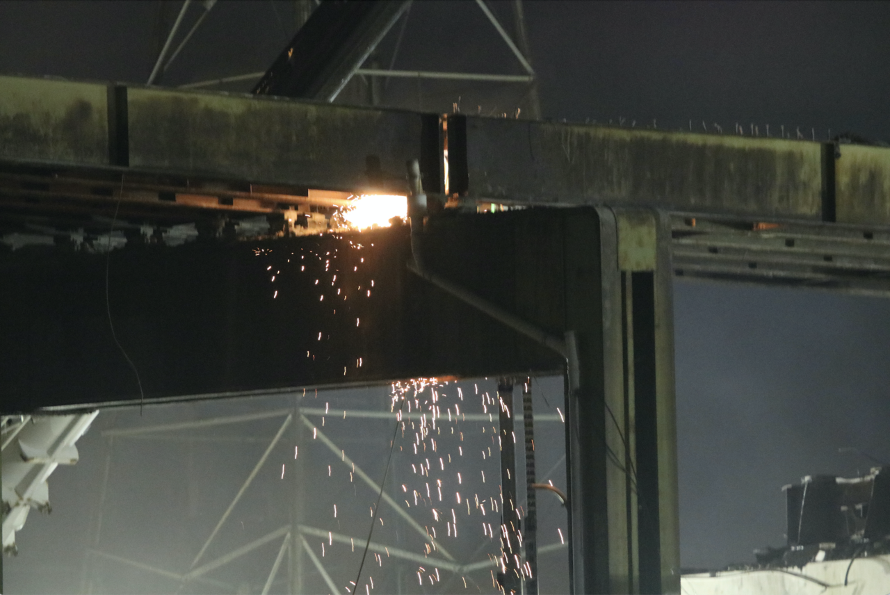

So this is kind of exciting... I guess they're using thermal/thermic lances to cut through the huge, thick steel sections as a crane lifts them aways.
And I'm guessing it's not just the horizontal girders, but the actual VERTICAL supports are also big steel pieces in many places.
That's a lot of burner bar work!!

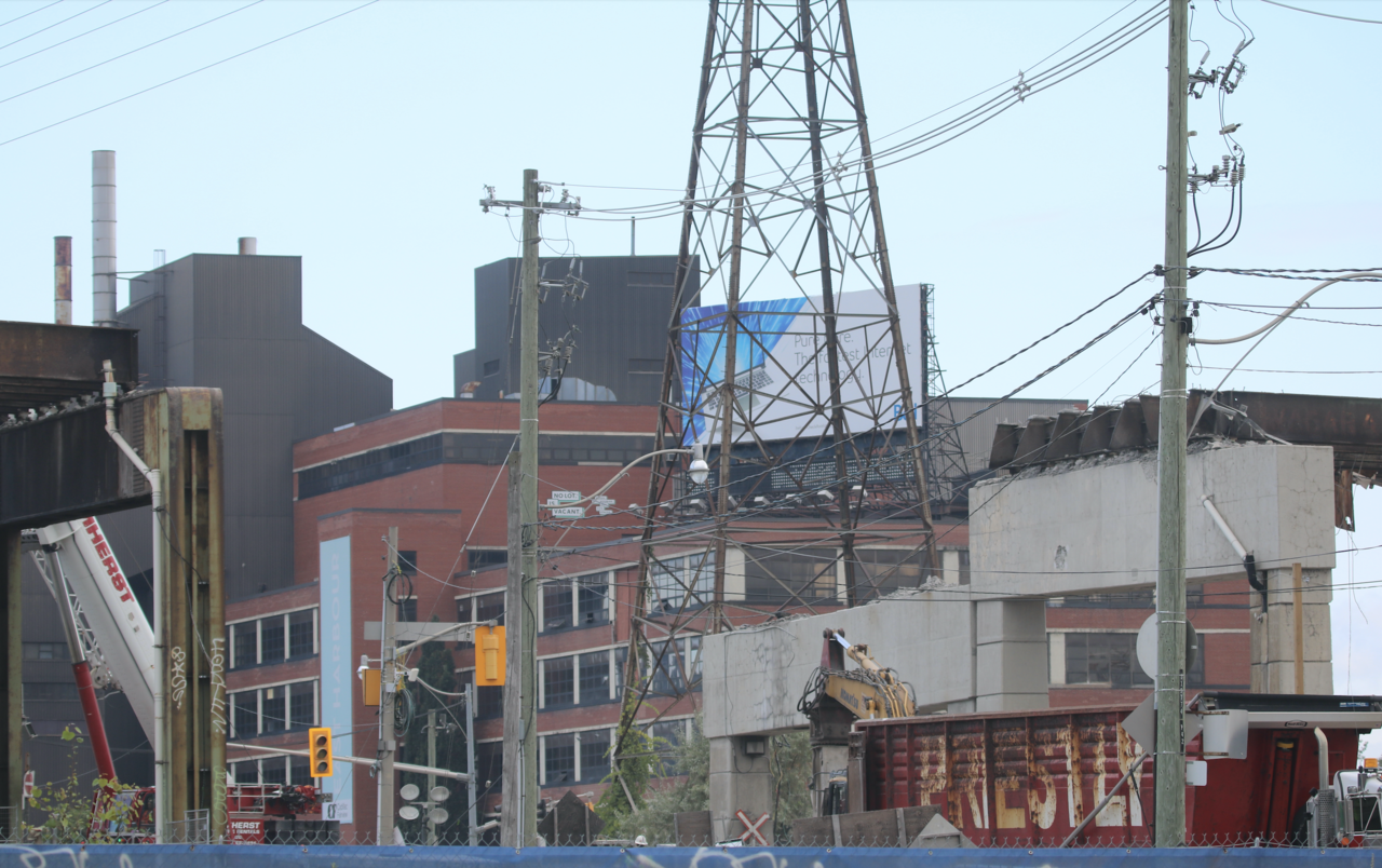

With the removal of the steel structure at Don Ways this weekend, it will allow access to the DVP for the coming weekend closures without being interfered with the rest of the removal. Got to keep the car folks happy.

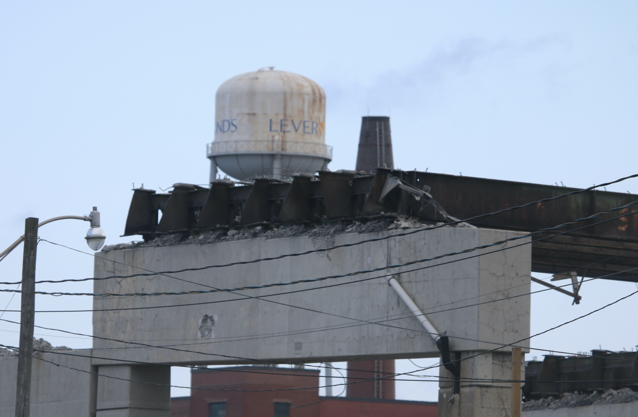

Not all the steel beams/girders went from pier to pier, but were cantilever and bolted where one connected to another one.
