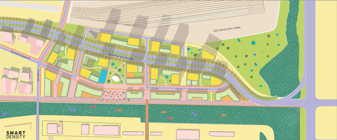

Just to bring this back to reality. In my piece, the design by Smart Density only looks at the section east of Cherry Street. This is the section whose reconstruction has not yet begun. It’s about 800 metres. And the key advantage of the teardown would be that it opens up more land. The five buildings on the north side of the joint roadway, in this diagram, are all on sites that would get eaten by the hybrid. There are also incremental games to the south.
Basically, highways are very big; this is an incredibly important part of the city; some change is still possible.
How likely is it politically? Mayor Tory is politically cautious, and it’s unclear that suburban councilors would support this, regardless of the budget benefits, no?
The budget benefits, while significant, are also less than typically described. The reconstruction is about $400 million more than the demolition option, not the $1 billion often described. $1 billion is the total project cost, but demolishing it would still cost $600 million.

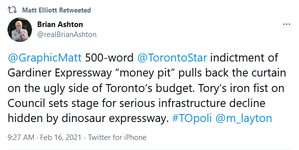

I just thought I'd drop this here:
From:
Why this is of note, in my mind...................for those unaware, Brian Ashton is a former Metro Toronto Councillor...................
He was always moderate, centrist, and represented the Bluffs area of Scarborough.
When his take is ...............as above............I feel like the needle is moving.
