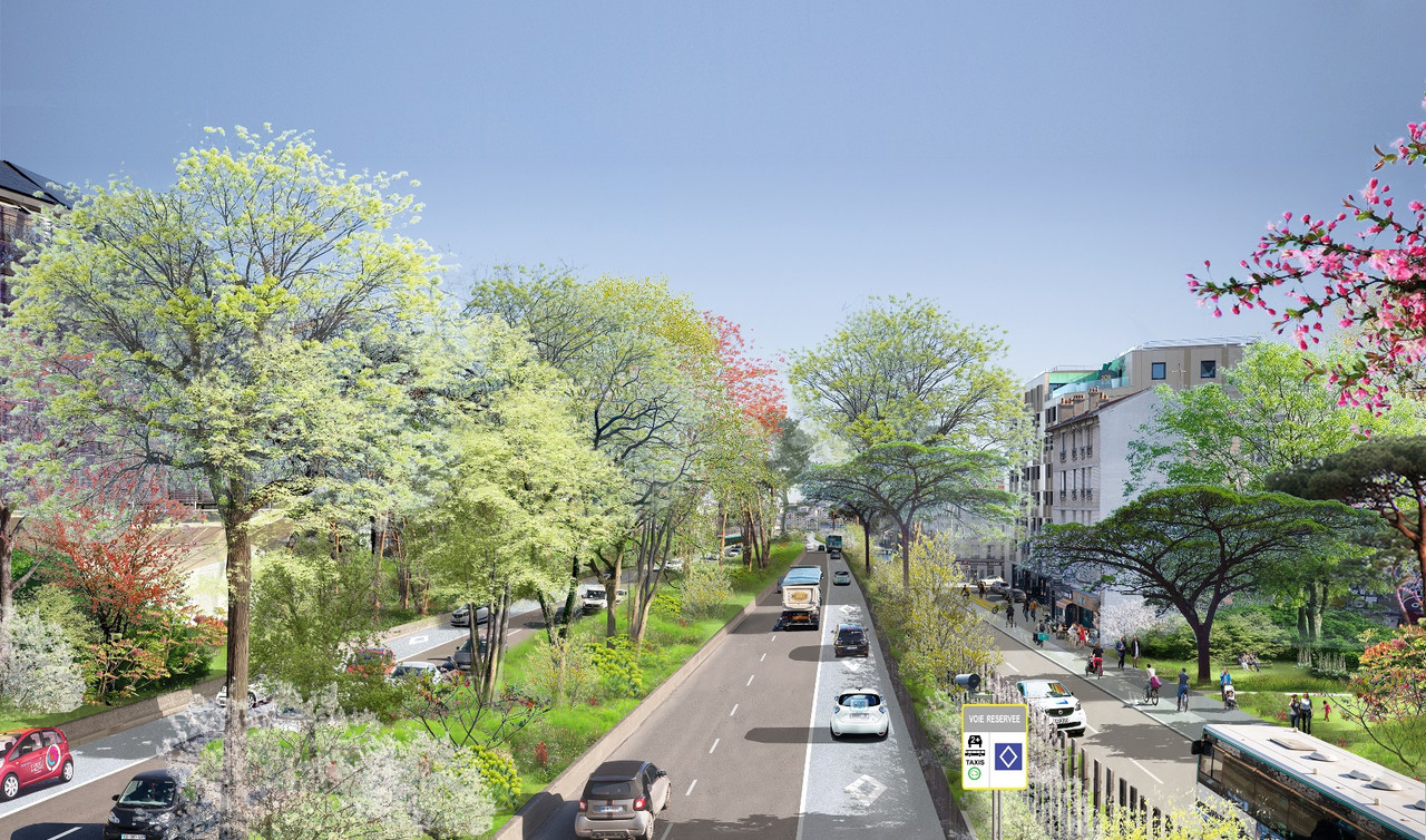

What you’re not mentioning is that Paris’ highway ring soon will be transformed into an urban boulevard, favoring public transit and green space.
In fact, most of the highways in the Parisian region (Île-de-France) will be transformed to favor public transit, against individual cars.

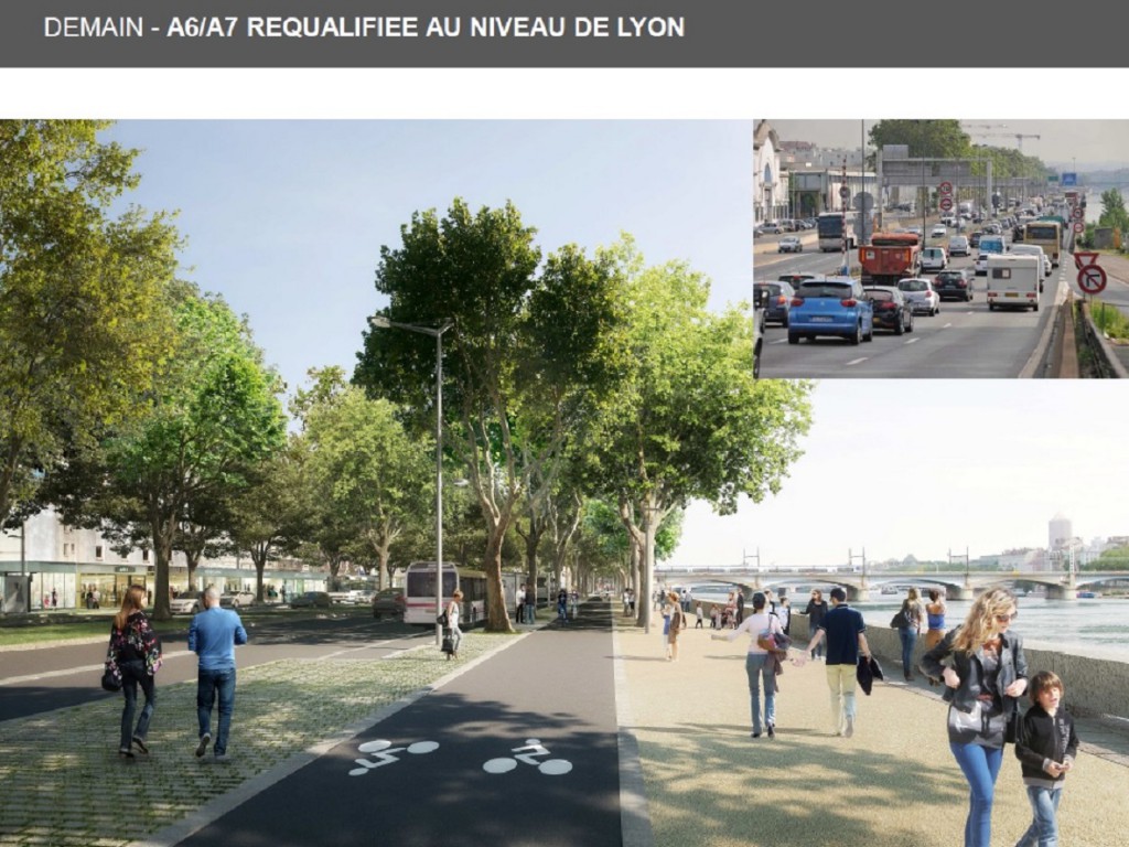

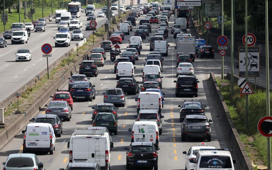

The same is true for Lyon, France's 2nd economic capital, which has an approved and financed project to transform a highway into an urban boulevard.
