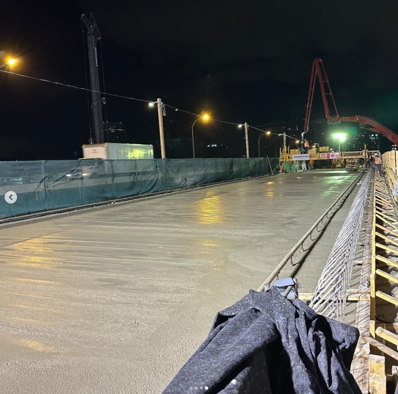

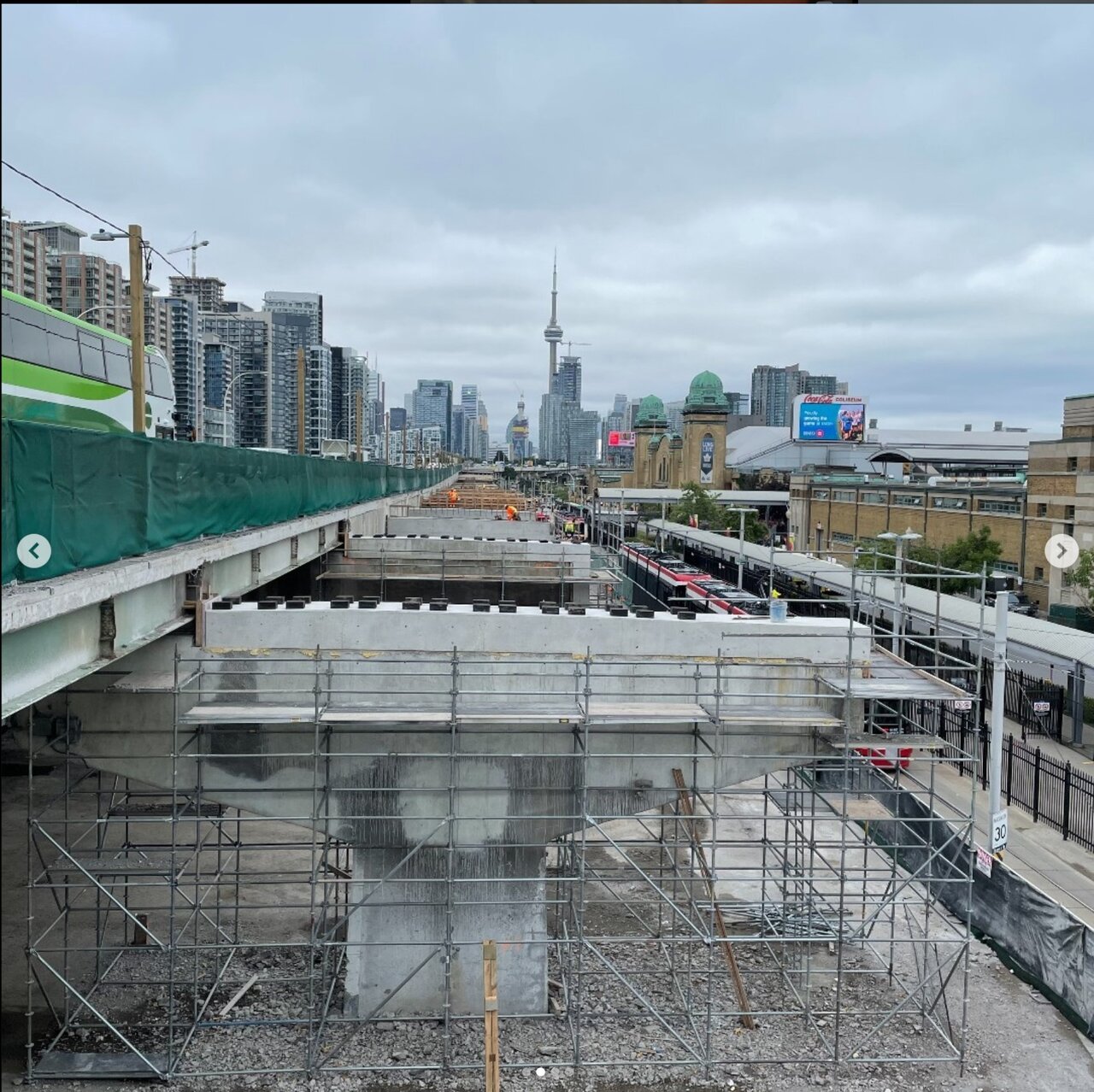

So everything they've installed so far that we (or I) assumed was road deck, was actually girders. With the start of concrete road base being poured last week.

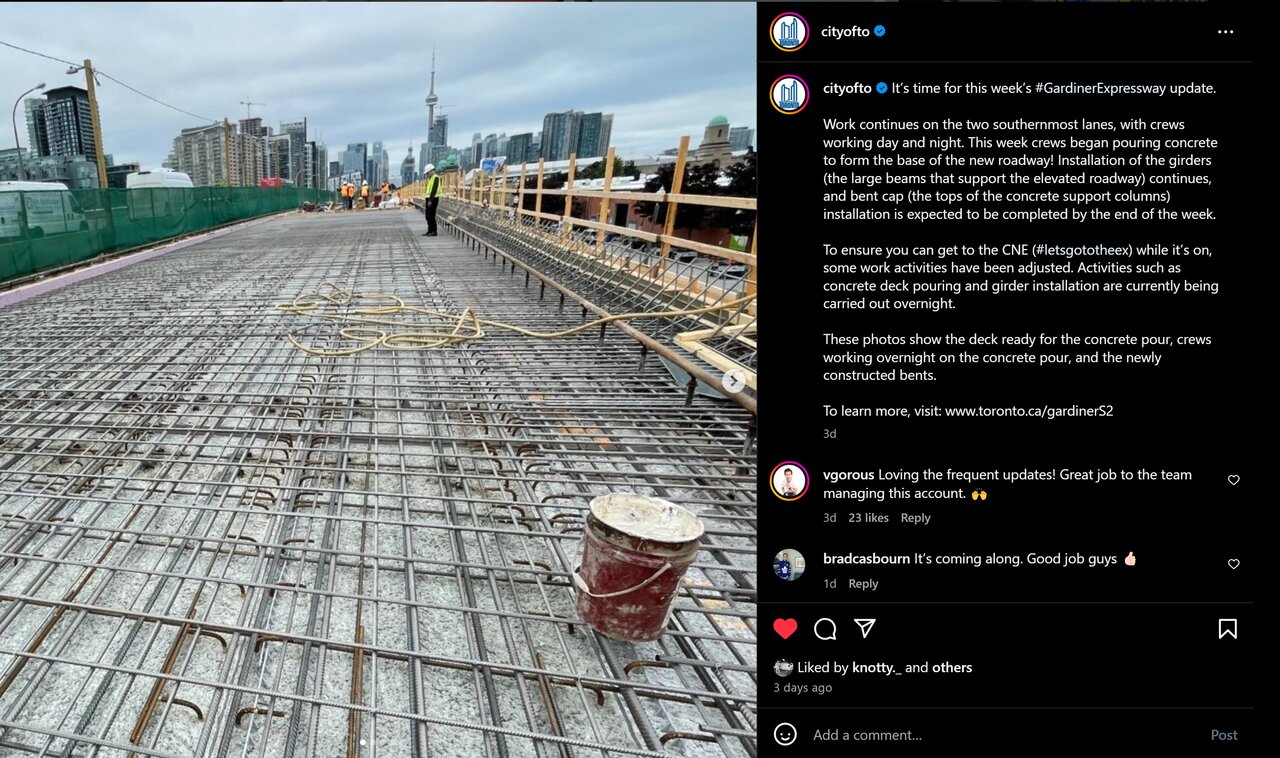

Does anyone know if any kind of newer tech is being used on this road deck? We learned years ago that concrete is porous and doesn't protect the rebar from salt damage. I know there are lots of new technologies like using specially treated rebar, coating the rebar in rubber or even using composites instead of metal at all. Anything used? Or in typical Toronto fashion are we just building as cheaply as possible, repeating the same mistakes and screw the future.

There are a couple new details that should make the structure more durable:
- Stainless steel are being used in areas prone to chlorine penetration (i.e. top of the deck, barrier walls, pier caps)
- Concrete deck waterproofing
- Elimination of deck expansion joints to prevent water leakage into the pier bents (this is the most effective aspect of this rehabilitation)
FYI, epoxy-coated rebars are not very corrosion-resistant and are no longer used in bridge structures.
What about fiberglass rebar? I've seen more examples of this being used in bridge/road construction in Canada. While one can argue it's more expensive, you can actually deliver more material per shipment and its easier to move on site due to it's light weight. IMO this is the project to use that on, but I'm glad to hear that there are already other efforts being made to mitigate deterioration (esp. waterproofing)
In terms of price, I think FRP and stainless reinforcements are somewhat similar, stainless steel might even be more expensive.
There are some constructability issues with FRP bars because they are very brittle compared to steel. They are hard to bend and are almost impossible to be field bent. In addition, if the City ever wanted to modify the structure which requires chipping out the FRP-reinforced concrete, the FRP rebars will break very easily and likely cannot be reused.
The MTO has standard details for concrete barrier walls where FRP rebars are used exclusively. FRP reinforcement is definitely something that is always considered in a new design or a rehabilitation project.
