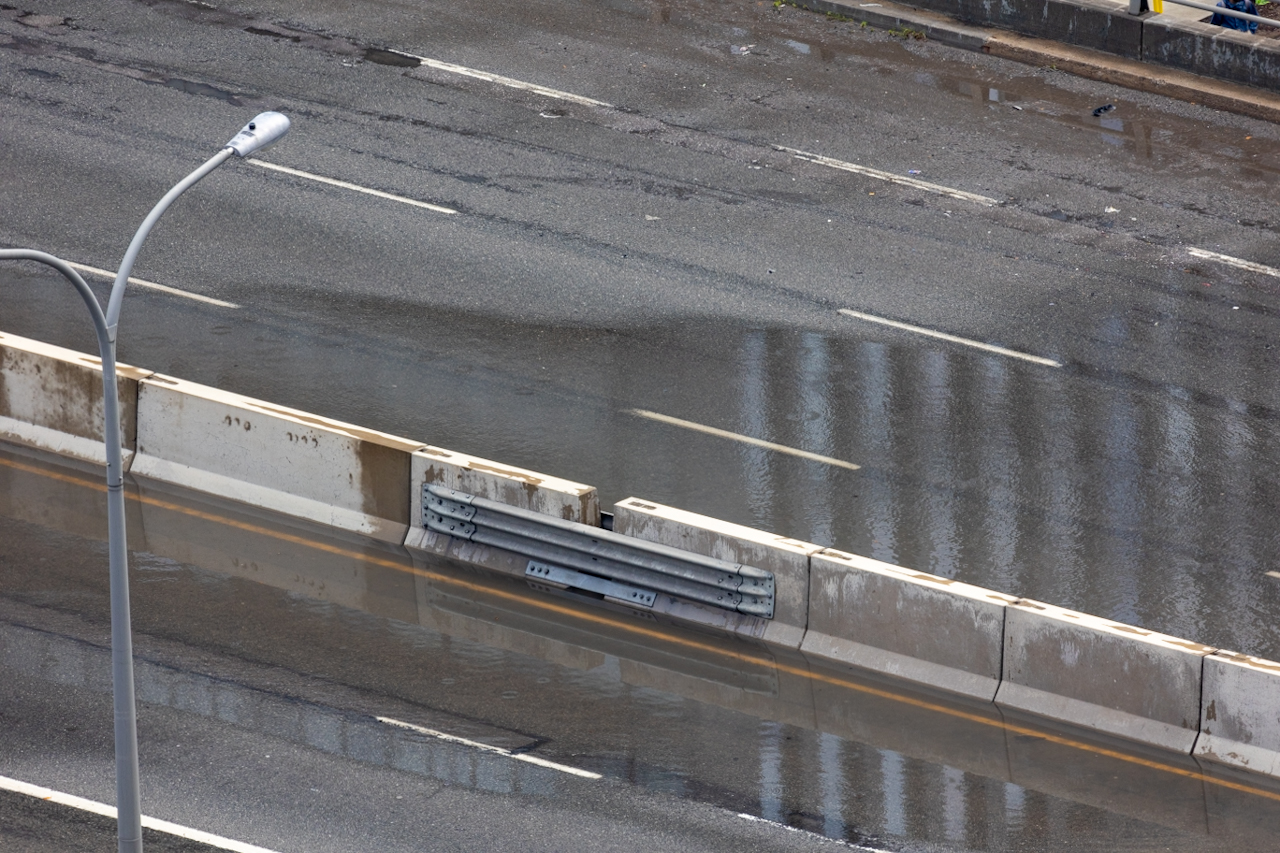

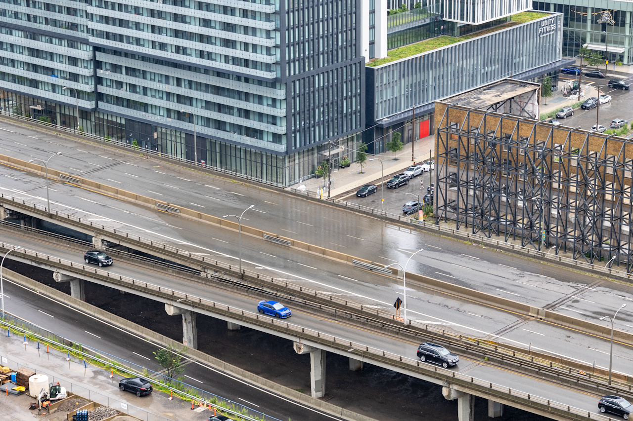

Heavy rain - Gardiner flooding again. 9:30

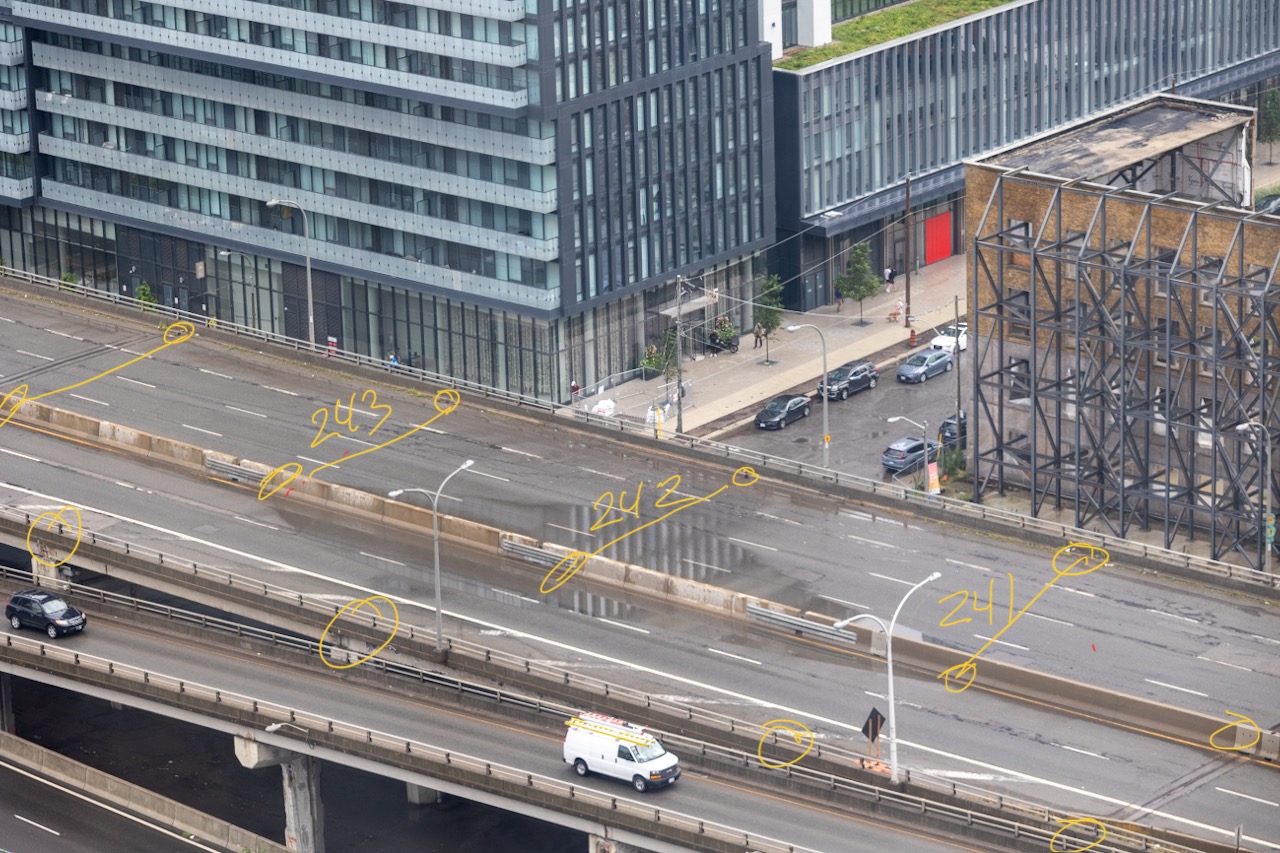

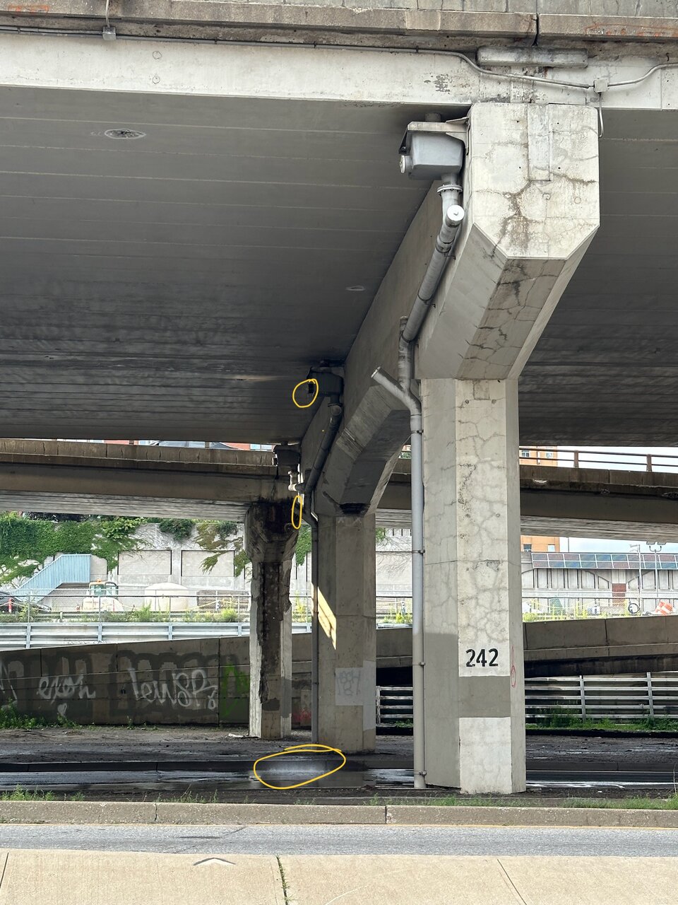

Maybe they need to rethink the drains or slope in this area at Church/Cooper Bent 242 & 243.View attachment 580783

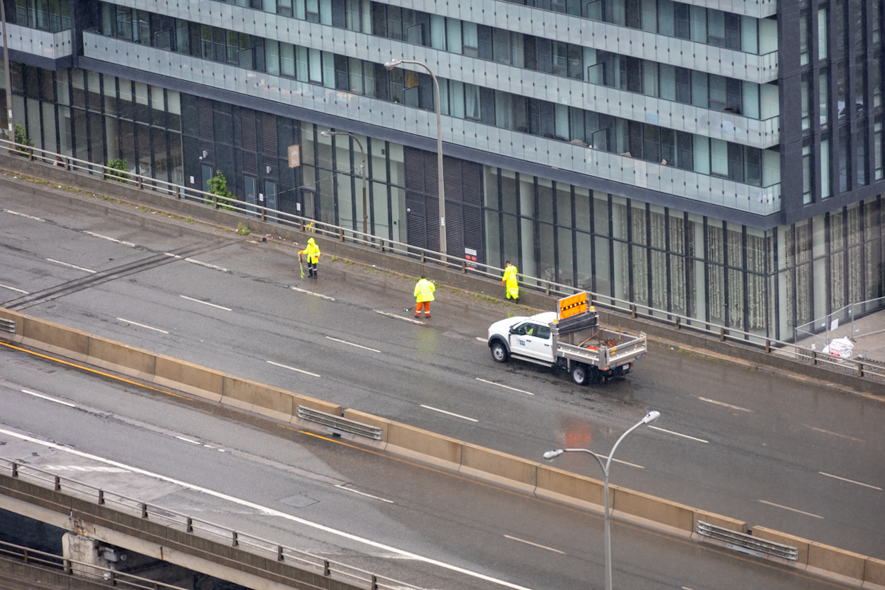

They were cleaning on June 19 after the rain on June 18.

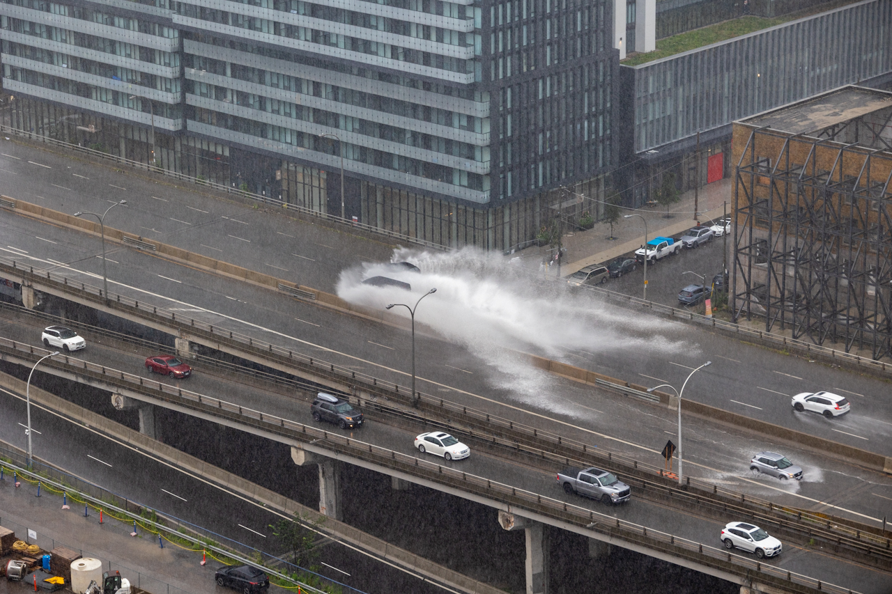

Because this happens 10:13 Ambulance required too. :(

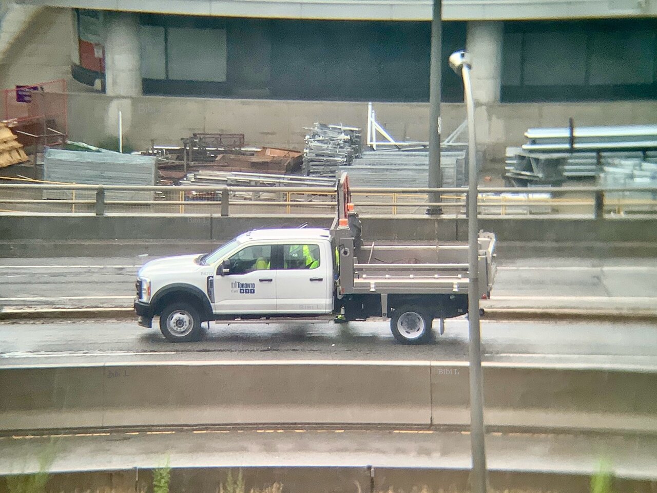

EB “Safety” vehicle - not so safe - while the red lights are still flashing. Maybe testing the water depth and throw?

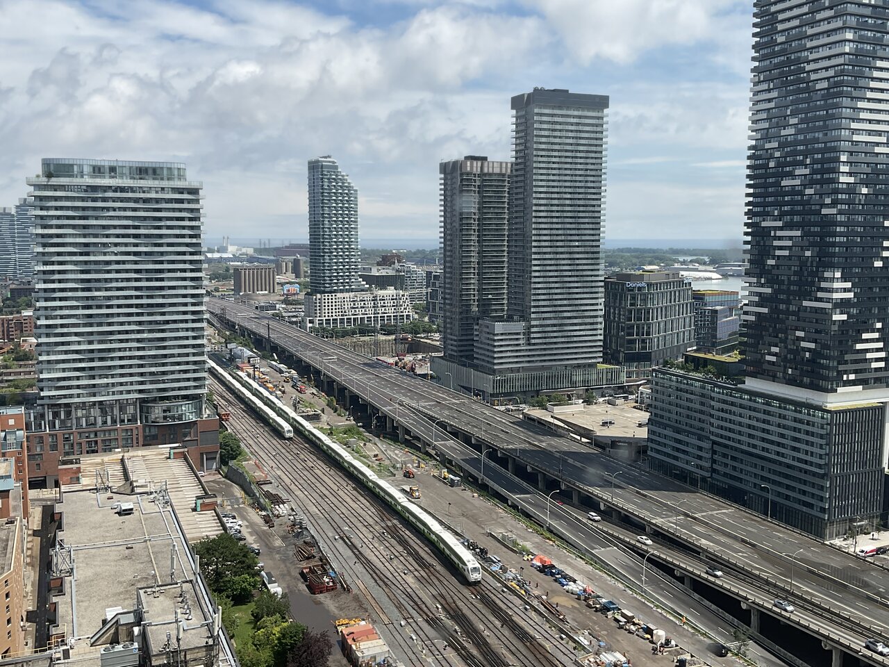

Until the next flash flood 11:30

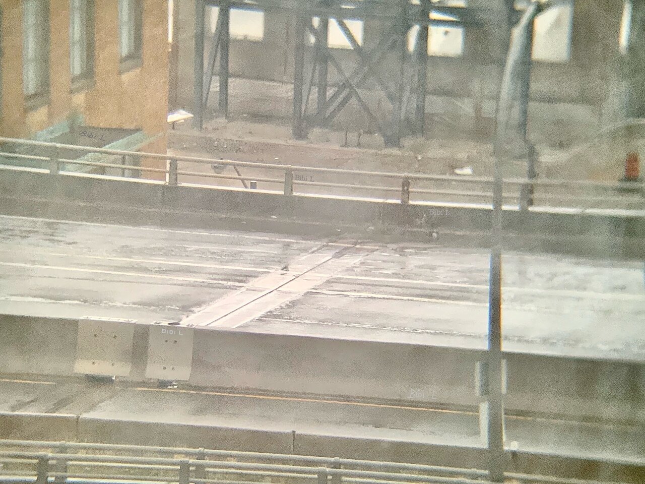

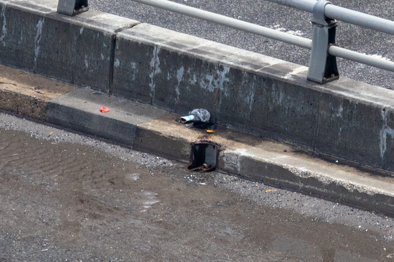

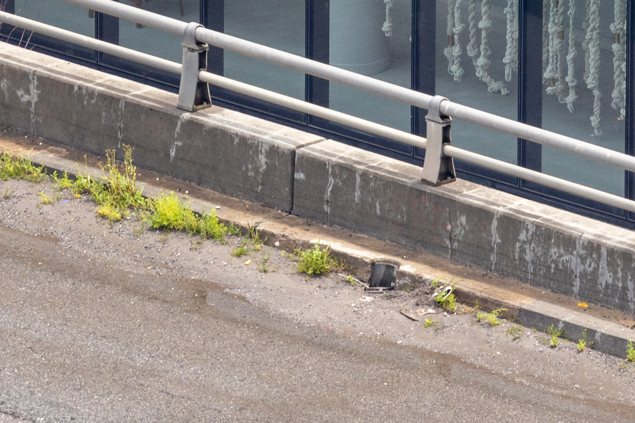

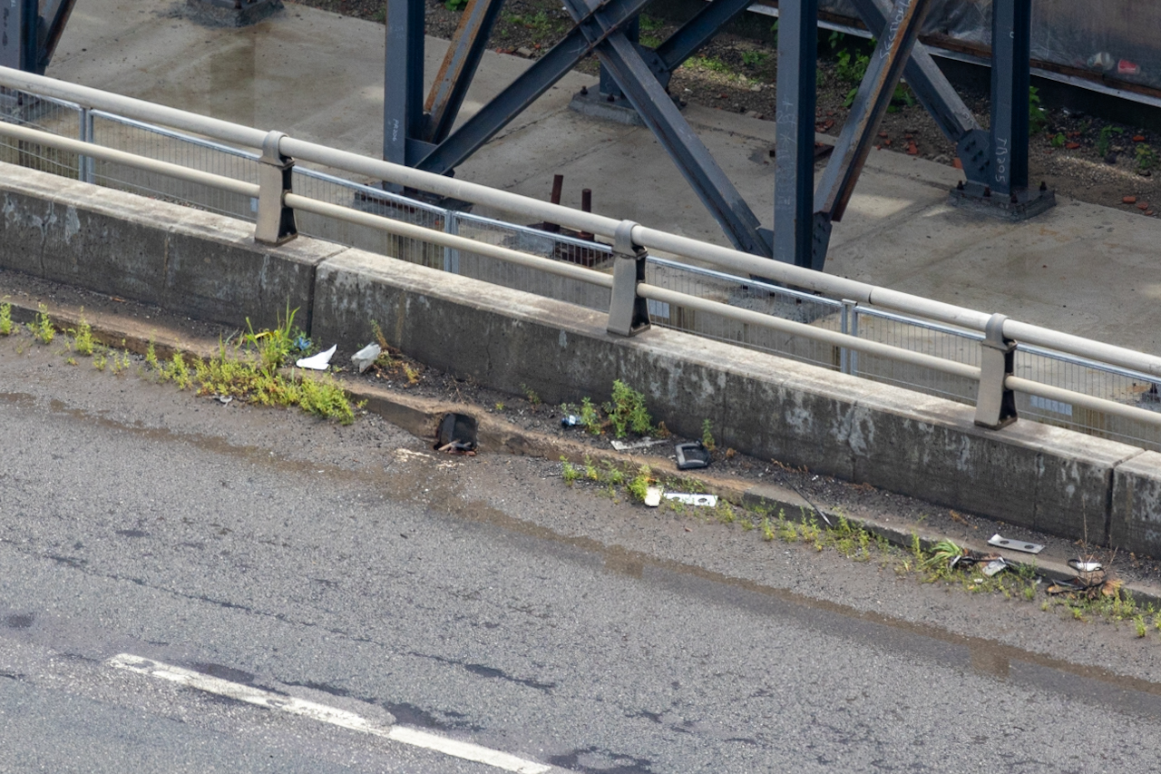

I think the main problem for the flooding is the drain system. The gardiner has these strips that run along the expressway, which directs water that falls into it, to the sides of the gardiner where it leads down to the support columns, where we see the tubes, which lead to the ground. I’ve watched some videos of when they close the expressway for spring cleaning and they usually get rid of a lot of dirt between the strip, because it’s pretty small, as to not make car rides bumpy. I’m thinking those have been clogged with dirt, and aren’t functioning properly. Hopefully they can clean them and get them working fully again? Here is a picture of one.

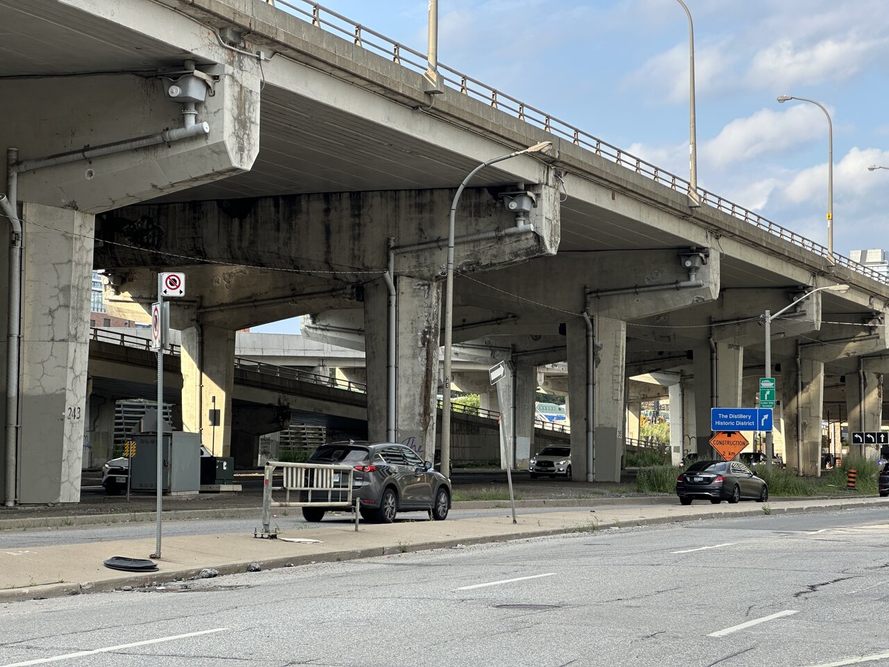

I’ve also always watched those drains under the gardiner, either the white or grey ones, flooding. On the parts of the gardiner that they have completely rebuilt it, they got rid of the big drain things and just replaced it with tubes.

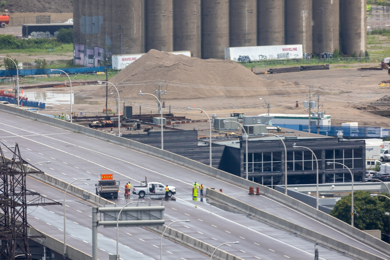

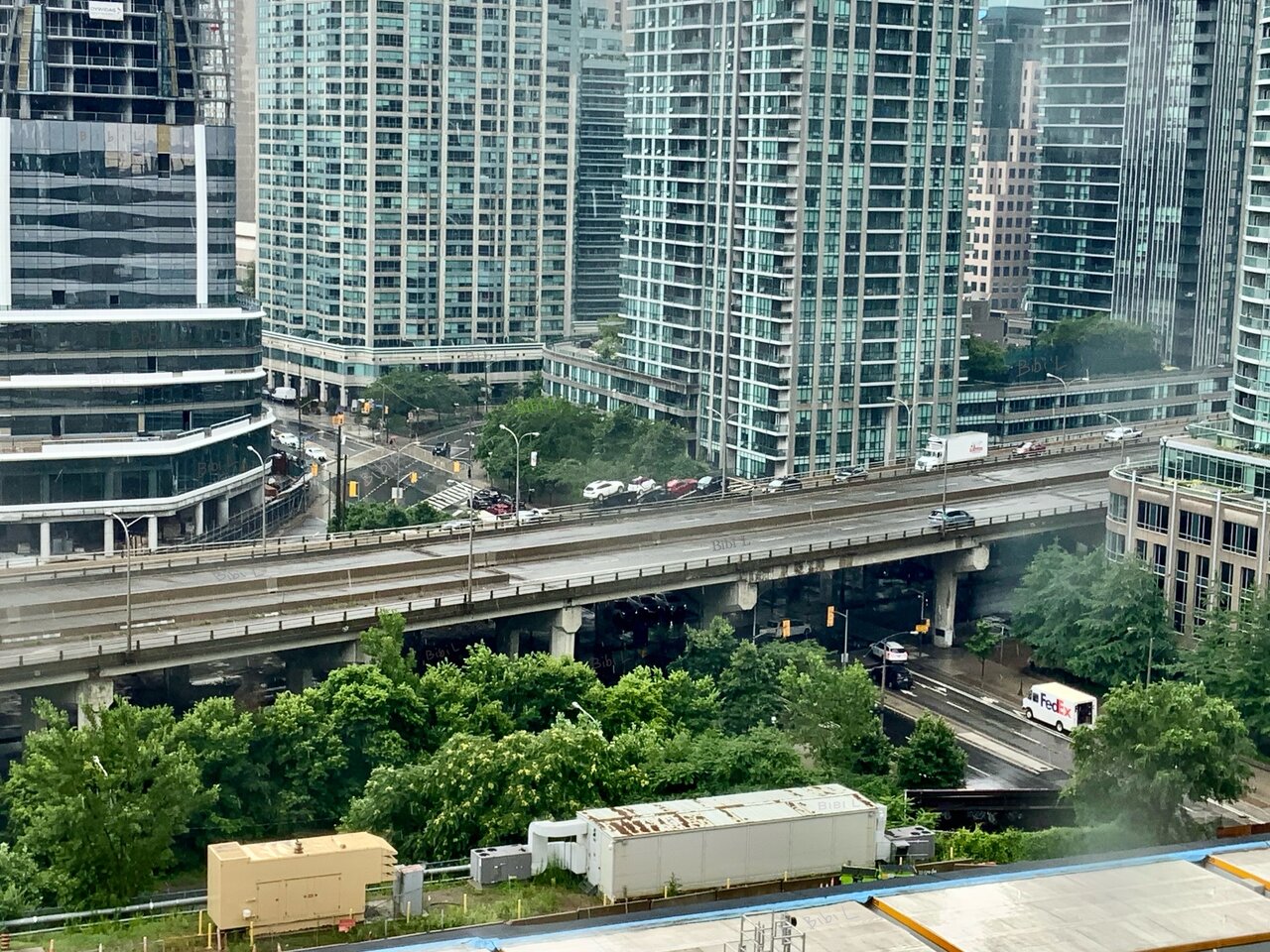

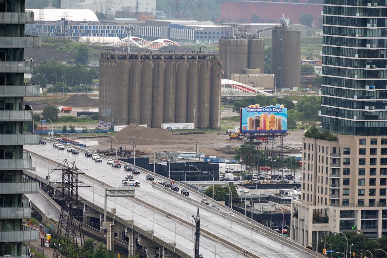

Update, they’ve closed the Gardiner Expressway east of Jarvis St off-ramp. Every vehicle is getting off that ramp, as there are no cars driving east of it. Some work vehicles were seen driving slowly and workers cleaning the drains. There are still some flooded spots.
That’s a lot of water.
No vehicles, just the Jarvis off-ramp. Westbound is still open.

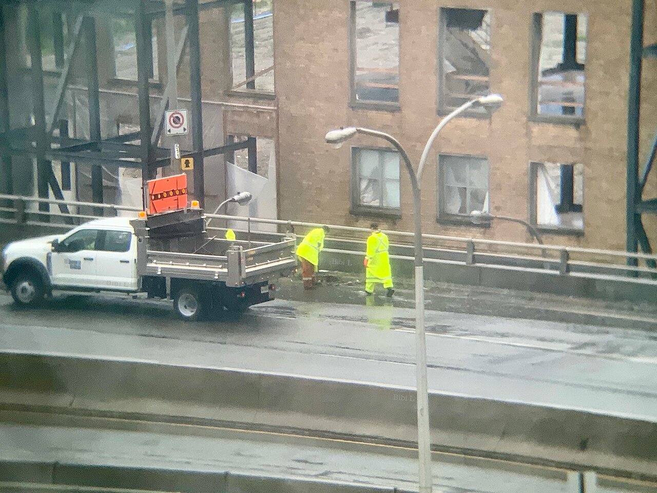

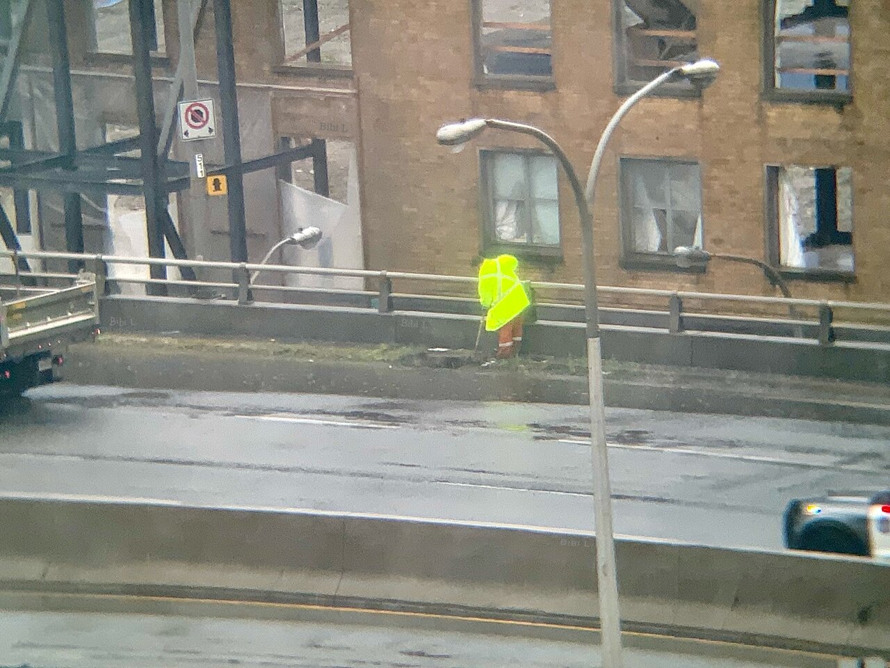

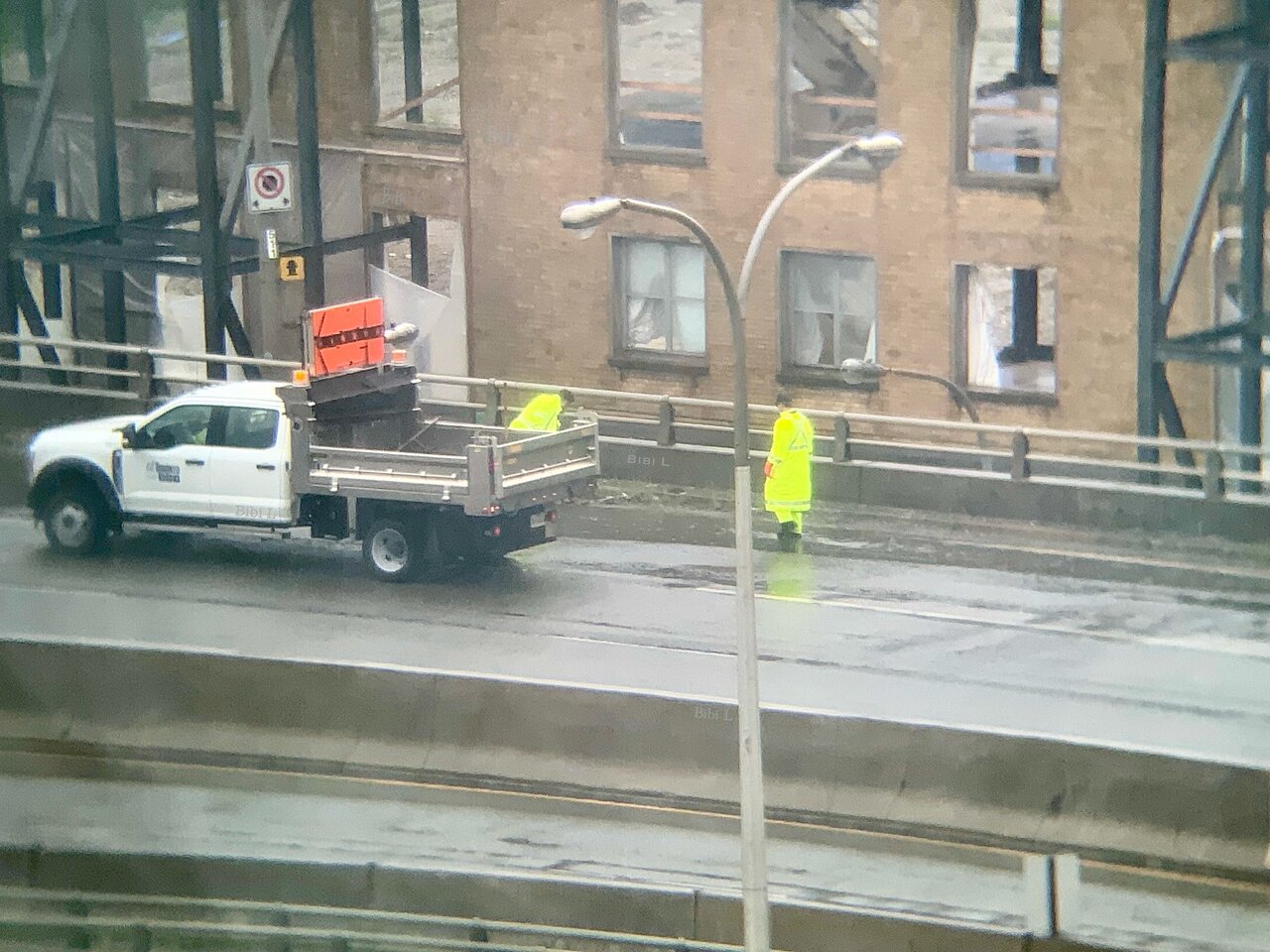

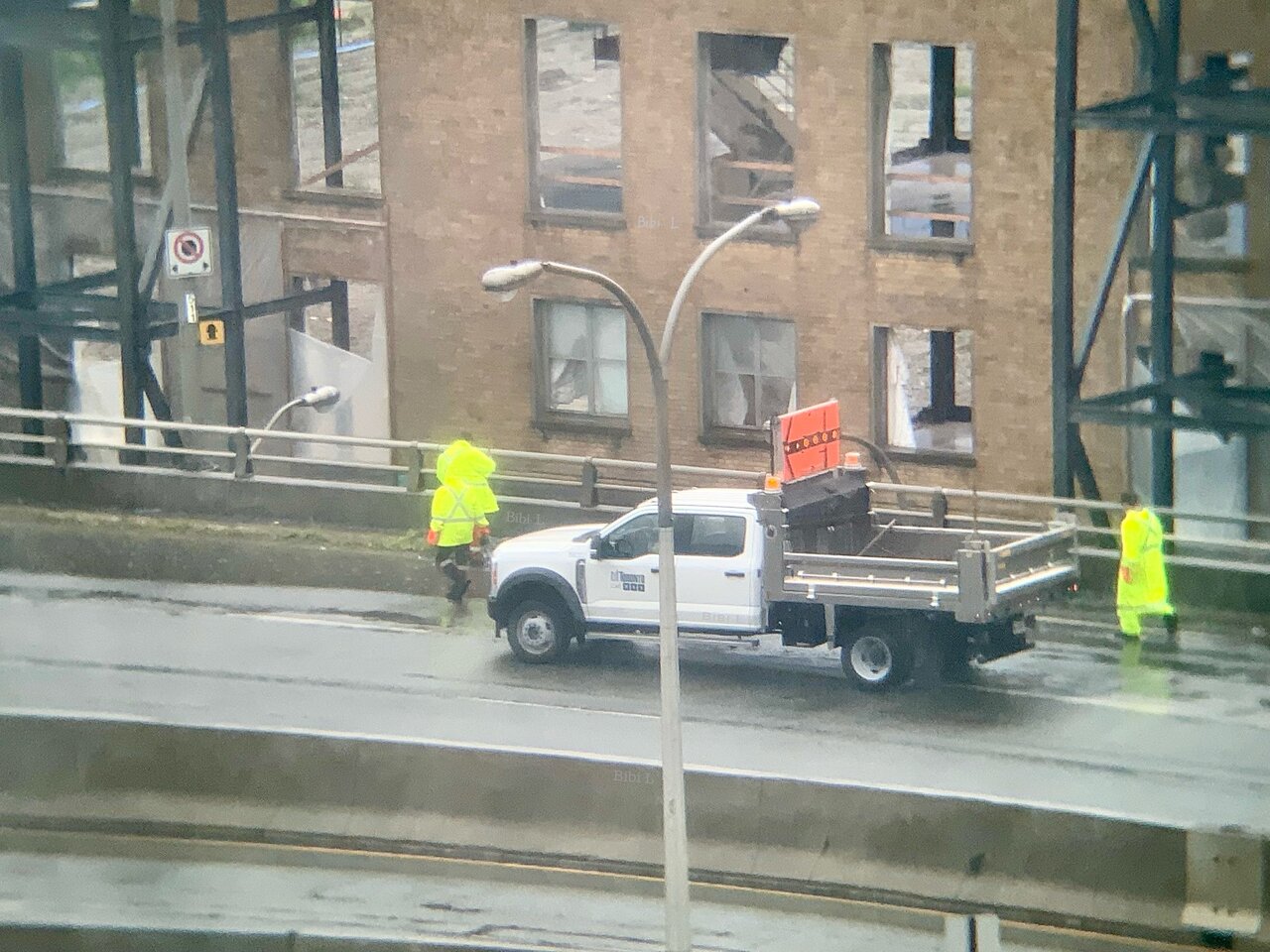

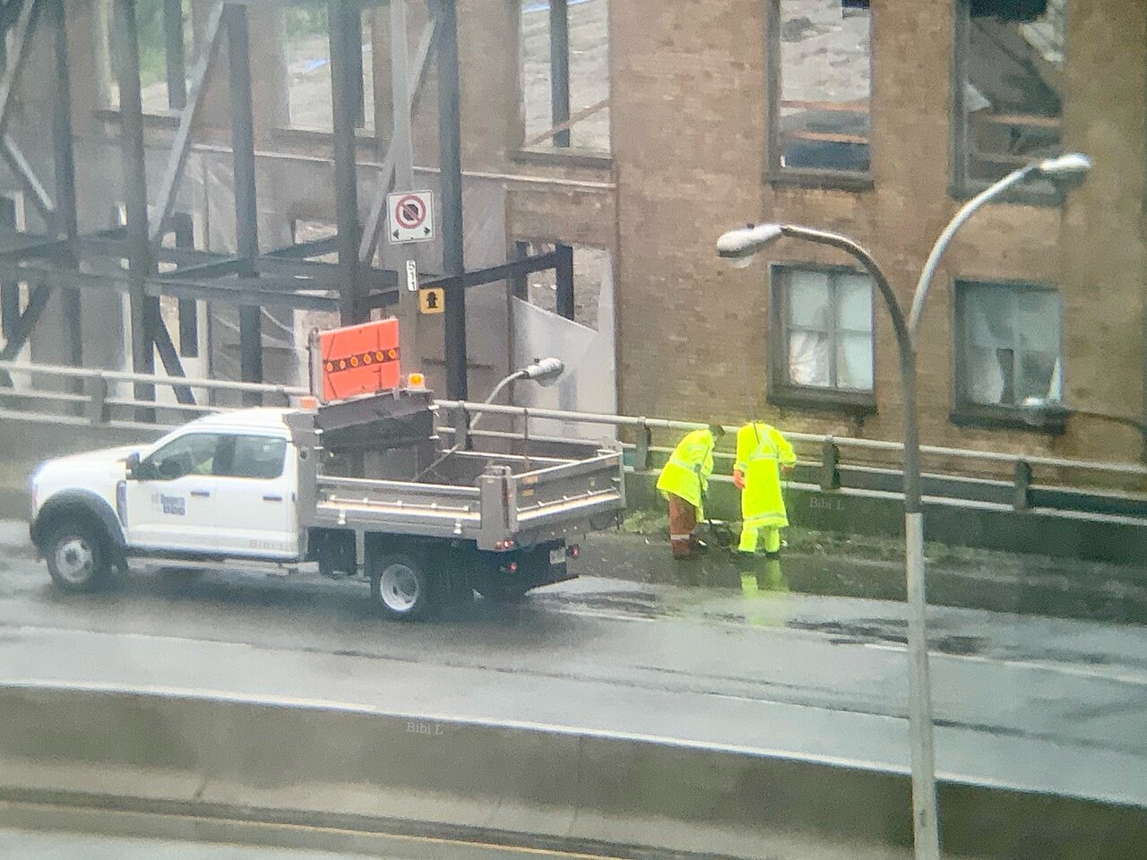

They were definitely plugged again since the clean out on June 19.

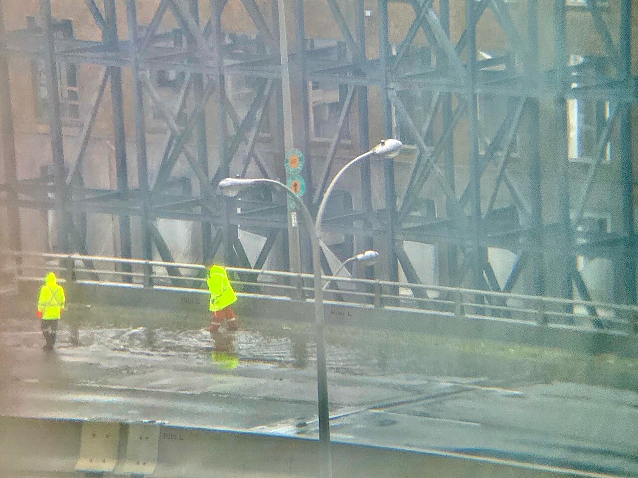

Crew manually cleaning it out now.
Lots of debris on the road that pooled in the area.

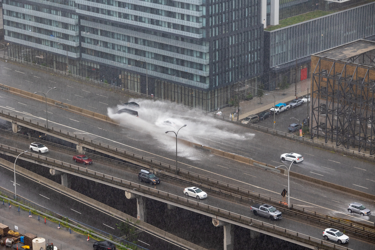

11:41 update
2 cars and 1 in the wake
There was a car hiding in there. Yikes.

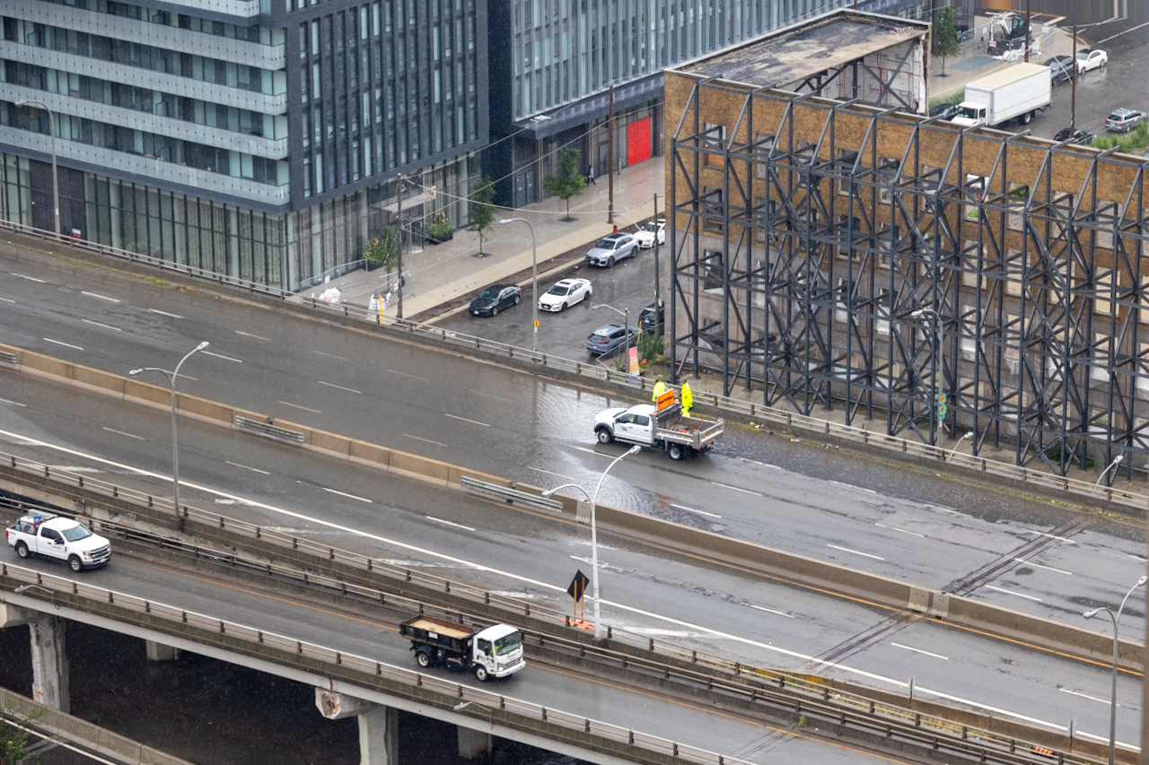

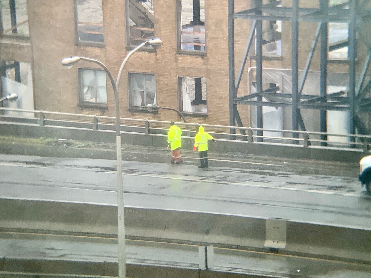

I guess these drains won’t stay clear for too long. Still lots of debris. Until the next heaven rain fall.
Centre drain somewhere in there.
Back to work! The centre drain is still plugged.

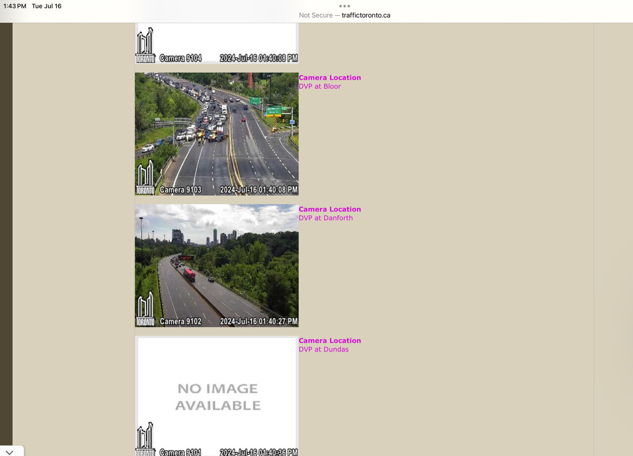

Dundas camera out of service. Water issue or public image?

Those drains definitely need to be rethought… They are tiny!

Thanks for taking all the photos! Every time I drive on lakeshore and the tiniest bit of rain happened I'll see the water over flowing out of the boxes on top of the bents

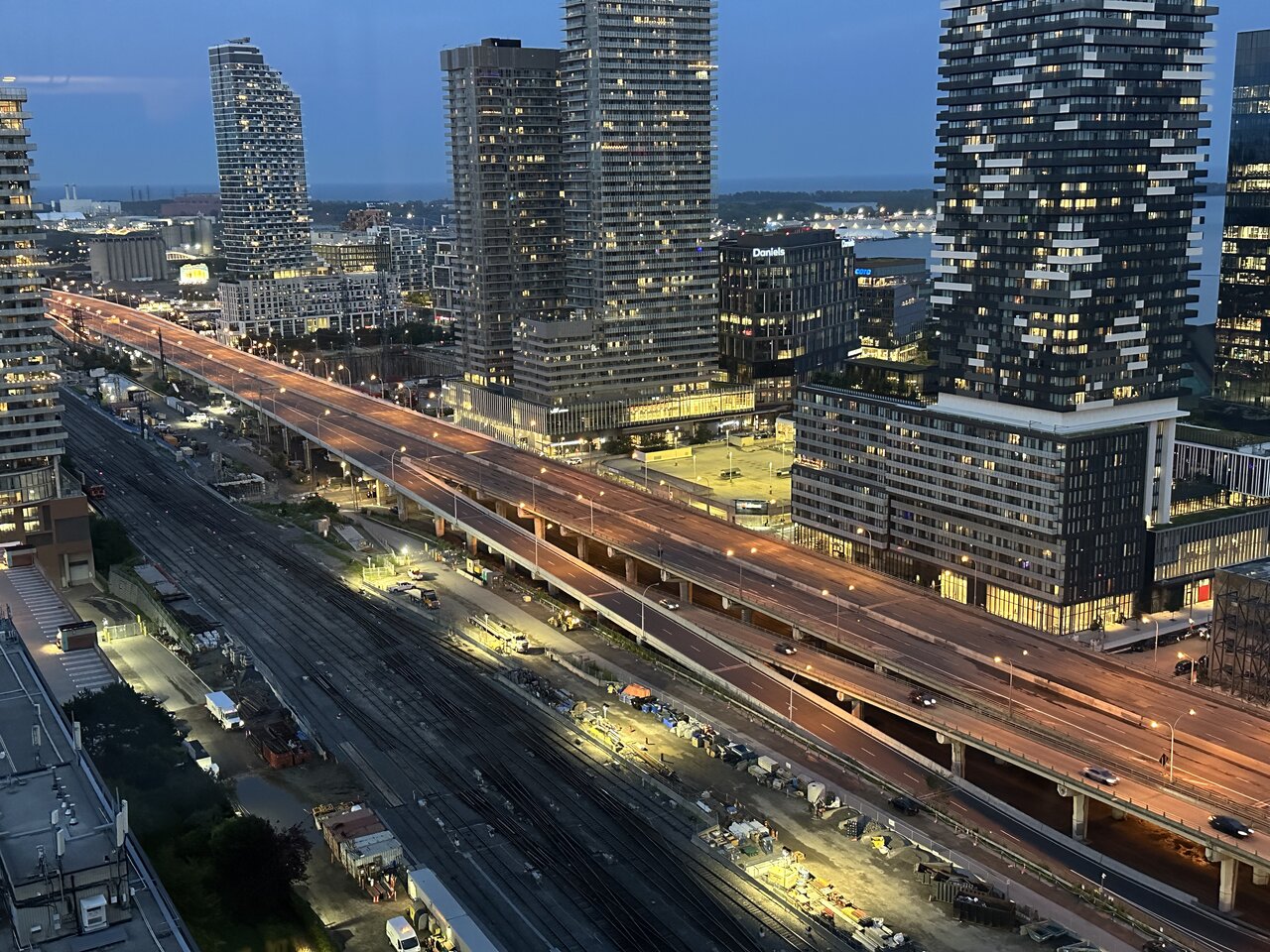

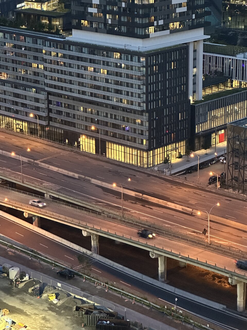

The centre drain on bent 242 is almost clear, 9 hours later. I’ll report back on the next storm I guess. We missed the 7pm storm/wave tonight.
They probably need to go through the drain clean-out which could require a night-time lane closure on Lake Shore.
I’m surprised the drain is still dripping onto the lakeshore 5-6 hours after the rain stopped. I guess the cars would normally vaporize the pond.
9:20pm
6:39pm!!!! Maybe they were working above to clear the back-up.
Not a thing of beauty.

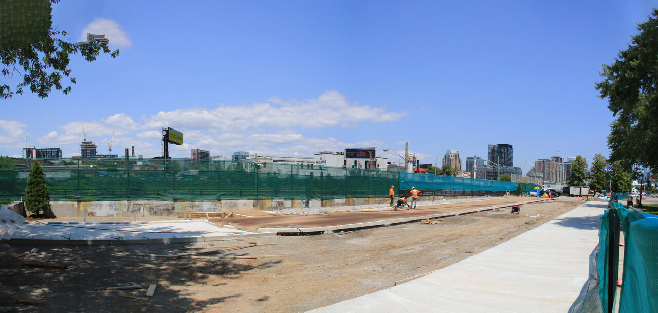

Does anyone know if the work at the west end of the CNE is part of the Gardiner rebuilt or part of TTC ROW with a Platforms or what??? Lots of anchor bolts along that area
I'm not sure what it is but I'm fairly certain it's not part of the Gardiner rebuild as it's several hundred metres from where the work zone starts. We're also at least a couple years away from the streetcar extension so I think it's related to the CNE.
