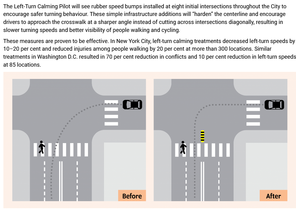

New Left-hand turn treatments are coming to several Toronto intersections:
Taken from:
Locations:

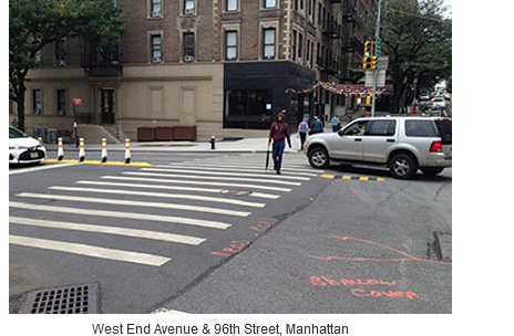

I believe the idea would be very similar to this, from NYC:
Taken from: https://www1.nyc.gov/html/dot/html/pedestrians/turn-calming.shtml
Slowly, slowly we are starting to figure it out. I have no idea why we need to be so cautious. Why not pilot a few all-out intersections in terms of calming and safety features and show that things that work elsewhere also work here, instead of this infuriating incrementalism.
I share your sense of impatience, but we have a city machine that has to crawl before it walks. I can live with starting with ten, the issue is that when we like it and learn from the ten, we should move to a hundred and not just a second set of ten more.
Similarly, other than for exhibition purposes, a “full dressed” intersection approach would likely be pounced on by some Councillors as wasteful, and they would dismiss some of those features as unnecessary. Adding one feature at a time is like adding one juggling item at a time.
