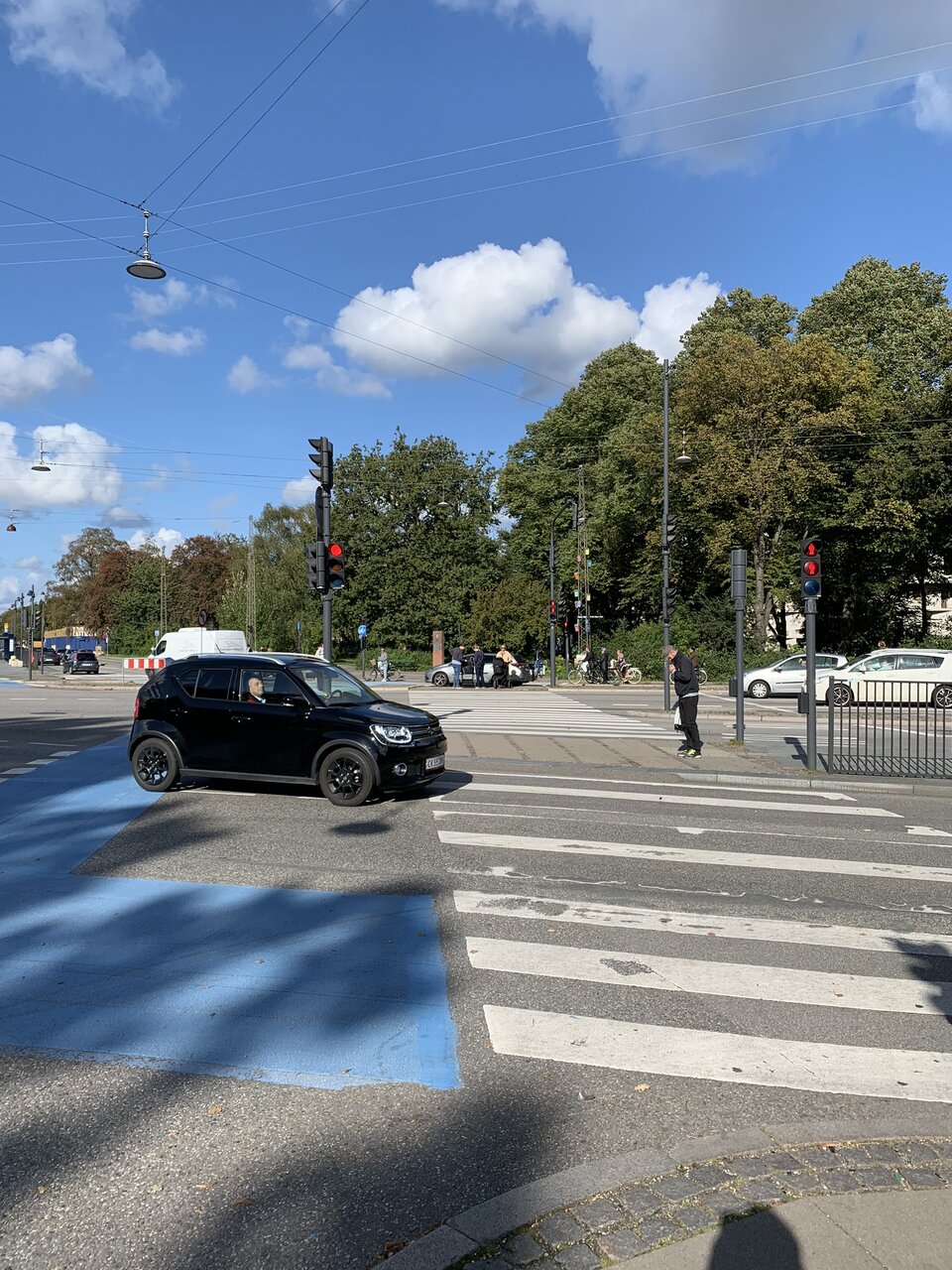

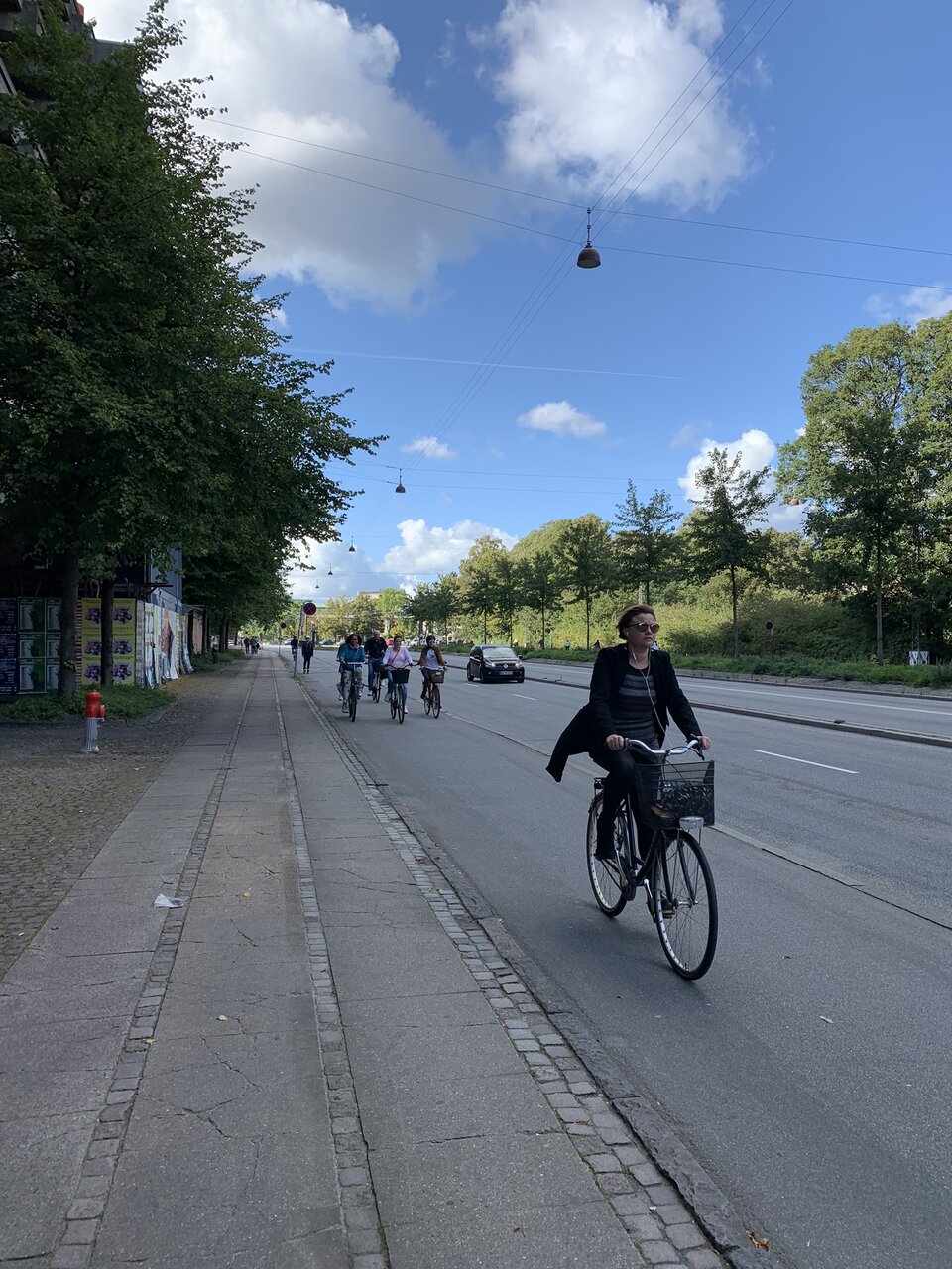

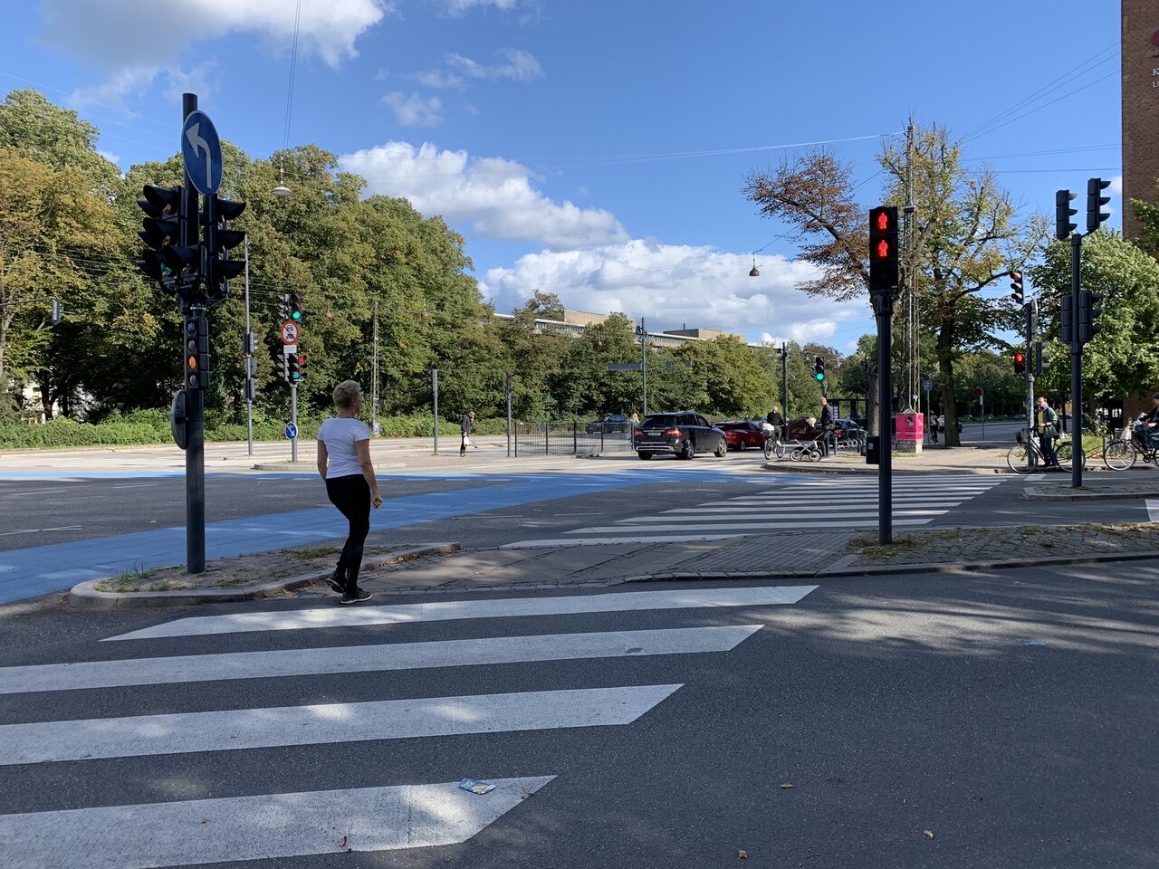

I was in Copenhagen about this time last year and, more than anything with respect to their streetscapes, was struck by how pedestrian- and cyclist-friendly their major suburban arterials are. The ROWs you see in the pics below bear much similarity with many of our 6-lane arterials (reduced in the first case by two lanes for the raised cycle tracks), but they have better VZ infrastructure than most of Toronto's downtown roads -- the cycle tracks; tight curb radii; mid-crossing pedestrian refuges, etc.
You can (and people actually do) cycle all the way to and from the airport to the downtown core entirely on protected cycle tracks, largely on streetscapes that look like those below (once you get off the motorways). It's pretty amazing.
