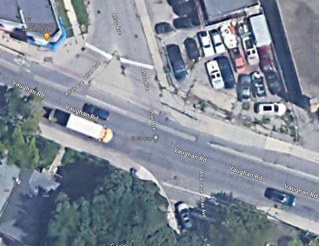

To better discuss this location, let's first look at an aerial pic:
As one can see Atlas is an offset intersection here, where the two parts of Atlas do not neatly align.
This is an important feature to consider, as drivers on Vaughan itself can obstruct the view of drivers on Atlas on the other side, and drivers on Atlas may be aiming to make competing turning movements within the same space. A s/w facing driver on Atlas also blocks the view of the sidewalk to the north, for any driver approaching from the south, and vice versa for the driver going n/w.
Lets additionally note the small channelization feature when approaching Vaughan from the n/e.
This isn't quite the same concept as a 'slip lane' in that Vaughan peculiar angle here makes sightlines difficult, as I noted and affects turning radii as well.
However, by placing the channelized island there, you do offer the possibility of having 3 cars on the n/e section of Atlas at Vaughan. A South/West Bound Atlas to Vaughan NB, a South-West facing Atlas to SB Vaughan, and a North-East Bound turning off Vaughan.
That is a lot of movement complexity.

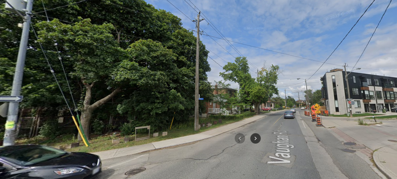

Streeview image from the south side of the intersection, on Vaughan, from July '23:

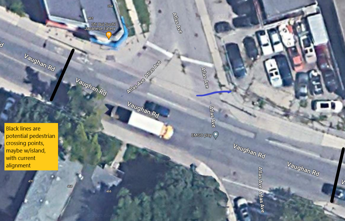

Here's a look at the overhead view with a bit of mark-up by me:
Ignore the blue line above. Note that the black lines would not provide terribly convenient crossing points if one wanted to go from Atlas, to Atlas, particularly from the north.
That's because you can't have the crossing in the middle of the intersection, but respecting the offset makes for a less than ideal set-up.

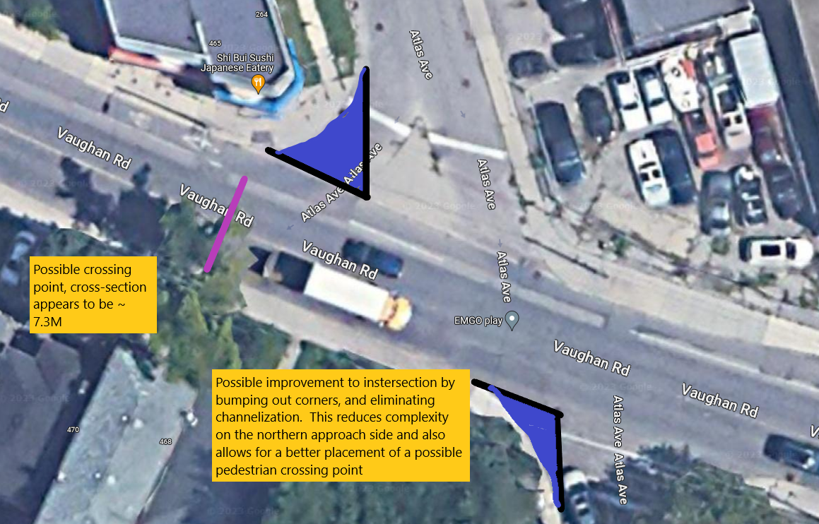

With the preface that I am not a Transportation Planner/Engineer, here's what I think I might be inclined to do:
Vaughan has a bus route, I'm not sure if the TTC would go for reducing lane width below 3.3M.
If that were the case, you might be looking at an island of only 0.7M (about 2ft); that's pretty damned narrow.
If you could shave the lanes to 3M then you can get at least a 1.3M island. But there's no way that would meet an accessibility standard if you smacked railings on it, which is par for the course here.
