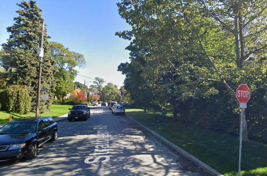

Councillor Matlow has an urgent Member Motion at this Council meeting to stop a new sidewalk from being installed.
The contract, I gather has already been let.
His position seems to be that a sidewalk is fine idea, but not now, in the proposed configuration, because it may impact some mature trees.
I haven't seen the proposed design, and I am certainly one who appreciates mature trees...........
But finding this highly dubious.
First, this request is way late.
Second, the time to consider adjusting a sidewalk location is certainly when the road is being reconstructed; it would be absurd to reconstruct the road and then come back and dig it up move the location of the gutters/drains in order to install a sidewalk.
Motion: http://app.toronto.ca/tmmis/viewAgendaItemHistory.do?item=2022.MM39.25
Road in question:
And
and
I'll wager the proposed new sidewalk is next to the existing curb on the south side.
There are virtually no trees of significance likely to be impacted.
Just using streetview, the most I could see would be two 1/2 way decent specimens, and neither would be an automatic removal.
This looks pretty suspect.
