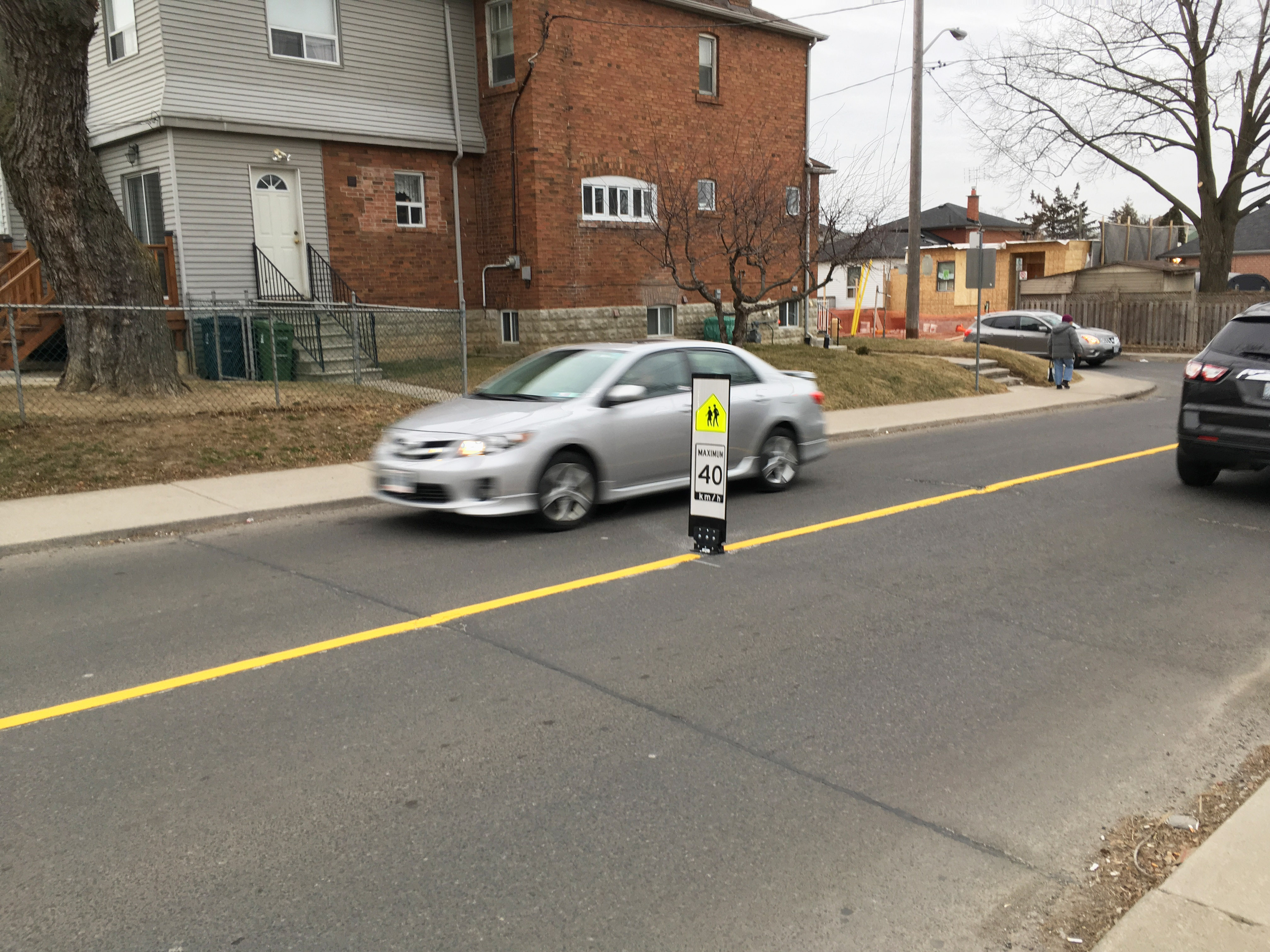

You can narrow lanes with paint, create pinch points with flexi posts. It doesn't have to be expensive. This will actually lower speeds. Having a 30 kph street with 4m lanes is insanity.
Lowering speed limits is completely pointless if the street design is not changed to align with that limit. You can't enforce your way to lower speeds.
