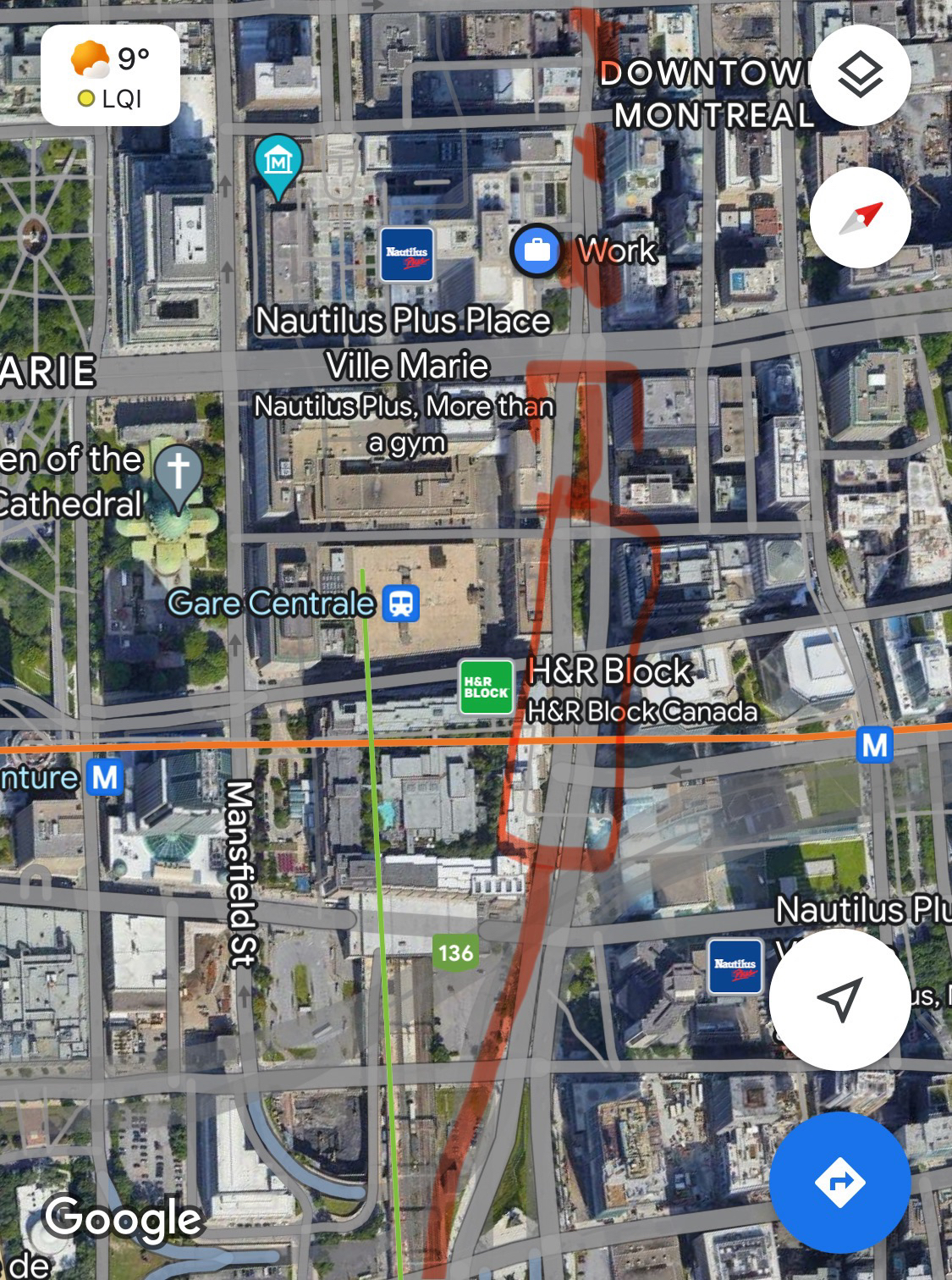

The only way I see a tunnel to be constructable in downtown Montreal is to keep it at the existing track level and to build it underneath Robert-Bourassa, with a station between the intersection with Rene-Levesque (above) and Sainte-Antoine (below):
I've posted this before... But any tunnel idea would benefit in buy-in from EXO commuter trains (to help pay for it) - I wonder if they are thinking of that? - excuse this map has the old LRT de L'est concept. With only one underground station, it perhaps wouldn't cost toooo much?

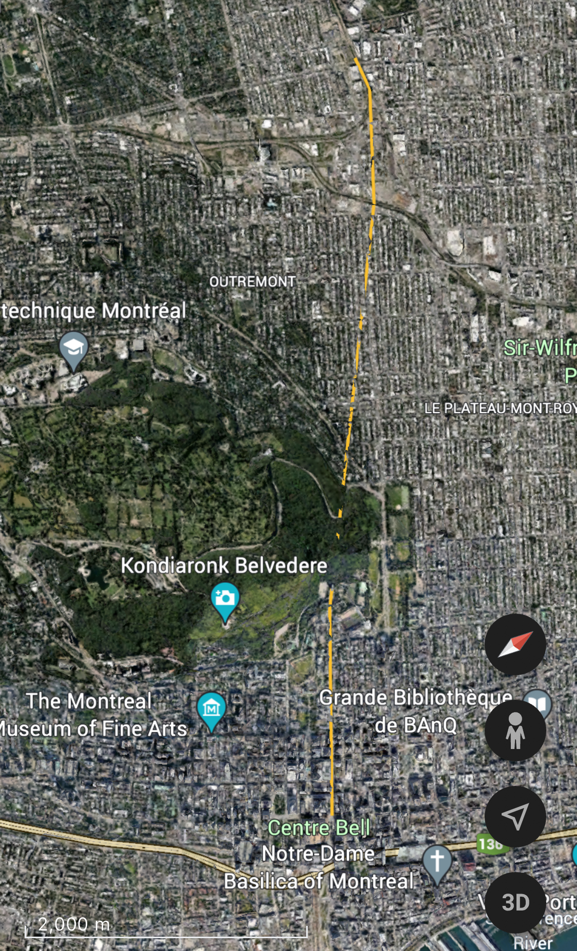

If you zoom into the Montreal area, I laid out where I feel it could go. It is almost a straight line to the tracks it needs to meet north of the Mont.
I hate to disappoint you but there are unfortunately severe vertical alignment issues which would make a tunnel crossing underneath Gare Centrale in West-East direction extremely challenging:
  • The existing passenger concourse at Gare Centrale is above the existing tracks. You would have to build elevators and escalators through the existing platforms, which are rather narrow.
  • You need to avoid the Autoroute Ville-Marie with its various ramps, which reaches more than 40 meters deep.
  • You can only dive up to the CP Westmount Sub once you‘ve cleared all the various road underpasses beneath it (Guy, Georges-Vanier, Atwater, Glen, Sherbrooke, Girouard, Cavendish), some of which (Glen Road) are listed heritage structures and can therefore hardly be altered.
There are unfortunately good reasons why I think that such a tunnel would at least cost $10 billion and take 10 years to build - and its footprint would paralyze the entire downtown for multiple years…
