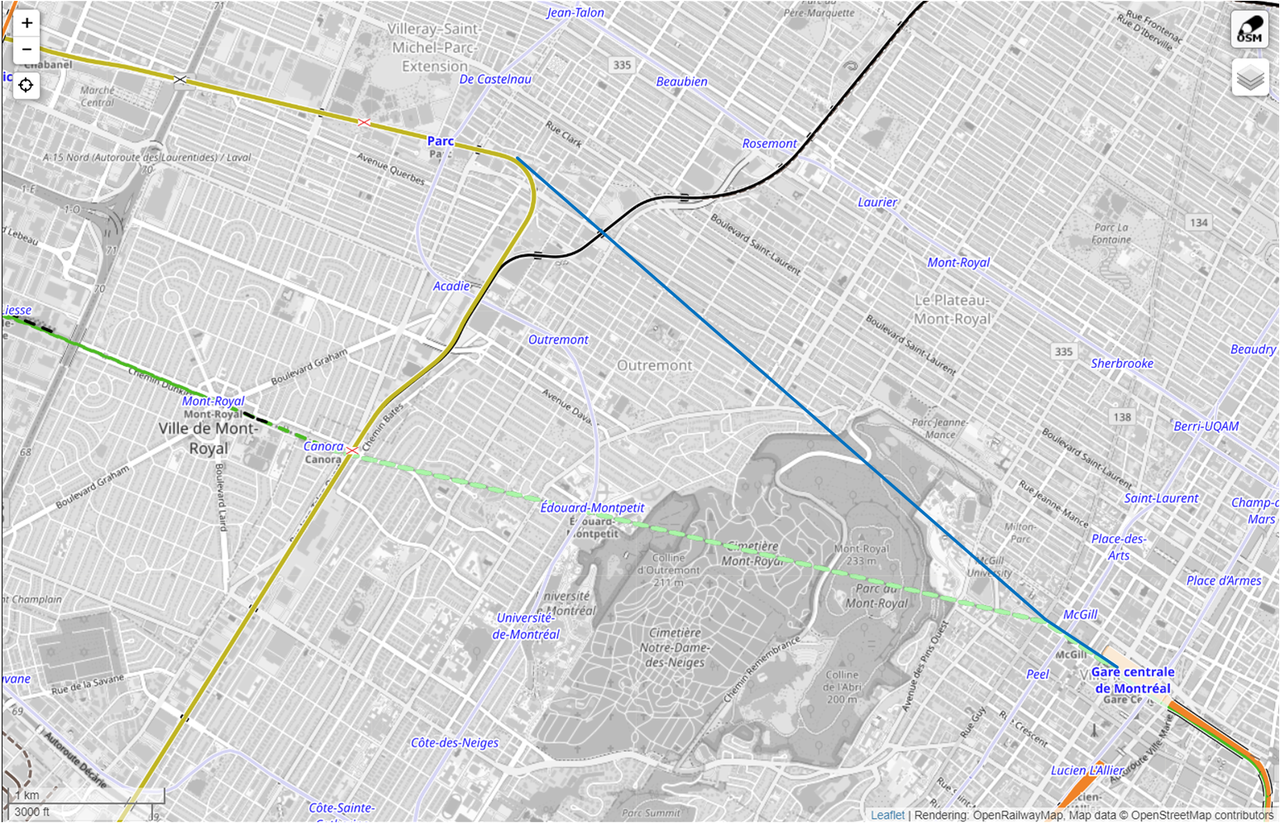

A new tunnel, say, from the Gare Centrale to the Gare Parc, would be a very expensive undertaking, well over a billion and perhaps into plural billions of dollars. It's hard to justify that for the demand for the ~1 million or so persons of Trois-Rivières and Québec.
Entering from the south side as today adds a mere 15km, but today it is limited by having to traverse the Taschereau yard. If it were possible to proceed at a relatively high speed from Sauvé onward the impact would not be quite as bad. Yes, the capacity is limited from having to turn trains from all directions at the Gare Centrale, but there will not be huge volume on Quebec-Montreal.

The tunnel saves a distance of some 15km. That might save some teens of minutes over going around the mountain - not huge for Quebec-Montreal, but fantastic for suburban services that might share it.

I recall seeing that the underground city gets in the way of extending the tracks onward from the central station. Was there any word on that?
That may make all of this a non starter.
The Underground City and the Autoroute Ville-Marie are indeed in the path for almost any alternative tunnel alignment:
The only path I could possibly see would be underneath Robert-Bourassa, but that would imply closing it between Saint-Antoine and René-Levesque:
It might be too late (they should have planned to do it during REM construction), but a better option might be to widen the first 500m of the tunnel (up until it bends further to the west under Sherbrooke St W) for triple or quadruple track, and then continue with a new tunnel in a straight line (or veer further to the north) and have it join up with CPKC's Parc Sub. Widening the existing tunnel should have minimal effect on the underground city, and shouldn't have any issues with the Autoroute Ville-Marie as it is perpendicular to the tunnel. North of Sherbrooke there shouldn't be any conflict with the underground city. See blue line in map below as an approximate route.
There unfortunately is no way past McGill REM station:
