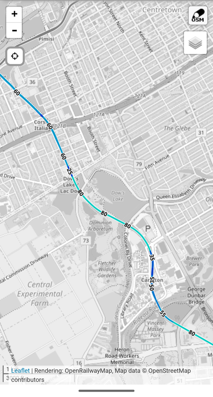

Actually the dwell times are the main cause for the slow times on. Line 2 on that chart @reaperexpress did.
Line 2 track speeds are between 60-70 km/h, with speed buffers around the stations, but this section is also the part with the most single track. And the trains actually move pretty much at those max.speeds. But the dwell times are very long to ensure the trains can pass each other, e.g. trains at Carleton or Corso Italia can't leave until the other train arrives. This causes dwell times in the 90+ second range, far longer than the TTC, which I swear sometimes closes the doors almost immediately after opening them.
I'd describe the long dwell times on Line 2 as a "symptom" rather than a cause. The root cause is really the schedule padding for the single track operations like you describe here.

This is correct. This is more about coordinating trains through sidings and reaching the next station at the correct time. This is especially bad at South Keys where both Line 2 and 4 trains share the same track. This produces delays at Uplands Station and wait times at South Keys for Line 4 of 6 minutes inbound and 9 minutes, much worse than originally promised.
