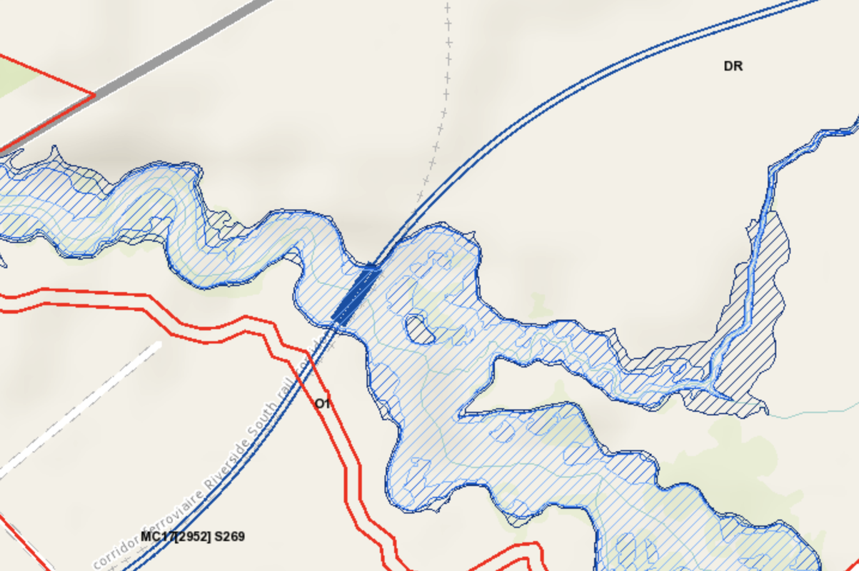

The "tight curve" exists because of the floodplain along Mosquito Creek.
If only there were some way for a railway to cross a floodplain...

Given the expense of building that kind of bridge for minor benefit, it's not worth it. Removing the worst single track choke point at Walkley would be a far more useful use of that kind of money. And the curve really isn't that tight, it's nowhere near the kind of curves line 1 crawls through.
You obviously don't need to build a huge viaduct for that tiny creek. You just need to make the bridge a bit longer (10%?) so it can cross the creek at an angle instead of making two 60 km/h curves to cross at 90 degrees.

It would be quite a bit longer to avoid the flood plain. I mean sure, straighter would be nice, but of all the things where I would put money into Line 2 improvements, that's way down at the bottom of the list as a nice-to-have. There's way better bang for buck improvements elsewhere. Straightening it there would probably shave off all of a minute in travel time at best

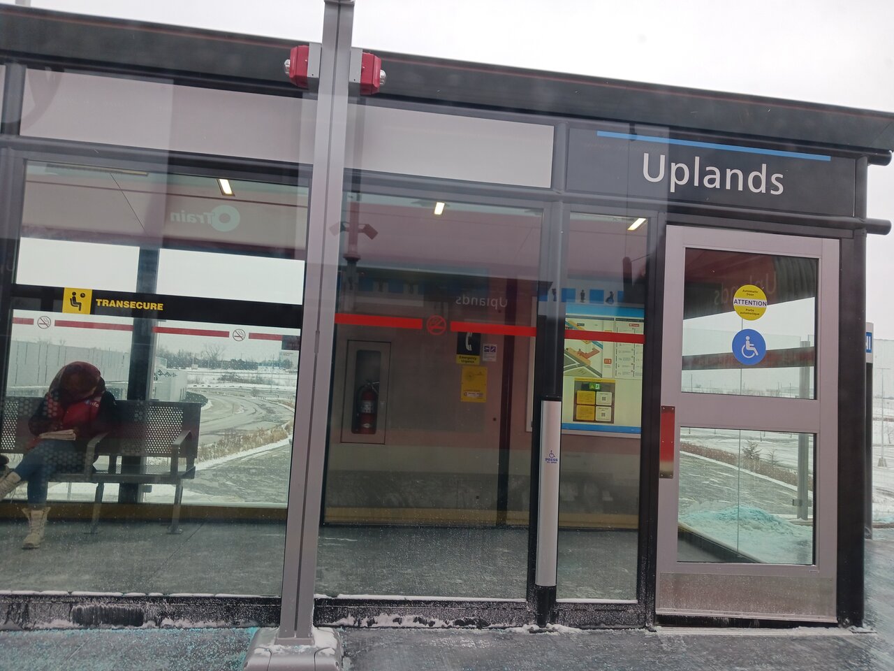

Is that like the glass greenhouses that they like to put at GO stations, with no A/C and only limited heat? I've stood at the new Milliken station and at some times of day, you either sunburn on the platform, die of heat death in the shelter or the top of the stairs. Or go hide in the tunnel to get some shade, but can't see the train.
Every station has at least one enclosed shelter with an on-demand heater, and from my testing on Monday it seems to work really well. 12m wait times means you can generally make good use of it.
I was hoping we wouldn't start up with the "tight curves" thing again. The curves approaching Limebank are in the environs of 1500 feet, and the tightest one in the system is approaching Bowesville, around 1000. You don't even really notice the curve to the airport branch. I don't think they are a significant factor at all.
I did trundle into the slightly heated shelter at South Keys for a couple of minutes. It's better than nothing, though not ideal. While the wait for the train is 7 minutes, the connecting train came after about 4 so you could wait on board.

The South Keys shelter, despite being part of the structure, is not very warm at all. Surprisingly, the little standalone shelters at the other stations are far warmer .
