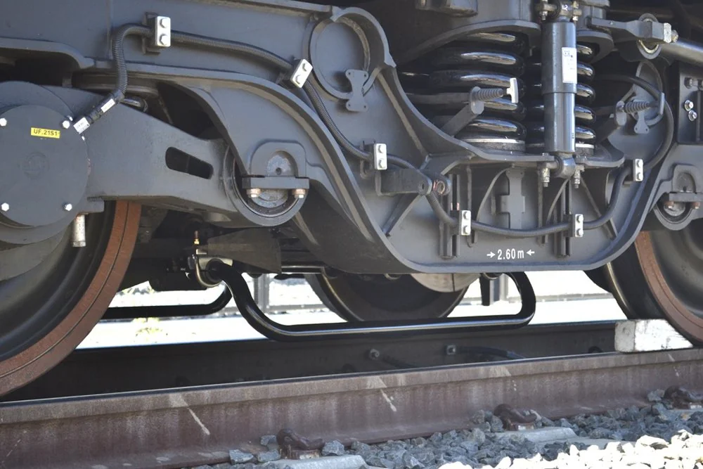

It's patently obvious when you look at the rolling stock. The Shunt Enhancers work by having large antennas that need to be located parallel to and just above the railhead in between the axles of the trucks on the loco and cab car. They can only be placed about 4 to 6 inches above the railhead - which is part of the reason why there is all sorts of certification required to allow them to be used. (The fact that they act on existing signal equipment is also a good reason for requiring additional testing and certification.)
None of the ONR equipment thus far built or delivered has anything located in those areas.

Never seen them before, but shunt enhancers look weird/cool!
