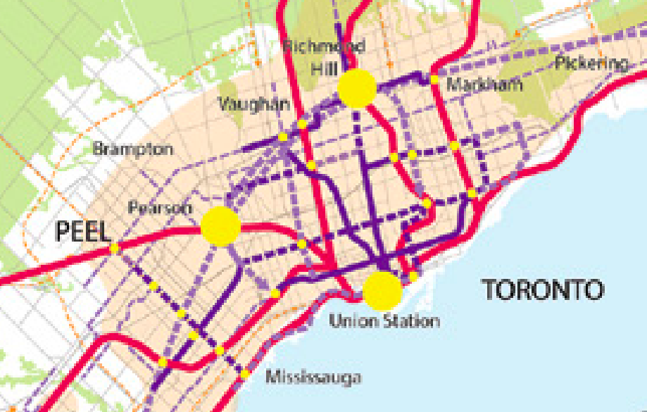

It seems like they want to route the Ontario Line north to Sheppard, then Richmond Hill Centre, then head west to Pearson Airport
This is a terrible map to put out to the public.
None of the lines have names or numbers, no major street names or reference points. Ugh. Communication 101, know your audience, speak with clarity.
I see the proposed O/L loop, except for how it connects back in at the south. Its not a loop if you don't close the circle.
So immediately this does raise some questions. Now as Northern Light pointed out, this is visual clutter, I cannot tell what they're trying to point to me here. This is partially important as when I first saw this image I thought the loop line would travel along Jane but ye it seems that they're pushing for the line to go to Pearson and then go back south and connect to Union... somehow. This of course then raises some questions about what that line on Jane is (since I doubt they're going to build an LRT there). The next big question then is what is that giant dotted line that casually crosses northern Toronto. I'd assume its the
  • Exploring a new east-west, cross-regional connection between Burlington and Oshawa that connects existing GO Rail lines outside of Union Station.
thing that they mentioned in the document, but I always thought that this would be done via the 407 Transitway? This just looks like they drew a dotted line that just casually crashed through Mississauga, Richmond Hill, and Pickering.
On that note the entire 407 Transitway is completely missing, despite the fact that it still shows up in recent Metrolinx Documents and some EAs were still approved (I get that the central section lapsed, but somehow I have the feeling that the 407 Transitway between Jane and Leslie has been cut). As a whole its omission is quite concerning.

Is there really enough demand for metro line capacity between Pearson and RHC? And it would be great fodder for the fantasy map thread to know more about how the 407 Transitway, Pearson-RHC OL and non-Union GO line mesh with each other.

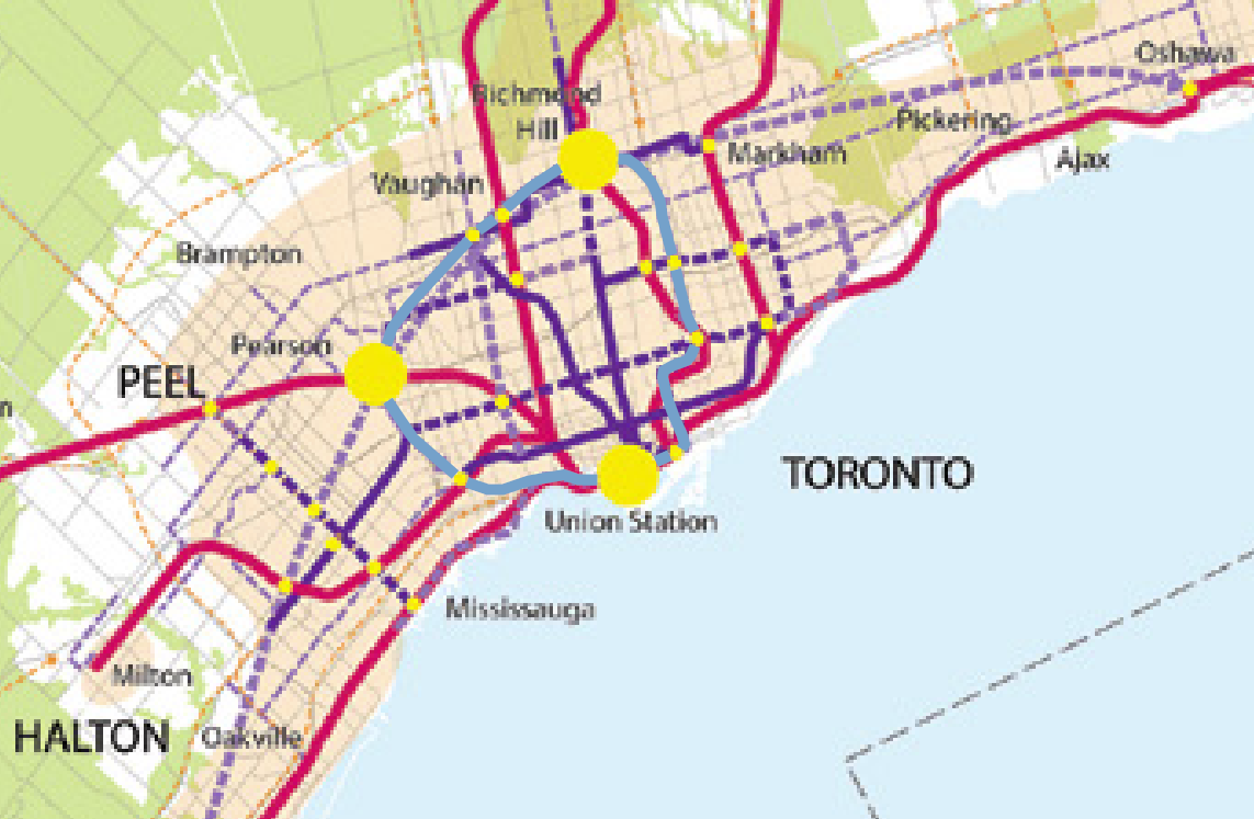

I think the loop is this:
I can see the idea; though that's not what they drew, of course.......
But, if that's true, as with much of that map, there are some serious questions about the 'how' even at the highest conceptual level.
There is no ROW available (rail, road or hydro) following that alignment.
You could, arguably, follow the rail ROW to Obico and use that go north to Kipling.
Then follow the Kipling Hydro Corridor to Eglinton, then shift there to hit the airport.
Bit awkward, ends up serving some odd locales en route and missing others.
But the alternative is deep tunneling.
If many of us here feel one of two potential 'Achilles heels' for the Ontario Line is capacity...........
How could one conceive of building the station sizes and train capacities they have and then build this route?
Very odd.
