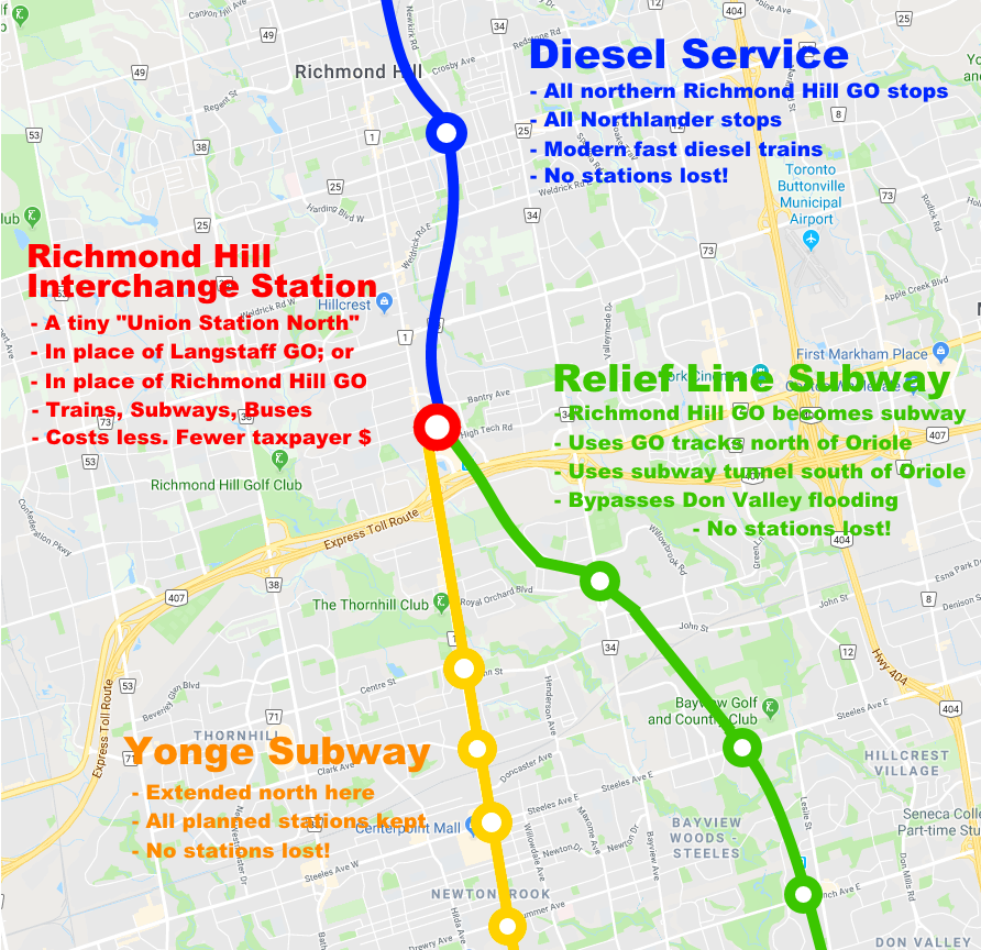

There's also the potential theoretical concept of interlining DRL with Richmond Hill RER. (Meaning DRL becomes the RH RER)
Option #2 and #3 permits this potential concept:
Which would make this or this possible -- the interlining of DRL to Richmond Hill RER.
An interchange station at Langstaff GO that connects 407 Transitway and two subways (Yonge North extension + Relief Line meeting at Langstaff GO or Richmond Hill).
Depending on corridorwidth south of Langstaff, there could be a parallel track left to allow Northlander / expresses / other trains to reach Union.
But the concept of merging DRL + RHRER is actually one of the possibilities suggested (and may be attractive to the current provincial administration and/or Superlinx)
Pretty sure something along these lines has been the last twenty pages of discussion. But if relating this to the 2008-era RH GO Express proposal, wonder if there could be benefit for a 3-track RL. So two tracks with all-stop no different than every TO subway project since 1954; third track allowing station bypass. Why 3-track and not 4? Obviously majority are core-bound in AM, and outbound in PM, so basically the 3rd/Express track would be bidirectional depending on time of day. If in a deep tunnel setup probably two tracks above and the single track below, or vice versa.

How do you get all those trains to their starting point? With only 3 tracks, you do not have the space to have enough trains express and local.
