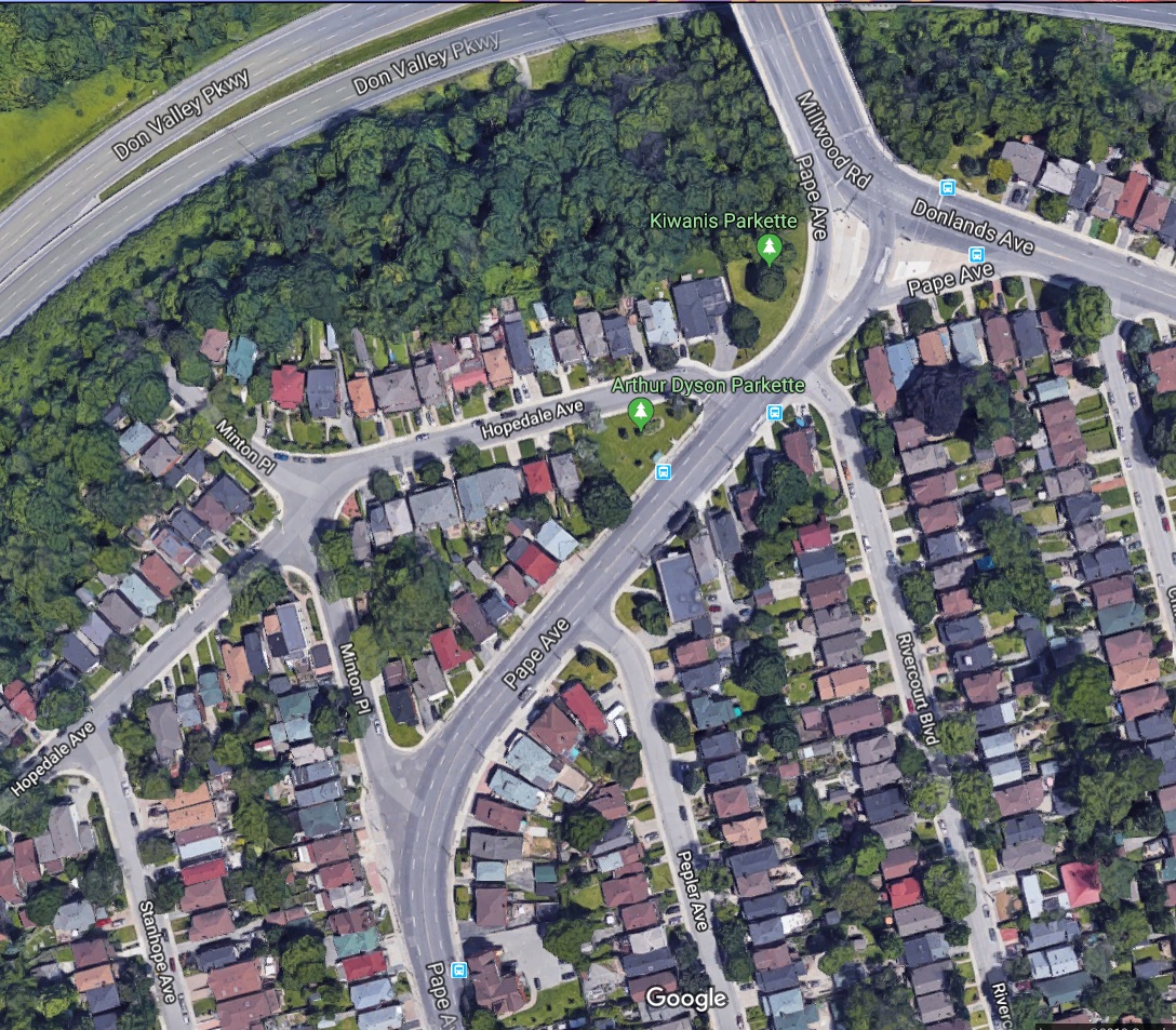

I can see the TBM's tunneling under Pape Avenue, even after the curve, up to Kiwanis Parkette. There could be a bridge to the west of Millwood Road.

With only a parking lot, they can dig a curve from the bridge to under a new TBM site in the parking lot. Continuing under Overlea Blvd.
What TBMs? The design is already mostly finalized from Danforth to north of Mortimer as cut-and-cover for some storage tracks for Relief Line South. I don't think they are going to bother launching TBMS to drill 800 metres from Westwood to just north of O'Connor.
That'll mean cut-and-cover along the north section of Pape Avenue to the side of the Don River Valley, just like what was done with the original Yonge Subway.
Diverting the the traffic as they dig down.
Using temporary beams to carry traffic. No heavy trucks please.
From link. Missing would be all the 3+ story buildings along Pape Avenue.
