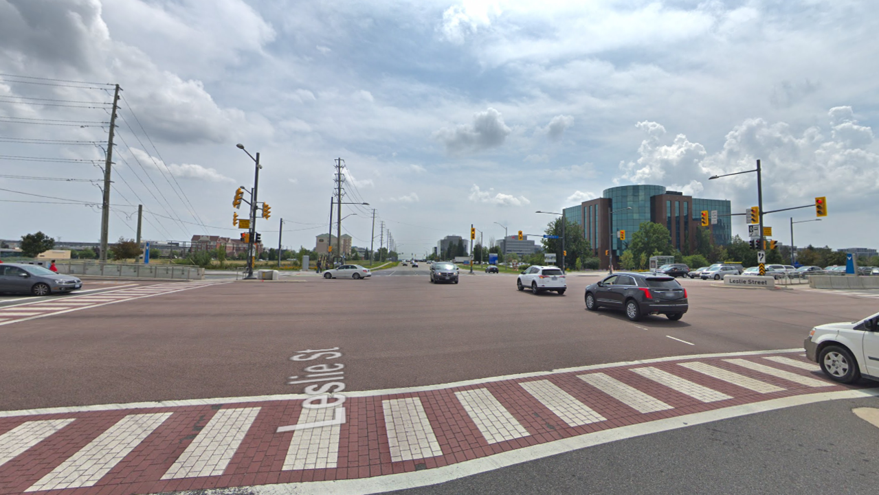

You're right. It makes no sense to send subways to this planned mobility hub here:
Tunnelling for 4km north of Steeles to reach here would be much better:

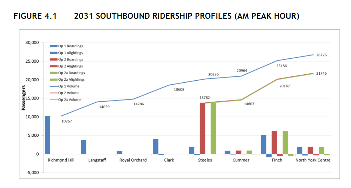

So we are building a relief line to provide relief to the Yonge Line, and it is neither smart nor optimal to consider the possibility of providing relief from the largest contributor of congestion on the Yonge line, which is ridership originating from the north?
