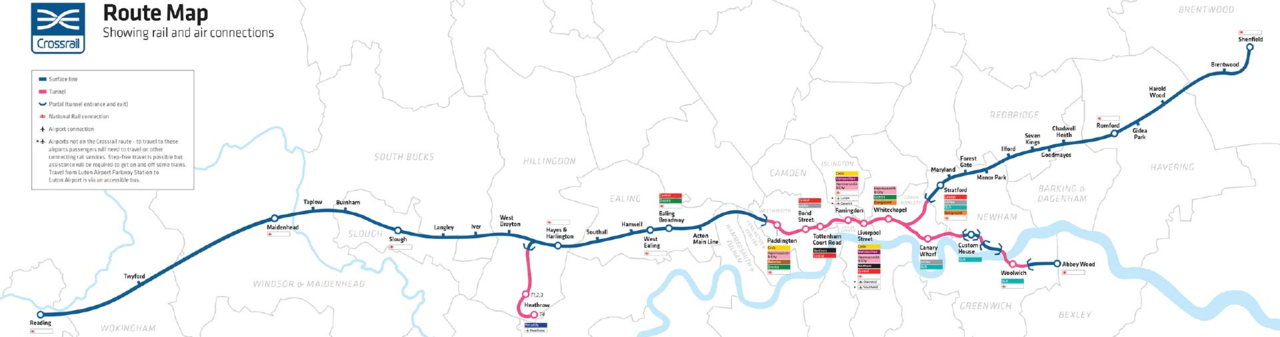

3. London Crossrail
Crossrail, which is expected to open in late 2018, unites a set of four radial branch lines into a new east‐west line through the center of Greater London. The new route will dramatically speed and simplify travel across London and connect to both the London Underground and Overground networks. The opportunity to access far more of the region has sparked intensive development around some of the planned stations, including in Canary Wharf and the London Docklands. Even with a maximum capacity of more than 70,000 passengers per hour, Crossrail is expected to be at capacity from the moment it opens.
Crossrail will connect currently separated parts of Greater London and improve transit through the City’s core. Image Credit: Crossrail Ltd. (Both pics)

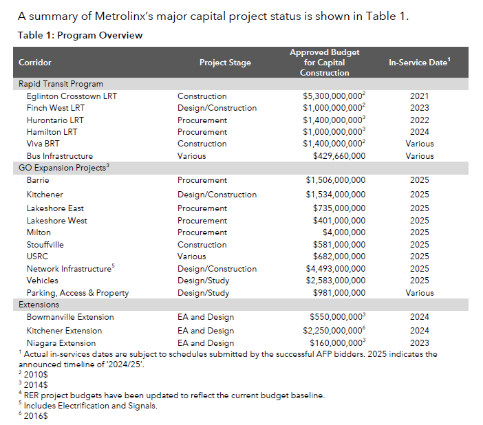

173924
http://www.metrolinx.com/en/docs/pd...0207_BoardMtg_CapitalProjectsQuarterly_EN.pdf
Things are progressing. I guess early-mid 2020s was optimistic, but 2025 is listed as the in-service date.
