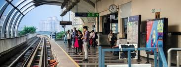

But beware! The Simpsons and the Monorail Episode still applies, and this is my massive concern with the Ford fiasco unfolding:
IL&FS Scam: Gurgaon’s Rapid Metro Was Based on Entirely Fraudulent Numbers
Sucheta Dalal
23 November 2018 8
The spanking world-class Rapid Metro, which became operational in Gurgaon (now Gurugram) in 2013, has certainly added lustre to the modern township built by DLF. But the project is based entirely on fraudulent and fabricated ridership claims, to get government sanctions, right of way for land use and other benefits.
The metro project was conceived by DLF, the realty giant, and mid-wifed by the scandal-hit Infrastructure Leasing & Financial Services (IL&FS). They are also the two biggest beneficiaries. India’s public sector banks (PSBs), as always, are stuck with the bad loans of this gold-plated project.
Here is how it unfolded. DLF originally proposed a 3.2km metro project between Sikanderpur and National Highway-8 (NH8) to the Haryana government in September 2007. It hired IL&FS to prepare the Detailed Project Report (DPR) as a consultant. This was submitted by DLF to the Harayana government's town and country planning department.
Metros, even elevated ones, are expensive showpiece projects and ought to be considered by smaller cities only when other modes of public transport are inadequate to meet growing transportation demand. But when you have a powerful corporate, captive government and pliant bureaucrats, all good sense is thrown to the wind. [...]
https://www.moneylife.in/article/il...sed-on-entirely-fraudulent-numbers/55792.html
Sound familitoid? Beware Doug Ford's follies! Ssssscarborooooo
