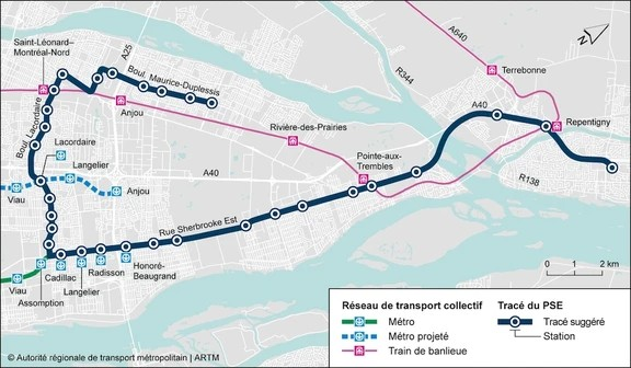

The tram's downtown segment through Notre-Dame has been cut back. New price tag is 18B. 31 stations over 38km
City segments are expected to have a speed of 30km/h and certain segments along the highway can reach 100km/h. Whether signal priority will exist if not has not been mentioned.

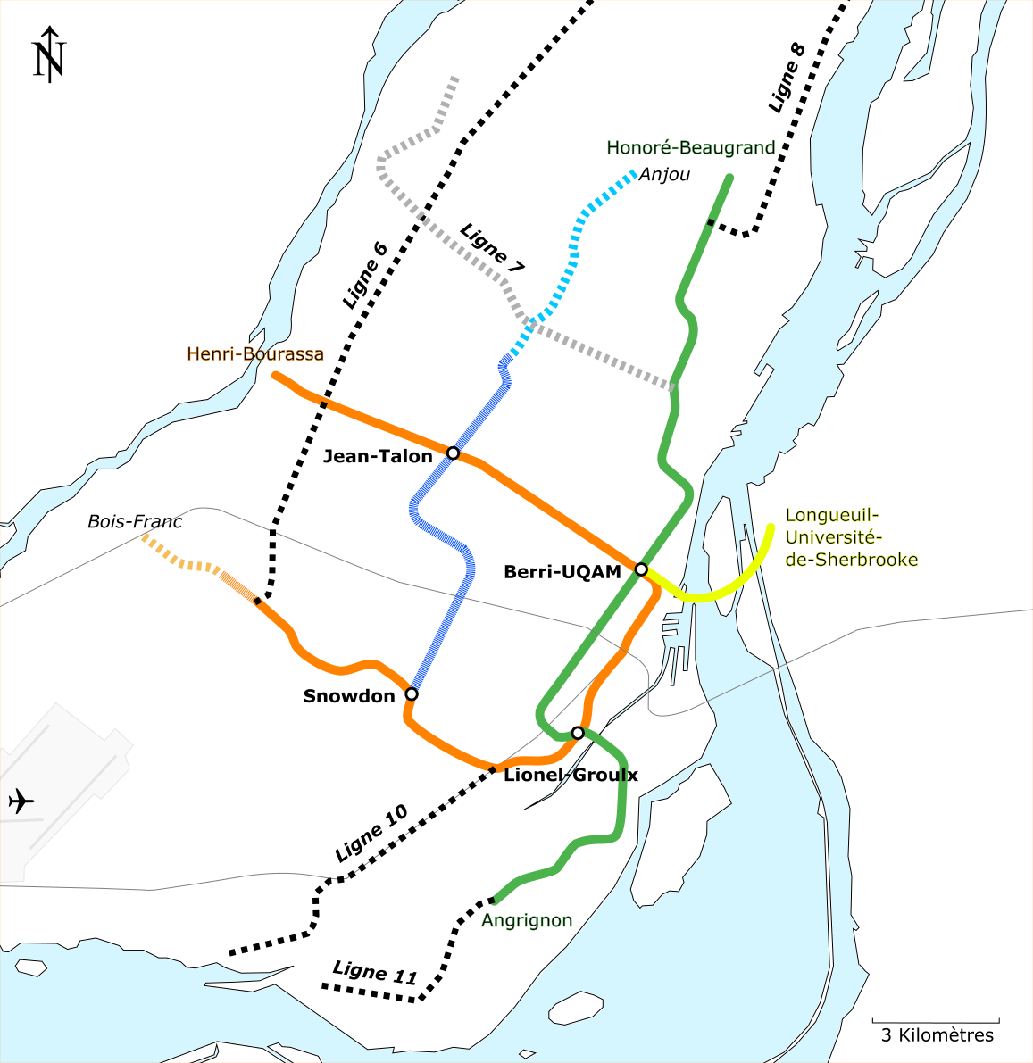

1) Extend the Blue line further into the east end, possibly cutting over to the proposed tram route
2) Extend the Green Line into the east end along the tram route.
3 Convert the commuter line to RER/Subway type operation.
In the case of the subways, I realize it would be costly to deliver a fully tunneled route of comparable length. But would it be possible to surface any of the alignment in a non-controversial way? Or alternatively, to simply build a shorter extension to which bus routes would continue to be linked?
The overall shape/length of the proposed route baffles me, as it runs 2 or arguably 3 different directions, and feels like it doubles back on itself. I take it there is demand along that alignment, but it seems like a very convoluted way to meet that need.

One and two are mostly about cost of building it as full metro, and demand.
Until 1984, the Blue line (Line 5) actually was going to turn north on Pie-X (just west of Lacordaire) and follow pretty much that alignment. Then in the 1984 plan, they ended up closer to where they are today.
The commuter line was planned as more of an RER/Subway-type operation back then (as Line 6), and terminated at Metro du College. Line 7 (the White Line) would have been full metro. But the southern leg of this travesty (Line 8) was a relatively cheap more LRT-like mostly along the railway alignment. The Blue Line is pretty much unchanged, the sold blue was well under construction in 1984, and the dashed blue section is still what they are now talking about building now.
I'd think replacing the southern leg with the old Line 8 concept, and building a lot cheaper LRT up Pie-X or Lacordaire, and into Montreal-Nord would be better. At these type of costs, I'd think the money would be better spent on something like the pink-line concept that ignores the road grid.
(Line 10 and Line 11 were also LRT - which I guess some would call Transfer City - I'm sure Montrealers are relieved that they can still take buses to the Metro, rather than the forced indignity of having to change from LRT to Metro).
