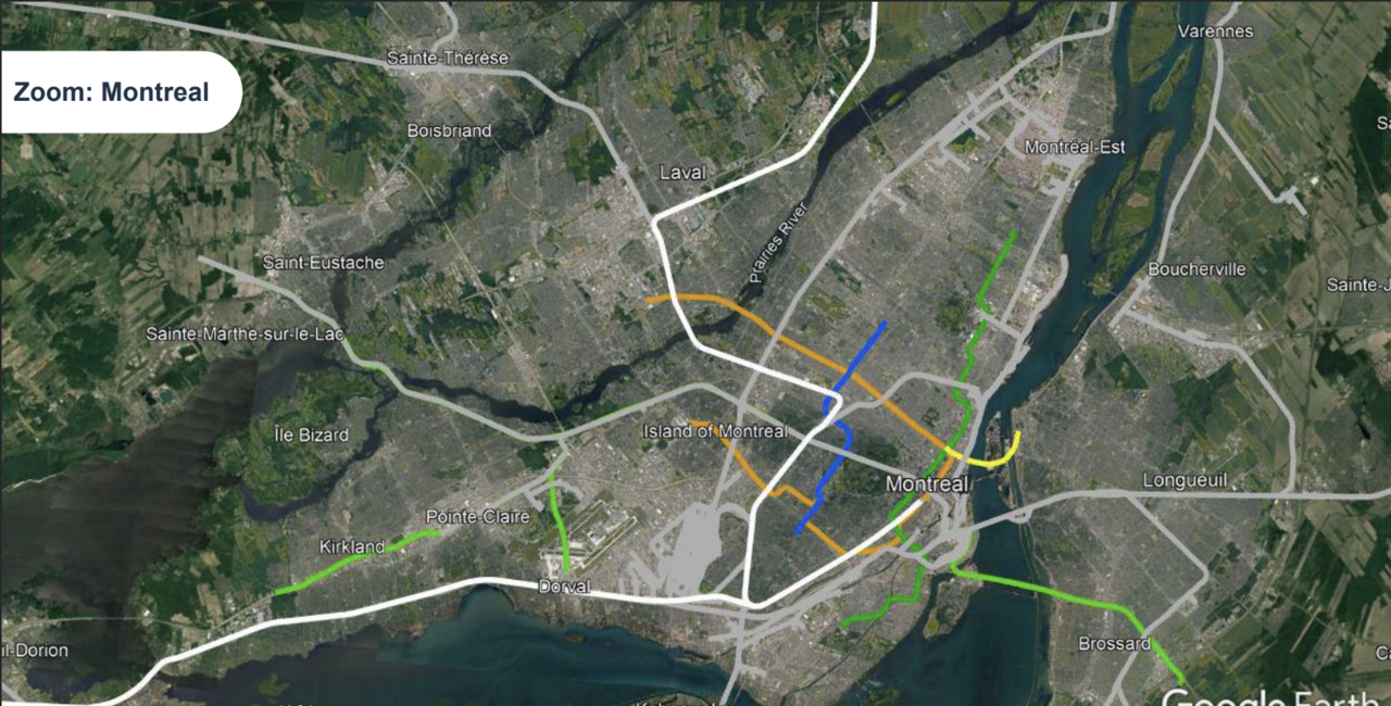

In the long term, it may cause issues for high speed rail to access Quebec City from Montreal - Alstom's 2022 HFR presentation shows a time wasting reversal in and out of Montreal...

Another HSR report suggested building a second Mont Royal tunnel to allow for faster Montreal-Quebec traffic ... it does suggest that CDPQ Infra got a very expensive bit of infrastructure at a very low cost...

The Mascouche line and the Saint-Jerome line, as well as any form of HFR or HSR link towards Quebec City critically depend on the tunnel to access downtown Montreal at a reasonable travel time and construction cost. So apart from irrevocably cripling the future prospects of all other existing suburban and intercity passenger rail networks, it was the best idea the transport policy makers of this city, province and country ever allowed to happen…
Surrendering the Mont-Royal tunnel has added maybe $10 billion in construction costs (for a second tunnel) and 10 years to the timeline for the expansion plans of exo and VIA/HFR/HSR, which have been known for decades.
A picky point, but the Saint-Jerome line uses the CP rail network, comes into / goes out of Montreal the Lucien-L'allier station outside the Bell arena, via Montreal West, Park, and so on, to St. Jerome. Does not, and never did use the tunnel as part of its route.
It was always planned to divert the SJ line into the Gare Centrale and all what was missing was either the so-called Home Depot curve or a tunnel linking from Parc Station into the Mont-Royal tunnel. Neither solution is available anymore thanks to the rogue pension funds to which we outsourced the passenger rail network design in this city and province…
