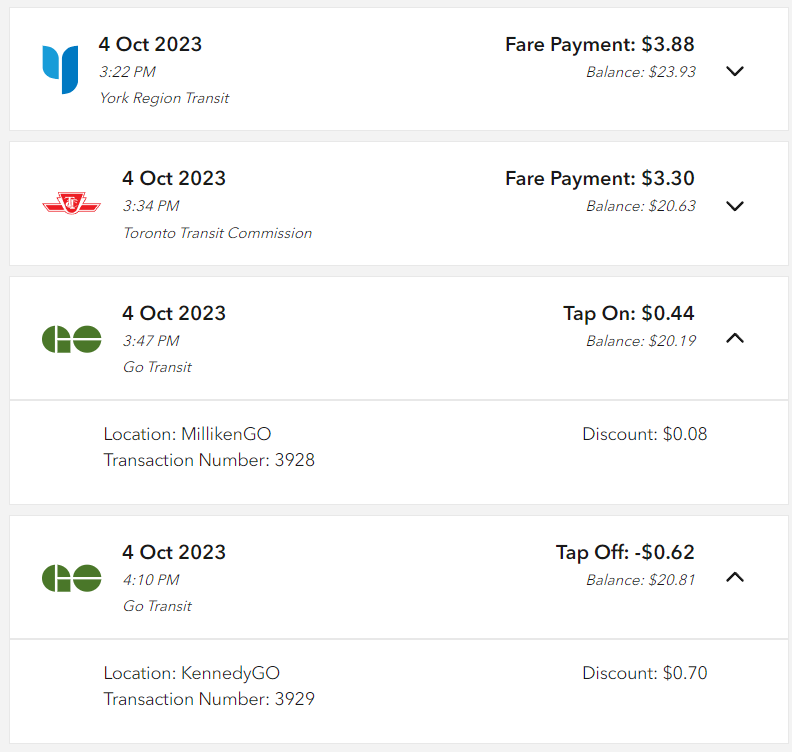

Can anyone explain this one? First tap on York Region (north of Steeles. Second tap on TTC 53 Steeles. Then I tapped onto GO at Milliken and out at Kennedy.
Somehow, I got 18¢ because I took GO after a YRT trip, than I'd have had if I just took YRT. Did the TTC trip in the middle screw it up?
Overall, you were charged correctly. The fare from Milliken to Kennedy is $3.70 on GO. When you take YRT to GO, your trip on YRT is free which is why you were refunded $0.18.
Oh ... I guess YRT is more expensive than GO now (!).
I'm surprised they don't charge the greater of the GO fare and the local fare. Perhaps they never considered the lowest GO fare would be lower than the local fare!
