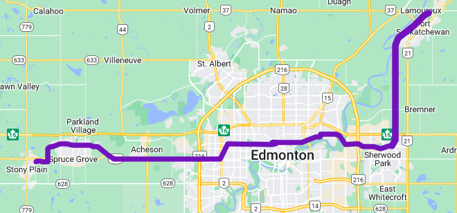

I saw a video last week on the Vancouver SkyTrain expansion and it got me thinking about what a similar train line would look like for the Greater Edmonton Area. Here is my rendition of what a similar line would be. I call it the North Saskatchewan River line. It goes from downtown Fort Saskatchewan to Homesteads in Stony Plain (I'm unfamiliar with Stony Plain, I'm sure there is a much better spot for the line to end.).
Fort Sask is most affordably served by a Capital Line Extension via the existing ROW that already cuts under the Henday/18 street when it was built. It would actually be a very affordable extension per KM because of the limited amount of grade separation needed. A park and ride & bus terminal could be built on the west side of the North Saskatchewan River just off highway 15. This would prevent the need for a river crossing, but allow for bus routes in the Fort to feed the LRT.
The other option is having a transfer platform from electric LRT to a diesel, regional style train at Gorman or whatever the next stop will be called. This would be quite affordable as it would allow for single tracking most of the route. I think this second option could be done for well under $1 billion, including the LRT extension.
I wonder how fast the capital line trains could get going with a big open stretch of track and no stations between Edmonton and Ft Sask
Top speed of the U2's and SD160's is 80 km/h, so, that's all you'll get regardless how big and open a stretch of track is.
What also might work for Fort Saskatchewan is its proximity to the CPR line (Josephburg). The railroad could take the CN/CP right-of-way.
The CP Scotford sub goes no where near close enough to Fort Saskatchewan that it would make sense to use it for a commuter route. While it does cross the CN Wainwright sub at at Cloverbar, and the Vegreville Sub at Bruderheim, neither option provides any sort of easy access to Fort Saskatchewan.
