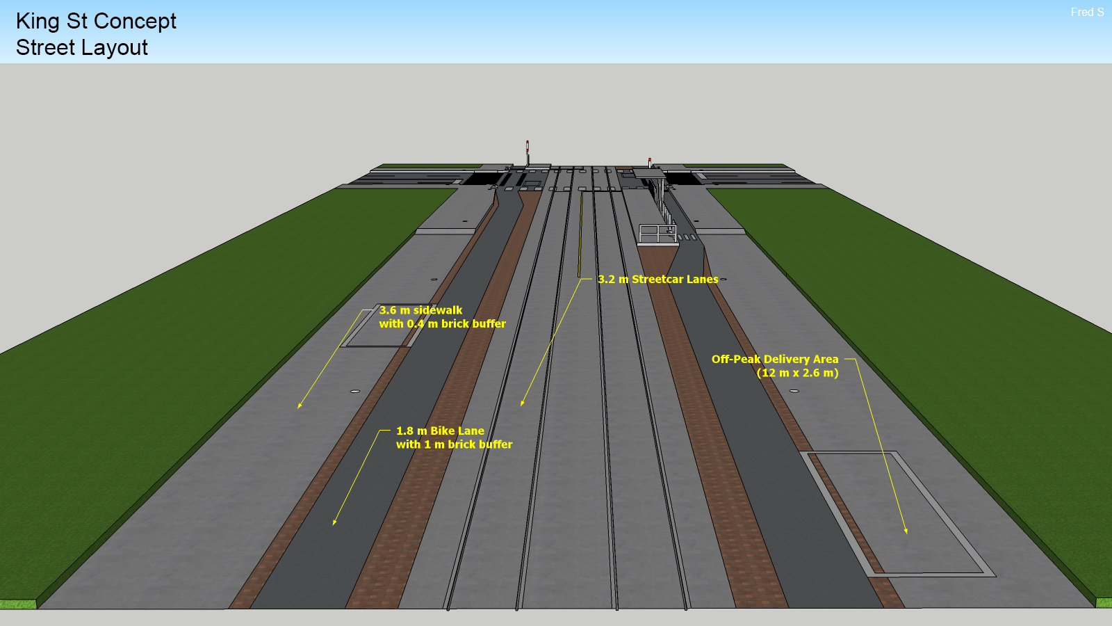

Your rendering inspired me to also come up with something in sketchup, which hopefully I'll post here soon. I agree with other posts that having bike lanes in the centre is probably not a good idea, but it would be nice if there was a good effort at making proper cycling infrastructure. If you're going to shift the streetcar lanes, maybe have them together on one side, and the bike trail on the other. Though my preference is just having the bike lanes on the outside.
I attached the Toronto Lane Width Guidelines. Note that streetcar lanes must be at least 3.1 m. As well, If buses regularly run the route, or part of it, they need to have 3.3 m, though this can be lower if there's a 0.7 m buffer between them and bike lanes.

I'm a huge fan of the side-by-side bi-directionals and think they should be considered here (depending on the arrangement of the rest of the street, obviously). The key, drawing on some of the difficulties we've seen in Toronto, will be utilizing a design that makes it physically very clear to both pedestrians and cyclists where the boundaries of the cycle-specific space are. There are lots of ways to do this, none of which I think have been effectively utilized here.
I see King being a transit mall (as opposed to a pedestrian mall), especially if we're also looking west of Bathurst, which doesn't see the amount of pedestrian use as the central section. I made a concept in SketchUp. It basically replaces the existing outer car lanes with bike lanes and brick buffers, while getting rid of the curb so the street is level (obviously there would be some slant for drainage). It also widens the sidewalk a bit. This is for the 20 m portion. For the 23 m section of King, I'd just add the width to the sidewalk.
The 1 m brick buffer may seem wide, but it's to keep cyclists away from the streetcars, as well as other vehicles away from the bike lane, by acting as a rumble strip. There is also a narrower brick strip between bikes and pedestrians, since there is no curb.
I would allow delivery vehicles only during certain times, and have designated spots (outlined by white boxes on the ground) where they can park for loading/offloading. The spots are well away from the tracks, so not to interfere with streetcars. and room is left for cyclists and pedestrians to go around.
At intersections, I would have fairly typical streetcar islands, and a raised sidewalk (it would be a more gradual climb than depicted in the render). It will keep people off the narrowed bike lane (and vice versa). The narrowed bike lane would have a calming effect on cyclists, and force them into single file, where they will be passing pedestrian crossings and approaching the intersection. There are bike boxes in the intersection for left-turning bikes.

I really like this. I'd be ecstatic to see it built. Two concerns:
- how do delivery trucks exit the delivery area? I suppose they'll have to back out.That could be a safety concern, if they have to mix with pedestrians.
- Generally mixing truck with pedestrians doesn't seem very safe. The hours of this off peak delivery hour would need to be restricted to early morning. Pearhaps 2 AM to 7 AM

I love when streetcars/trams have grassed ROWs, but I don't think that would make sense for King. Buses would have to use it sometimes, and delivery and service vehicles will have to be accommodated. As well, King gets closed down for street events sometimes, which may be more often if it isn't a car route anymore. Spadina, St Clair, and especially Queen's Quay would have been great for grass.
I'm also a fan of bi-directionals, since they can use less width overall. But moving tracks is pretty much a non-starter. It would change the track geometry at every intersection, and probably not allow certain streetcar turns. It could also probably mean moving underground utilities and rebuilding the stormwater pipes and drainages.

Thanks.
To be clear, trucks and all other vehicles (except bikes) would use the streetcar lanes to access the area. Speed limits for them would be maybe 20-30 km/h.
A fence of some sort would appear to be unavoidable, albeit that fence can be green (bushes) (in Paris, for instance, albeit Paris has many wide avenues). We also have to protect cyclists from pedestrians, which is a very real issue on the Bloor lanes. Unfortunately, fencing complicates multi-use for delivery and emergency vehicles. It's a conundrum, but something that *will not* work, is mingling of cyclists and pedestrians. Pedestrians come first in Ontario, even when in the road illegally, the onus on drivers (and cyclists) is to 'give way'. That won't happen with a lot of Toronto cyclists. I don't yet see a working plan to accommodate cyclists on Long as either a pedestrian or transit mall. Walk the bike? Absolutely, they become pedestrians, but not to ride unless segregated.
Oh. Great idea!
My concern with that is that there might be too many trucks on any individual blocks at certain times of day, interfering with the operations of the streetcars. I'm envisioning the delivery area being full with two trucks already, and a third truck thinking it'll be okay to block the streetcar or bike lane to make their delivery, or something ridiculous like that. Enforcement officers patrolling the length of the transit mall every hour or so might be necessary if this ever becomes a problem (and I'm not sure if there is enough truck traffic on King to make it a problem; I'm nitpicking).
Any truck congestion would be limited to early morning hours, minimizing the impact on transit users.
Overall really great idea though. I can't imagine any ways that a King transit mall could be improved beyond your proposal. Someone get this to Keesmat!

Well done. I thoroughly enjoy seeing stuff like this. I may agree with others though that it might be best to exclude cycle tracks from King completely. With the volume of pedestrians I can't see it working well. Same with QQW. The concept is great, but in a way it's a victim of its own success. Too many cyclists, too many pedestrians, and I don't think any amount of signage will improve it.
remember that there are a lot of garage entrances along King too that require access. More likely what you will see is a single vehicle lane on one side of the king car and a bike lane on the other, or something
This is something that a lot of people seem to forget. I think if those entrances and side streets didn't exist this project would've been greenlit years or decades ago. Adam Vaughan was one of the most urban and forward-thinking council members, and I believe he was opposed to a car-less central King. Not because he was pro-car or anti-pedestrian, rather because a car-free central King doesn't really work.
That's the example that comes to my mind too, and as both an avid cyclist and avid pedestrian, I hate cycling/walking through there, one is tense from being on edge all the time with rare occasions when it's deserted. I honestly prefer to cycle on the road to prevent cyclist/pedestrian collisions, it's mayhem.
On King, since consensus is pretty much that some form of *limited access for vehicles* is needed (but no through traffic), that too can be used for cyclists, but it will not be anywhere near optimal for cycling save to a specific destination down there. (Edit: Note the "No Cycling" sign upper left top pic) Pedestrians will be swarming all over, it will be prone to collisions, but there's really not much that can be done to prevent stupidity. My biggest concern then is that the streetcars can make good time through there without having to go slow for the mindless pedestrians.
