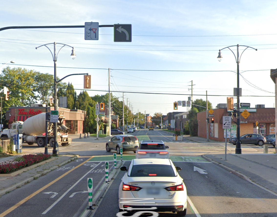

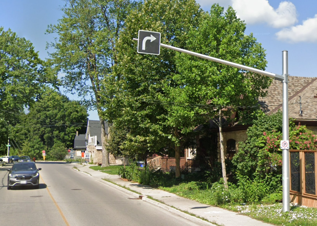

It seems like a Toronto transportation department thing to not tell drivers what they should be doing in a way that is clear.
Outside Toronto: Black must turn signs are used, often with a post to hold it out over the road.

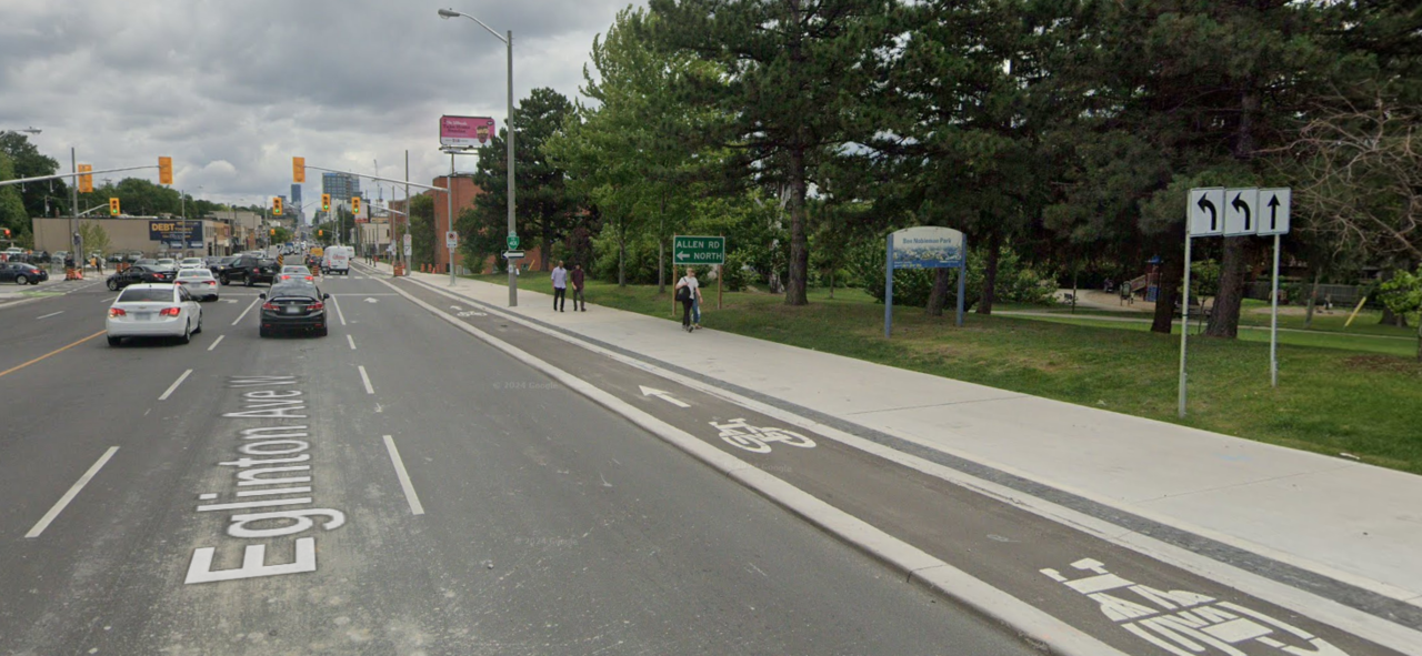

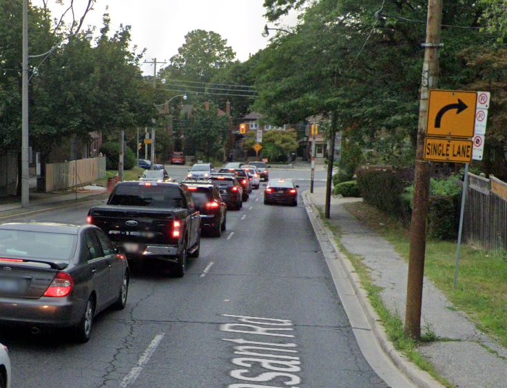

In Toronto: Everything but that clear black sign hanging over the road telling you what to do. Some white sign way over to the side of a three lane road easily obscured, a yellow sign at the side of the road which seems to be a cross between a road curve sign and the lane sign, and of course the Toronto favourite of not telling people what to do but instead telling them what not to do.
View attachment 560142View attachment 560147View attachment 560146
View attachment 560148View attachment 560149
