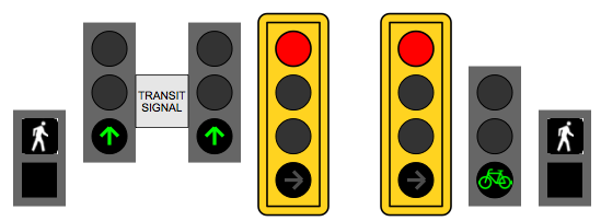

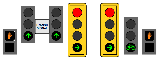

Duplicate bicycle signal heads are not required by regulation, but are listed as a "should" in OTM book 12A.
Your design might work well with a white bar transit signal atop the regular yellow signal, and then the two bike signals.
Agreed. Best to minimize confusion between the transit green and the vehicular traffic green. Mount the bicycle signals somewhere near the pedestrian signals. Otherwise, a great suggestion reaper!
I agree that it would be better to have white-bar transit signals, but as I have explained before here, implementing them would require major changes such as to the HTA and/or to every other white bar signal in the City, since currently a vertical white bar in Toronto means "Turn left or right, but do not go straight".
Further explanations here:
https://urbantoronto.ca/forum/threa...-transit-priority.19816/page-154#post-1279258
https://urbantoronto.ca/forum/threa...-transit-priority.19816/page-154#post-1279308
Like I said in my last post, this signal design is not supposed to be the best possible design, it's just a design that is possible right now without any changes or exemptions from operating policies or legislation.
Here's another option which is perfectly compliant with current regulations and standards:
Notes:
I think the guidance from OTM Book 12A is more applicable if the bicycle signal were the only signals for the approach (for example along a standalone bicycle path). In this case, they display basically the same thing as the two Transit Signals so there's no need for a fourth redundant signal. Also, if I'm not mistaken, book 12A predates the 2016 HTA amendment we're talking about so at the time of writing duplication was actually a legal requirement.
Also note that bicycle-shaped Bicycle Signal lenses were also legalized in 2016 with the same HTA amendment.
Notes:

FYI, your suggestion prohibits pedestrians from walking along King, given the right arrow gives turning traffic priority over conflicting traffic.
