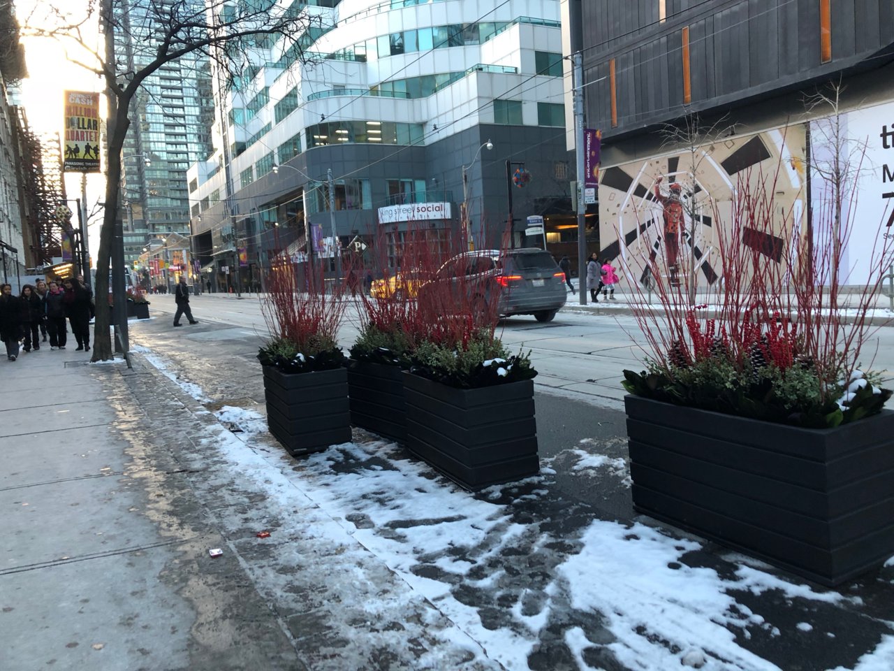

The pedestrian zone in front of Fred's Not Here has "mysteriously" been pushed out of the way, creating a parking zone in front of that restaurant.
The King Street Pilot office has been notified.
Well, that MIGHT mean that the restaurant will see ONE more customer - or maybe they just parked there to visit Metro Hall! If these restaurants relied on parking right at the door to attract customers their business model was really flawed!
