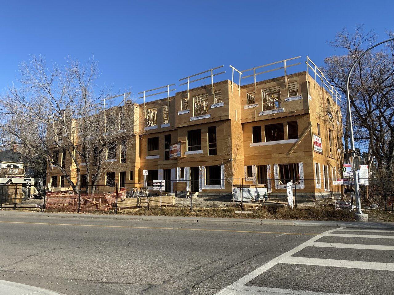

To make 4th into a decent corridor, there should be no more of these kind of developments

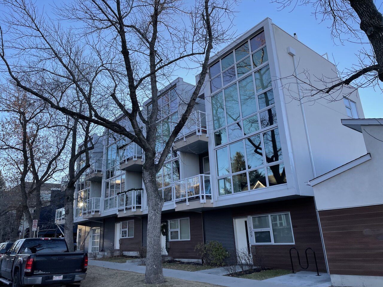

This is a better example, and on some corner lots maybe bigger projects with retail. This corner lot could have and maybe should have been a larger project

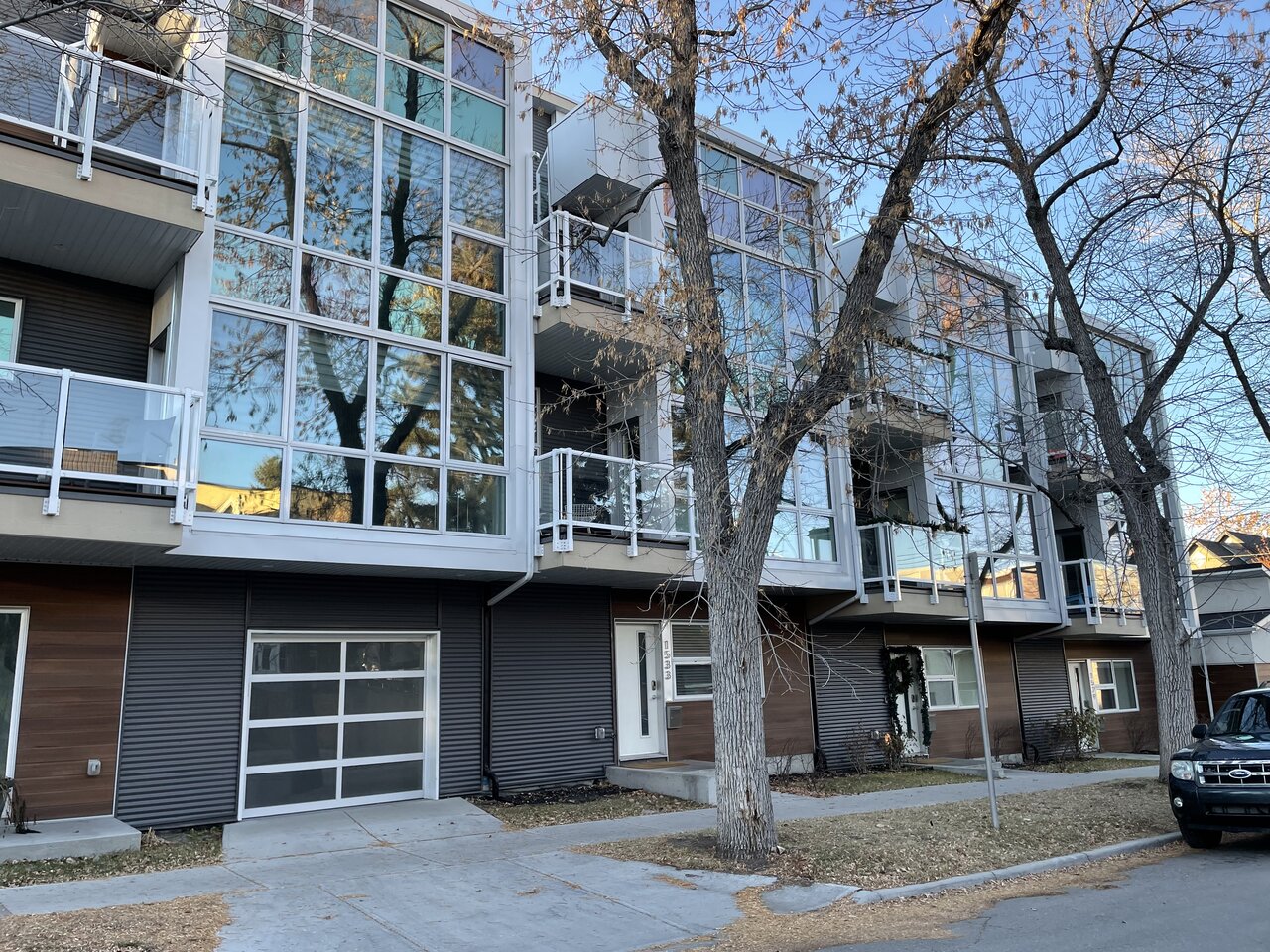

Pretty dense little row house development in Banff Trail. I counted 12 units plus basements suites = 24 units. I love these kinds of developments! They're attractive, fit in well and pack in an astonishing amount of density. 3 houses have now become 24.
Would love to see these on every corner parcel in the inner city

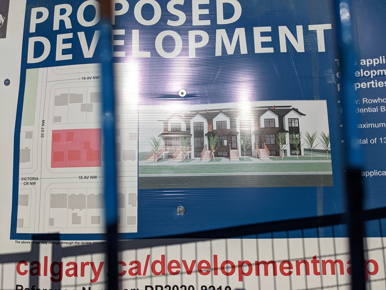

Man, the North Hill area has been on an absolute tear the past year or so. Especially in regards to rowhouses and other missing middle type buildings. Here's a proposal along 20th Ave for a 22 unit rowhouse complex https://developmentmap.calgary.ca/?find=LOC2021-0154
I honestly might go around and do an inventory soon but if I had to guess I'd say between Banff Trail and Capital Hill alone 50+ residential units have been added in just the past year or so

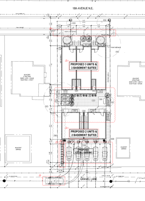

An interesting land use application is going to CPC next week. It is a mid-block rezoning along 18th Ave NE in Tuxedo Park, going from R-C2 to a Direct Control on the M-CG district. More details in the Report.
The CA is opposed to it, and I can kind of see why. There is an accompanying DP summary here:
10 units where there used to be 1-2. I am not to worried about the density, or the reduced parking, but more so the built form a bit, that puts the second building (with the 2 upper units and 2 basement suites) much deeper into the parcel, to accommodate the parking stalls. In this particular instance, it might not be so bad, as the two homes on either side appear to be original ones that are likely destined for redevelopment. But, if you had a typical infill, with the garage closer to the lane, and one of these got built on either side of you, it would certainly make your yard feel very "walled in". Maybe that isn't a bad thing, but, like the CA letter says, is a mid-block parcel appropriate for this level of density, if it requires the amount of relaxations and compromises as this one does? Especially when there is no shortage of land along the more major corridors where higher density can go?
View attachment 365583View attachment 365584
Love this. I get why the CA is against it, but here is the rub: you need to use M-CG to build anything reasonable on a mid-block site. R-CG doesn't work/function for mid-block. This is absolutely the type of development i would be fine with anywhere in that is currently R-1 or R-C2 (although i think in this instance the basement suites might be a little overkill.
I think there are similar (identical?) proposal(s) on 33rd Ave SW. Looks like the same development team. I actually don't love these proposals on 33rd, as I think development on 33rd Ave SW should exclusively be 4-6 story condos, but row housing continues to be proposed on the street. I think the form makes sense at this location on 18 Ave NE, although it's too bad that they couldn't have purchased the lots on either side of this lot to make this a larger development, particularly the other mid-block lot, because redevelopment of those lots will probably have follow a similar formula.
Push the smaller, second building to the lane, and get rid of the two basement suites and instead have 2 suites above a 4 car garage, and pretty much all of my concerns go away. yes, you go from 10 to 8 units, but still, 8 units! And a built form that would be nearly identical to a semi-detached. Plus, I do worry that the courtyard for this project as currently shown will be nothing but a dark, shadowy place of no real value. Pushing it back would provide an amenity space that is much more enjoyable for the remaining 8 units.
I feel like this would work if the rear/lane units were built above the garages and had at grade entrances along the courtyard (like typical slab on grade townhouses). If they did that and got rid of the basement suites on the rear units and did or did not keep the basement suites on the street facing units this would be a perfect example of small lot, mid block row homes that should be an easily approvable option.
