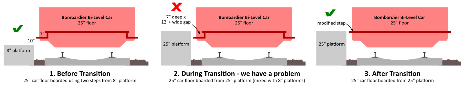

Compatibility, Done Backwards
Steps from an 8-inch platform
into a Bombardier bilevel car
with a 25-inch floor. The first
step is 10", the second 7" Caltrain justifies its desire to procure a new EMU fleet with 25" floor height thus:
With a 25” floor threshold, the new fleet will still be compatible with the existing fleet and platforms and could transition to level boarding over time. "Existing fleet" in this context means the Bombardier bi-level cars, known to the layperson as the red Baby Bullet cars. Caltrain plans to keep these cars for a few years after the new EMUs arrive. The Bombardiers already have a floor height of 25" above the rail, although existing 8" platforms currently require two steps up, as seen in the photo at right.
The statement above sounds like a genuine interest in compatibility, and at first reading seem to make sense. But let's analyze Caltrain's ideas about compatibility more closely.
Compatibility with Existing Fleet
Suppose for a moment that we planned to "transition to level boarding over time" at 25 inches, because we think it's smart to match the floor level of the Bombardier cars so that we can keep using them after the conversion to level boarding. Is that even a feasible scenario?
The "before" and "after" cases are straightforward. Before transition is just the way things are today. After transition is complete, the entry steps are easily modified to match the interior floor height, achieving gap-free level boarding just like this photo of Utah FrontRunner Bombardier cars docked at 25-inch platforms.
It's the "during" case where things fall apart: because the step modification involves a one-time visit to the shop, there is no way for a Bombardier train (or any other train in Caltrain's existing fleet!) to serve an evolving mix of high and low platforms in daily service during the "transition to level boarding over time". There would be a 7-inch deep, foot-wide trough between the platform and the car floor that would qualify as a serious tripping hazard even for an able-bodied passenger. This configuration would be illegal under a number of federal regulations. The Bombardier fleet would have reduced utility for the duration of the transition to level boarding, likely to be several years. So let's say it again:
Bombardier cars cannot serve an evolving mix of 8" and 25" platforms during a transition to level boarding over time.
Once the transition to level boarding is complete, maybe in the mid-2030s, the Bombardier cars will be at the end of their useful life. Given the limited remaining lifetime of the Bombardier cars, their inflexibility during transition, and their dwindling residual value, there is little value in matching the new level boarding platform height to the Bombardier cars. There may even be negative value in doing so.
