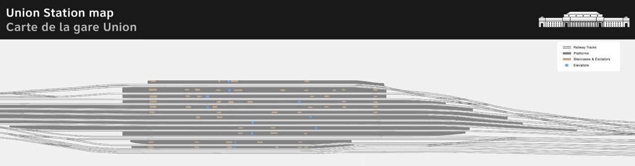

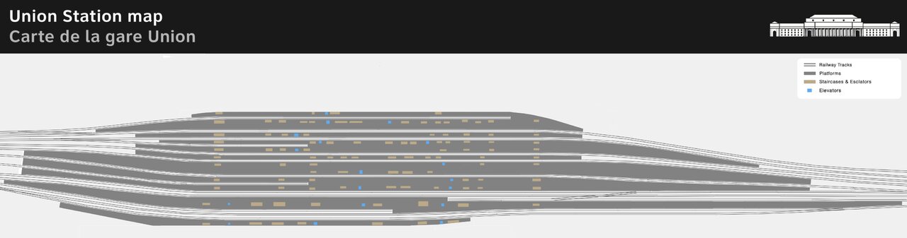

Both are happening (the platforms may be long in the first photo, but besides the Canadian they are never used, in the new design they will be):

Are they still going to be long enough for the Canadian? The longest ones look shorter.
The Canadian has rarely ever needed to use an entire platform, there’s been few cases where the Canadian was 30 cars long and they were all years ago, so having a platform be that long for a train that rarely reaches that length is unnecessary.
I've seen 18+ offhand. Though I guess it can handle two 12-car GO trains, it should handle a 25-car Canadian. Though I was surprised they were rehabbing the very longest platforms not that long ago.

We've added a front page story that gives an overview of what's been going on at Union Station lately, among other things introducing people to what's going on with the platform work. Thanks @Willybru21 for your lovely platform diagrams that you posted a couple pages back, they will start to give people an idea of the scope of the work here!
