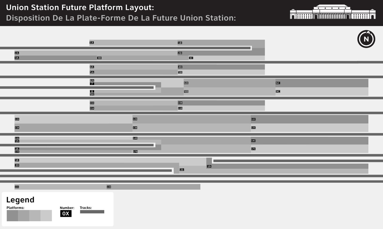

Finished a diagram on my future vision for Union Stations platforms and how they will be numbered, for more information about why I see this to be the case check out my Tweet:

has double berthing been 100% confirmed? hell has triple berthing? thought that was still an idea?
also why are 7 and 15 stub platforms?
Double birthing hasn’t been confirmed yet, but consider that the early design of the reconfigured platforms show a lot of them being extended, and pair that with most GO trains getting shortened significantly and running more often after GO Expansion, and you can probably see why I’m expecting double birthing or more to happen.
7 and 15 are stub platforms exactly as they are shown in the USEP document released earlier this year (Trying to find a link to the document for you, when I find one I’ll edit this message with it)
Double birthing is a core function of the new signal system.
It has been confirmed since the resignalling of the USRC was launched in 2007.
Dan
Double berthing goes against through running, in case Metrolinx wants to convert most of the lines as through running lines.
It really depends on the frequencies. At high-enough frequencies it might be practical for Kitchener and Barrie line trains (for example) to time simultaneous entry into Union and depart eastbound after turning over passengers.
Basically, if there is a Kitchener train within 2 minutes of the Barrie train, then Barrie train might wait to always tuck in behind the Kitchener train to maintain platform order. This timing can be aligned by Barrie trains holding at Caledonia GO station for up to 2 minutes extra. They would share the same dwell period at Union so throughput at that station should be maintained: very very small fixed blocks or moving blocks would allow near simultaneous eastbound departure of trains too.
Feels kinda fragile though.
I presume there's no way to make the mandatory push-pull continuity test faster or obtain an exemption? If so then step-back drivers would be sufficient.
Running through will reduce capacity versus double berthing. This is why it is being done.
I assume there is provision for some trains to still run through. Are the new platforms they are now building on the south even long enough for double berthing?

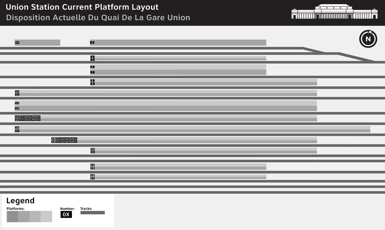

Here’s the current platform layout at Union done in the same style as my other map above if you’d all like to compare the two:
