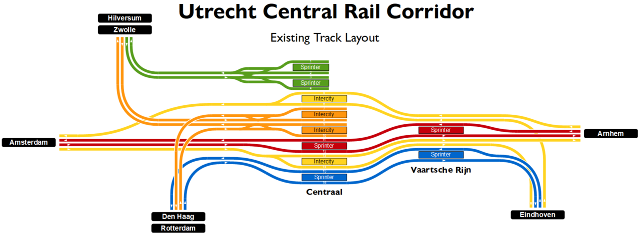

Yes of course in practice any train is able to switch to a different platform if its intended platform is occupied, but there would typically be a fairly fixed platform (or pair of platforms) for each service which provides a path through the corridor with as few conflicts as possible.
I think the best demonstration of this principle is the layout of Utrecht Centraal station, which was rebuilt a few years ago in order to minimize conflicts in the rail corridor.
In addition to the tracks shown here, there some extra switches which allow trains to swap between platforms if necessary. For example, intercity trains from Amsterdam (normally on track 13 or 14) have a switch which allows them to reach track 12. However it is not possible to reach every platform from a given direction.
Intercity trains from Den Haag and Rotterdam reverse in the station and continue north toward Zwolle. As a result, the intercity line north from Utrecht is left-hand running. There is a flyover north of Utrecht which brings the northbound track back over to the right hand side.
