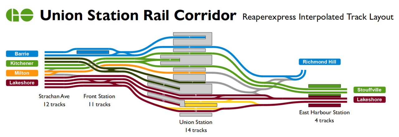

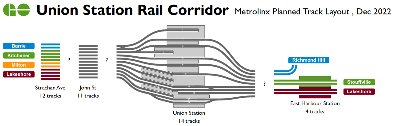

Here's a schematic diagram of the track arrangement shown in the Metrolinx submission. For context, I have also included the planned track configurations east and west of the USRC, as well as the 11-track pinch point at John Street.
To get a rough idea of what the typical use of each platform might be, I did a simple connect-the-dots exercise to fill in the unknown sections. Please note that I gave very little thought to these conceptual layouts, they are really just intended to give a ballpark idea of where tracks end up.
Here's a version with the existing flyunder.
Track 1: Barrie
Track 2: Barrie / Richmond Hill
Track 3: Stouffville/Kitchener Local westbound
Track 4: UP Express
Track 5: Stouffville/Kitchener Local eastbound
Track 6: Milton
Track 7: Kitchener Express / VIA Sarnia
Track 8: Kitchener Express
Track 9: Lakeshore Local westbound
Track 10: Lakeshore East/West Express
Track 11: VIA Ottawa/Montréal
Track 12: Lakeshore West Express
Track 13: VIA Windsor/Ottawa/Montréal
Track 14: Lakeshore Local eastbound

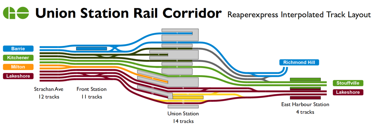

Here's a version where the flyunder is removed:
Track 1: Barrie
Track 3: Kitchener Express
Track 4: UP Express
Track 5: Kitchener Express / VIA Sarnia
Track 6: Stouffville/Kitchener Local westbound
Track 7: Stouffville/Kitchener Local eastbound
Track 8: Milton
I'm pretty sure that track 4 is for the UP Express given how small it is, and this version places it on the north pair of tracks in the Kitchener corridor, which doesn't make sense since it splits off toward the south at Wice (Pearson Junction). Based on that, my guess is that they are planning to keep the flyunder in the USRC.
Track 1: Barrie
Track 4: UP Express
Track 6: Milton
Track 1: Barrie
Track 4: UP Express
Track 8: Milton
Track 1: Barrie
Track 4: UP Express
Track 6: Milton
Track 1: Barrie
Track 4: UP Express
Track 8: Milton

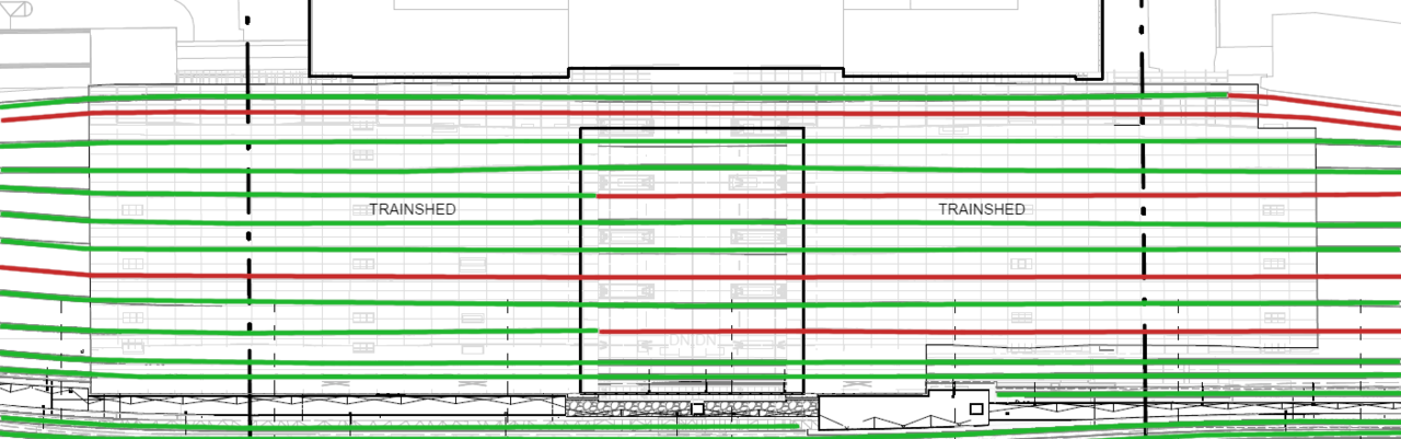

The platforms appear a lot narrower at places where the track is dead ending. For example, Tracks 1, 4 and 8. Aren't they rebuilding the platforms to make them wider? In this diagram, it looks like some portions of the platforms will be narrower while some other portions wider.
Why would Lakeshore and Stouffville trains be confined to different tracks east of Union Station? Presumably, they'd share, especially if a flyunder/flyover is built west of Scarborough Junction. That would keep express and VIA trains clear of all-stops locals.
Because Verster doesn't want to build said flyunder at Scarborough Junction. I would rather they did build that flyunder because it would allow them to group the services by speed, allowing more opportunities for express/intercity trains to overtake local trains, and allowing people at the local stations to just stand on one platform and take whichever line shows up first.
They aren’t really rebuilding the platforms and making them wider, they’re just filling in some of the tracks, there is still a lot of very thin platforms though.
