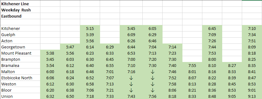

I tried to see what could be possibly done for the Kitchener Line
193593
This weekday eastbound rush just adds a departure at 6:29 from georgetown. I'm not quite sure where else you could fit another train? I also made the 5:45 Kitchener train express from Malton.

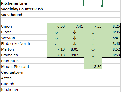

193594
Weekday counter rush just makes the current deadheads into super express trains. I don't think its really possible to make a 15 minute all day service without the 4th track in place

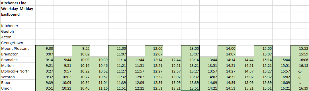

193595

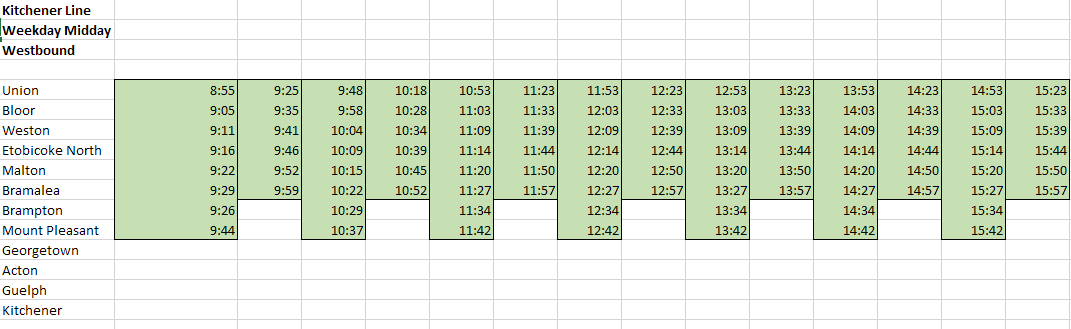

Both way 30 minute Midday service is possible, The trains would meet at Malton Go and about halfway between Weston and Bloor stations which at the moment the eastbound train uses the southmost UPX track on the corridor and the westbound train uses the regular go track. At Bramalea there is a 40 minute layover. I think 30 minute to Mount Pleasant may be possible but that would be up to CN. 15 Minute to Bramalea is not possible with the current track layout.
