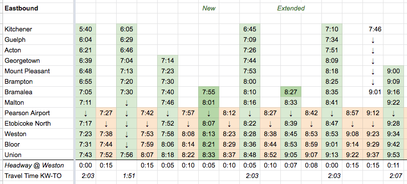

Here's the new consolidated schedule for Kitchener, highlighting the changes during the AM Peak:
178512
It looks like the new schedule has been designed to blend well with the UP Express schedule, perhaps to reduce crowding on UP Express. Throughout the entire peak hour there's never more than a 10-minute gap at Weston.

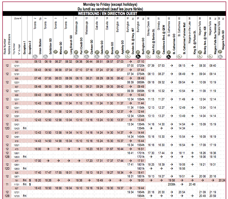

They got rid of the Friday regional trips to and from Niagara that used to be a part of the seasonal service.
See for reference this schedule from June 2016:
178532
There's a trip from Toronto to Niagara at 18:20 which does the trip in 2h04. Then the same train heads back to Toronto at 20:40, arriving Union at 22:44.
In the 2019 schedule, the only direct train is the 17:15 which takes 2h32, arriving 19:47. But actually the fastest trip is the 18:46 local train with an express bus connection from Burlington, which somehow does the total trip in 2h03 (even though the 2016 schedule above has that same trip taking 2h16).
Also, in the 2019 schedule they've added 10 minutes to the weekend trains, bringing the trip to 2h14 rather than 2h04. All the time has been added between St. Catharines and Burlington.
And there is no longer any Route 11 GO bus between St Catharines and Niagara On The Lake.

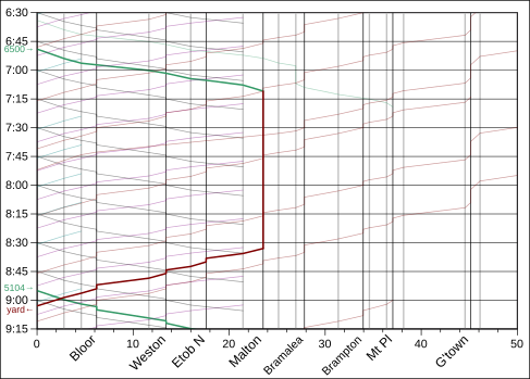

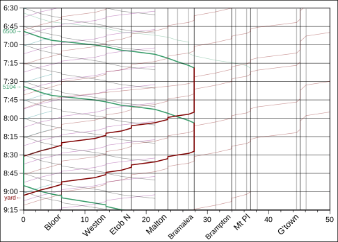

It's going to be interesting how they are going to get the trains to Bramalea in the morning. Right the 8:33 deadheads from union getting to malton around 7:15. Where are they getting this extra train from? Will they be using track 4 at bramalea?
There's currently a six-car train that arrives at Union from Gormley at 7:11, sits out most of the peak period in a yard, and then does the 8:55 trip to Mount Pleasant. I'm guessing they'll have this one do the 8:27 Bramalea trip and then go out of service until the evening, and then the train currently on the Malton trip would do the new 7:55 and turn back as the 8:55.
