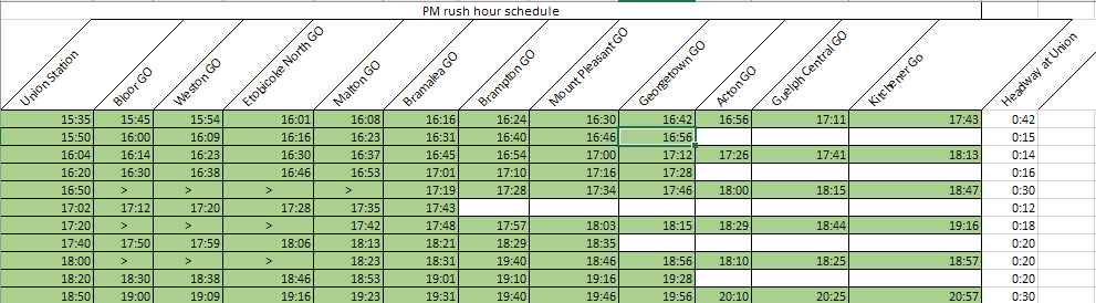

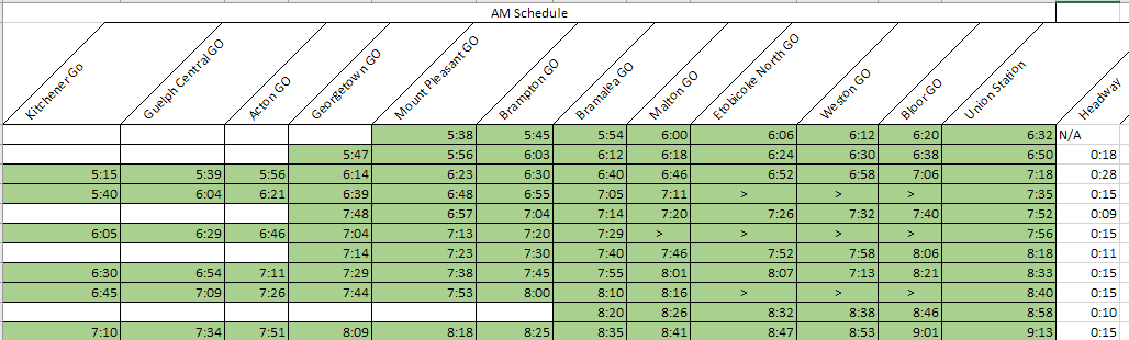

I tried my best to make a reasonable rush hour schedule knowing the storage capacity of both the Kitchener Yards and the Georgetown ones. 6 Trains starting at Kitchener and 3 starting at Georgetown. With the pocket track at Bramalea(hopefully that will be finished eventually) and the one At Mount Pleasant you can have a train starting there too and then in the afternoon turning back and either deadheading to Union or being counter peak service trains(or super-express trains like on the Lakeshore lines). The schedule i made up doesn't really require much explaining but there are 3 express trains with one being express from Bramalea and the other 2 being express from Malton. I included VIA Rail 87 just because it runs during the rush hour and to show it doesn't conflict with the other trains.
As for Car lengths:
The 3 Trains from Georgetown would be 10 car trains.
The train from Mount Pleasant can be 10 or 12
The train from Bramalea can be either 10 or 6 cars, 12 seems like overkill.
You can have 4 12 car trains on the Kitchener yard so i would put 3 of the express trains as 12 car, and maybe the 6:30 departure as 12 car, The other 2 can be 10 cars
In the afternoon, the 3 express trains and either the 6pm or 4:04 can have 12 car trains. The rest with 10 cars.

Are all the tracks at the Shirley facility capable of handling 12 car trains? I thought it was just the outer two.
As for Car lengths:
In the afternoon, the 3 express trains and either the 6pm or 4:04 can have 12 car trains. The rest with 10 cars. View attachment 171557
This is a really interesting concept, I am liking it, but a few things,
What train is the yellow express? Does it deadhead back to Georgetown or something?
I feel like some of the time estimates are quite conservative, especially for the express trains. In the past, the 16:50 from union could.d reach Kitchener within 1 hr and 50 minutes, but would often arrive 1hr and 40 minutes after leaving Union. Some of the other times (16:14 for instance) have the train arriving back in Kitchener within 1hr and 59 minutes. Usually this trip will take 2hrs and 10 minutes but will often be closer to 2hrs and 5 minutes.
Otherwise, a very interesting layout.

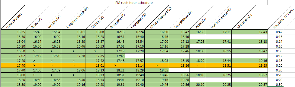

That's Via Rail 87, I just put it on for reference, I can make another version without it if its confusing people.
I used the same timings as the actual schedule posted. In my experience riding the 4:50 Express we usually arrived at kitchener at 6:45-6:50
Redid them with just Go Transit Trains this time, I might make one with early morning counter/ afternoon counter peak and evening trains. Wasn't the plan in the Business Case to have 15 minute service to Bramalea Go and Hourly up to Mount Pleasant?
