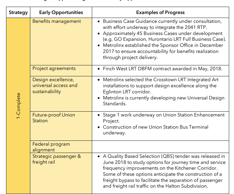

View attachment 166005View attachment 166006View attachment 166007
This is going to cost so much money. Where is the cost comparison between adding 3 tracks and doing this bypass?
That's probably what this is meant to look at (see the last box). Posted this back when it was made public in September.

Forgot to tag you! Thank You for the info. According to the initial business case, a credit river grade separations is needed over the CPR Halton sub, double track between Kitchener and Georgetown, and 2 new tracks from Mount Pleasant to Georgetown. I do agree, and I think that is what CN is looking for to happen. But that is costly. For Milton, why not nust built the one extra track for now and go from Meadowvale to Union until more money is available?
Its not an Apples to Apples comparison.
The bypass offers so much more than adding another track in the Georgetown corridor.
Fair but the bypass delays everything to 2024. Tracks are much faster.
