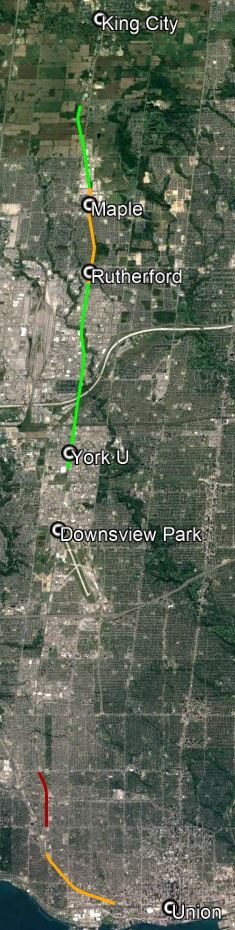

As far as I can tell, this is the current status of double tracking on the Barrie Line:
Green = Complete
Amber = Under Construction
Red = In Planning
From this vantage, it looks like extending the double track south to Downsview Park (inclusive) would shorten the single-track segment to about 10 minutes, which would allow half-hourly bidirectional service (i.e. hourly counter-peak service in the PM but not the AM), though given the lack of sidings north of King City, all but the first counter-peak trains would need to turn back at Maple. Still, it would definitely allow at least one more counter-peak trip from Aurora, shortening the 6-hour gap to 5 or maybe 4 hours.

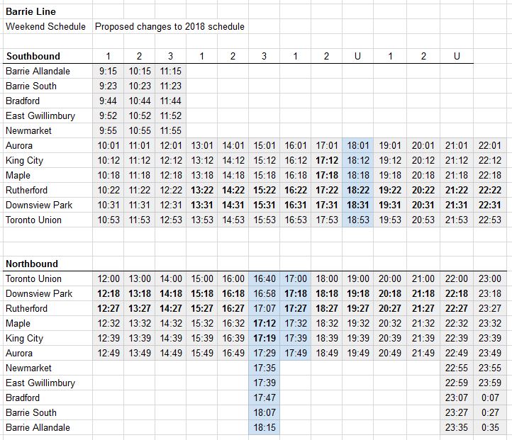

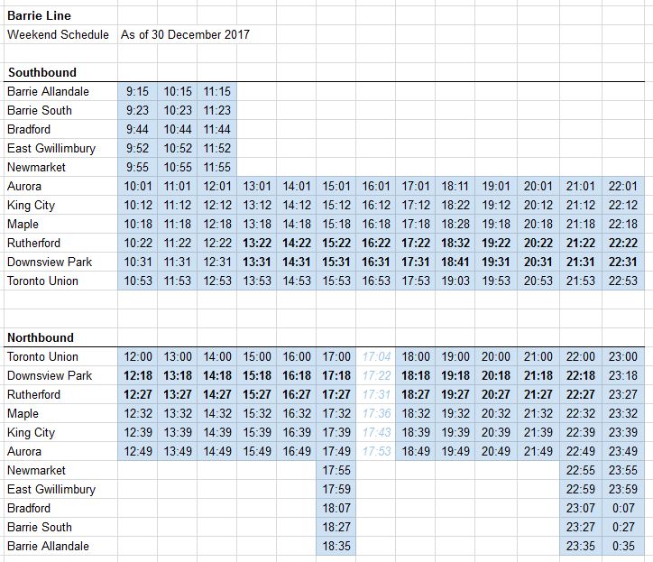

Within the existing track configuration, I was surprised to see that the weekend "18:01" (18:11) SB trip from Aurora still heads northbound from downtown as a deadhead rather an in-service run. With the 17:00 NB to Barrie in the normal hourly slot and the deadhead behind it, the 18h SB trip from Aurora needs to be pushed forward 10 minutes to :11 rather than the normal :01 to provide enough turnaround time in Aurora.
(Meets highlighted in bold)
With two reasonable-length sidings now active, it would be possible to run the northbound trip to Aurora in service as per the normal hourly cycle, meeting the SB trip in the York-Rutherford siding, and have the northbound trip to Barrie run ahead of it, meeting the SB trip in the Maple-King siding. This would add an additional departure at minimal cost (given the trip already exists, albeit out of service), and would allow the southbound 18h trip to depart at the normal time of 18:01 rather than 18:11.

I think they will have to double the whole thing just to get hourly service both ways. And they will have to do something about Newmarket, as the plan is to go to Barrie hourly both ways. And great map, very informative.

Thank you for the map.
However, I was under the impression that there was some sections of the Barrie Line already double tracked north of Maple?
I was hoping to see that in a map as well.
I was certain one was posted before.

Not sure what you mean. There is one completed double-track segment between Maple and King City, shown in green on that map, then the next thing north of there is the siding at Bradford if I recall correctly.

You have the two sections of completed double-track correct.
The section of single-track in between them, however, will be double-tracked along with the rest of the line from Parkdale to Aurora as part of the already-begun process.
There is a siding at Bradford Station, although it's currently being used for trainset storage.
I showed that segment as "under construction" in recognition of the reconstructions of Rutherford and Maple stations, both of which are actively under construction. The current construction doesn't actually include the second track itself, but after the Davenport Diamond, the station expansions are the second- and third-biggest infrastructure works required before laying the completed second track. Other than widening the bridge at Downsview Park station, the remaining segments of double-track are very straightforsard - the infrastructure is all preexisting and all that's missing is the rails.
It's not though, as the grading between those two stations won't be done until the contractor for the whole works will be done. Hell, they haven't even graded the area through either station for the second tracks.
If you're going to argue that, why don't you also argue for Downsview Park Station, which has the grading and a short section of the second platform done?
Realistically it's silly to argue for either as neither section will be done in advance of the rest of the corridor in any case. While the corridor is likely to be opened in stages, that kind of decision is likely to be taken by the winner of the tender.

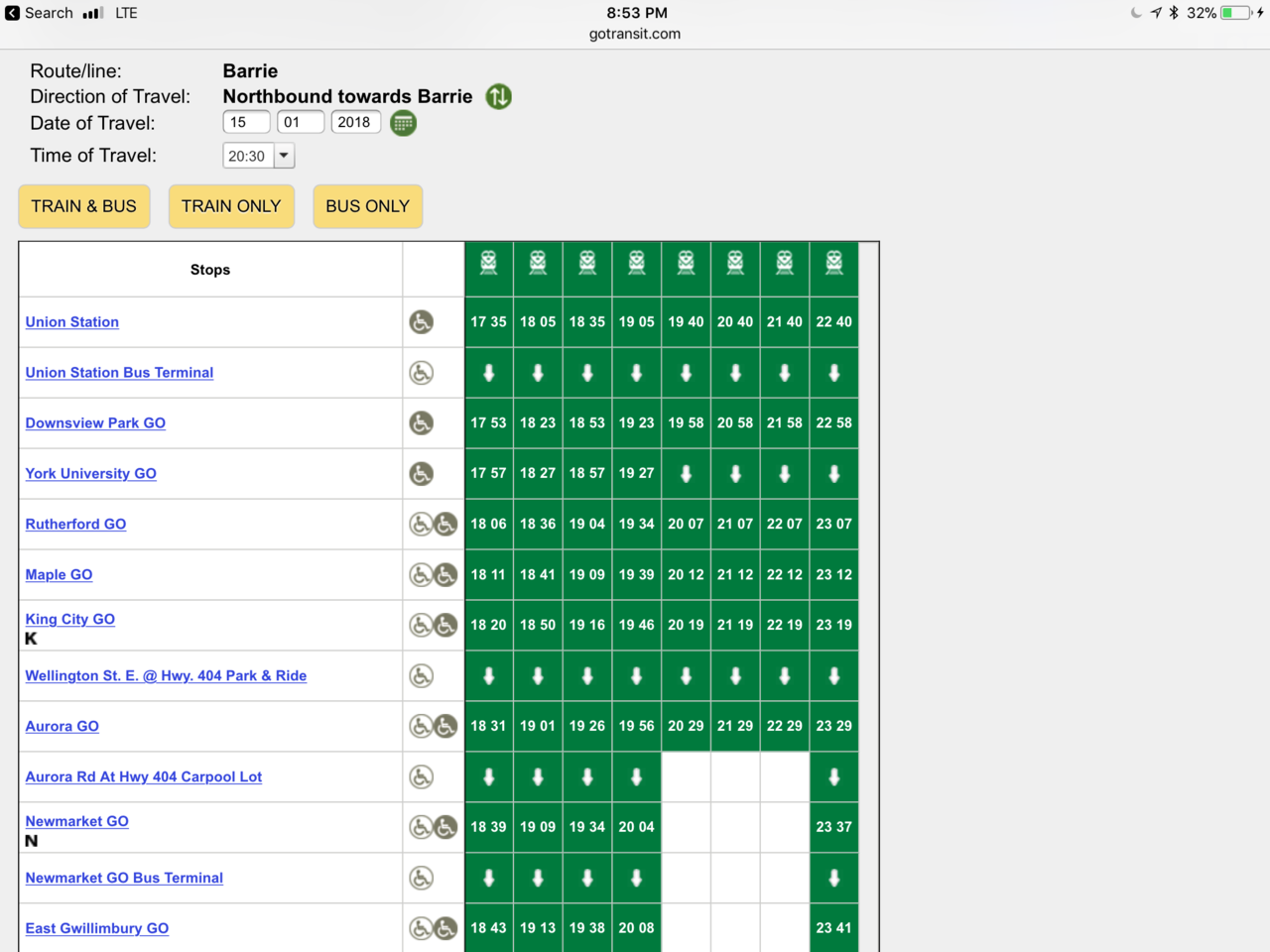

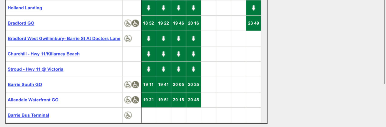

And yet, today's tweet on @GOtransit BR again reads "Allandale Waterfront 20:45".
Anyone have the scoop?
That's the 7:05pm departure, arriving at 8:45pm at Allandale Waterfront.
I checked the online GO schedule for a typical January 2018 weekday, that's what it says...
So yes, the train is extended to Allandale Waterfront. I trust the online/twitter more than I trust the paper schedule or not-yet-trained CSR rep.
