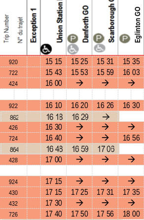

So in both the current and new Stouffville schedule, what is with that one afternoon northbound train that stops at Scarborough Station, but no other trains on that line stop there?
Fills a 65-minute gap in the Lakeshore East service at Scarborough. Train 724 (Union 16:40) has to skip Danforth and Scarborough to be able to turn around in time at Oshawa.
