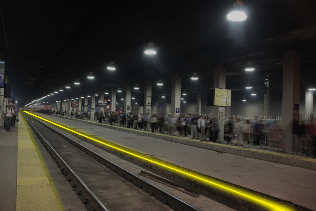

The platform edges should have some kind of LED lighting to alert people to keep away from the edge. Most people stand back while trains are passing through, but there are always some who try to make their way along the platform even when the train is literally right next to them.

Making platform edges more scary like yellow-black diagonal stripes. And maybe a flashing orange LED ribbon (industrial strength kind) (that flashes when a train is approaching or departing), even cheaply mounted on the platform edge wall, both sides of track. It will not be 100 percent but it would reduce the number stepping into the yellow zone during critical times, even by sheer peer pressure of people stepping back the moment they see the flashing. (1Hz slow flash). The same color as for school and construction yellow lights. The flashing light strip works well in some metro systems like the Washington Metro... (lightly enforced, as secondary responsibility of fare inspectors waiting for their trains) Fine if you are on the hazard zone during the flash.

Or both -- the hazard stripes, the light strip, and the physical barrier. Not mutually exclusive. Begin immediately with the easy/simple stuff like the light strip. The flashing light strip would warn when the barrier is coming up/down, too. That said, there is a headache for when the platform is so crowded a wheelchair person can't back away from a raising barrier, so there's some difficult decisions to be made (e.g. sensors). With so many 300 meter platforms, and the possible mechanical issues, especially in the winter with muddy/salty shoes, it may be infeasible maintenance-wise at Union station's scale (more than 1/2 kilometer of raisable platform walls per track!) with major service disruption when platform lowering fails.
However, 300 meters of a common infrastructure-rated waterproof LED strip reel (amber color, a few dollars to a few tens dollars per meter, something far more durable than the cheap reel stuff) rolled out and mounted inside an industrial plexiglas-windowed rectangular metal tube (3cm wide x 2cm deep) mounted to the small vertical platform walls on both sides of the track, would cost a mere few thousand per platform to install and easily maintained at night. This could be combined in with the USRC upgrades and new train traffic control centre -- a good initial stopgap with and/or without physical barriers. At about 1 watts per meter for fairly bright (but not obnoxiously bright) amber LEDs, it would consume only 300 watts for the whole platform length (600 watts for two edges of platforms); and only consume power briefly while a train was approaching/departing. It could even steadily illuminate as platform-gap safety lighting while the train is stopped with doors open.
And being LED, would be extremely durable for years, with main risk being temperature swings and vibration damage causing breaks in the ribbon, but such ribbon is frequently used in adverse conditions and even underwater nowadays, and would be easily replaceable at night in ~5 meter segments, it wouldn't be embedded into the platform but as a ~2cm protrusion off the vertical surface of the low platform wall (roughly stairstep height) near the platform edge. So easy nighttime maintenance and no service risk upon failure (flashing failure), and upgradeable (e.g. replacement with more power-efficient, more durable industrial LED ribbon strips as they get released in the future, in standardized 12-volt 5-meter ribbon lengths; Some are cheap like $10 from china for 5m, at $2/meter, while other waterproof building exterior industrial ribbons costing $100+ per 5 meter roll, but probably cheaper in large quantities -- but all of them are 12 volt standardized reel ribbons. Pretty safe voltage.)
(This LED ribbon is waterproof and encased in plastic. But a more industrial version thereof -- there are building-exterior-rated ones frequently used to illuminate Las Vegas casinos too; easily installed & mounted below the platform on the platformwall above track; inside ~2cm x ~3cm metal rectangular ducting with plexiglass window strip -- for further weatherproofing -- and along entire platformwall of both sides of all platforms, slow-flashing 1 Hz during approaching/departing trains, steady illumination as platform edge safety light while train is stopped at platform. Carefully choose a strong industrial version rated for building exteriors & survives winter-time temperature swings, spending $100 per 5 meter rather than cheap ebay $10 per 5 meter).
!WARNING!: A train is approaching behind you; please step away from platform edge NOW!
Credit: Photoshopped version of Michael Kappel on flickr
Amber/yellow is an international hazard color; often flashing at stop sign intersections, school crossings, pedestrian crossings, etc. Slow flashing frequency, approximately 1 Hertz. Some city commuter/metro systems use a variant of this.
OFF: No train is currently approaching
FLASHING: (1 Hertz) Train is approaching or departing (step away from platform edge NOW. FINES ENFORCED.)
STEADY ON: Train is currently stopped at platform. Safety platform gap lighting.
(could also fade on-off for gentler flash, or dimmer if this is too bright)
Even if it just save just ONE life within the next 10 years, it'll have been worth it. And it's not mutually exclusive with other physical barrier upgrades too. We are becoming one of the busier low-platform stations in the modern Western world, and we are unfortunate to be saddled with narrow platforms and GO trains with dangerous undercarriages and protrusions; therefore this is a critical cheap safety modification of Union Station. Even just in the interim. Do it, please.
Cost estimate: A mere $100,000 for the entire Union station for top-quality waterproof ribbon and mounts, plus install labour cost. An economic fraction of a human life! This can actually save money; by potentially reducing Union station insurance costs too!

Just added a photoshopped image of my yellow warning ribbon light idea! I also made a small animated gif, and also tweet it to Metrolinx. Historically, they often reply to my "good suggestion" tweets (GO/Metrolinx just replied to me on the York concourse wayfinding modification ideas by forum members), and usually does the easy stuff. This is probably the biggest "ask" of a suggestion as it's a new feature requiring approvals from multiple departments, rather than a bugfix.

The flashing warning yellow strip would not deter 100%, but this combined with occasional enforcement of fines (by fare inspectors who are otherwise waiting for their trains, they'll have a hawk eye of people boarding the same door as theirs -- easy fish to catch as they often step forward before the train stops, and door positions are well known), and peer pressure (flashing light = danger).
