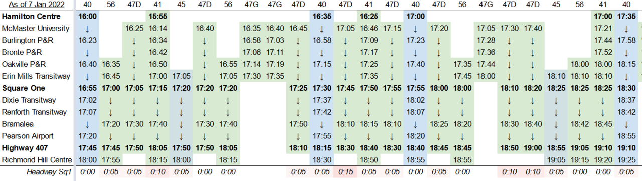

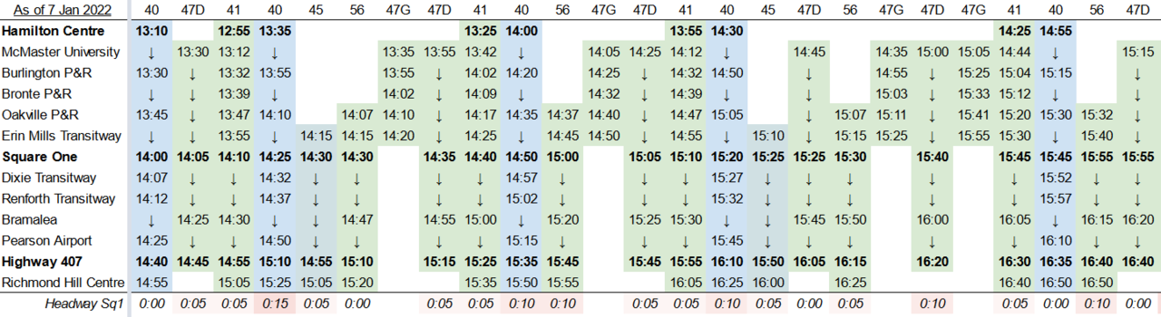

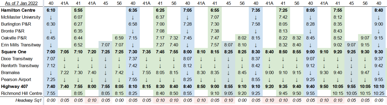

It looks like there’s not much happening this January. As far as the bus service changes go, there’s only schedule adjustments, the usual seasonal reinstatement of Highway 407 and university (Mac, UW/WLU) runs, and a few cuts to buses, such as those that weren’t cut when the Kitchener Line trains were restored. There are a few minor cuts elsewhere, it’s very much a reallocation rather than an overall increase.
