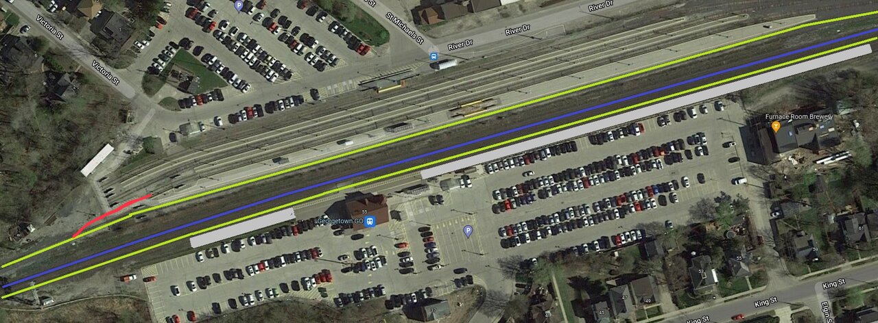

Georgetown GO is rule105 territory so either a mainline platform or signalizing the track would resolve it
Yes this is what I'm referring to. Verster said they would build a mainline platform. A practical meeting point is also needed for two way service since Georgetown is a half hour east of the passing track under construction in Guelph
The fact that the station and yard are in the same place doesn't help. But there is a signal west of the station where things tend to get backed up.
A passing loop (second track) and second platform in Acton are part of the next “package” for the Guelph Sub. Agree that more in Georgetown is needed too, along with the Silver Grade separation.
