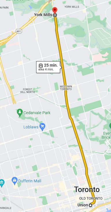

I don't think a 2-hourly midday service from Old Cummer to Union would make any sense. The southern segment of the Richmond Hill line is notoriously slow, so it is only really competitive with the alternatives during peak periods when the DVP is jammed and the Yonge subway is overcrowded. The GO train takes 25 minutes to get from Oriole to Union, which is exactly the same time as the subway from York Mills. Currently half of the 401 GO bus routes go to York Mills, while the other half go to Finch via Sheppard-Yonge, which is 28 minutes from Union.
Even if you incorrectly assume that everyone is going specifically to Union Station you'd still be better off dropping Richmond Hill and 401 East GO bus passengers at York Mills than at Oriole.
Line 1 runs every 4 minutes, so including 0 to 4 minutes waiting and 2 minutes walking between the platorms, it would take 27 to 31 minutes to get to Union after being dropped off at York Mills.
Timed transfers from GO buses to GO trains are scheduled with a 15-minute transfer time to minimise the risk of missing a very infrequent train. So it would take 40 minutes to get to Union after being dropped off at Oriole.
Even though it would take 401 East and Richmond Hill buses 7 minutes longer to drive to York Mills than to Oriole, York Mills would still be 2 to 6 minutes faster for the passengers headed to Union, and much much faster for passengers headed anywhere else. Sure, some passengers might still choose to take the GO train for its superior comfort, but that small benefit definitely wouldn't justify the 5 minute-delay that serving Oriole would incur for 401 East GO bus customers.
