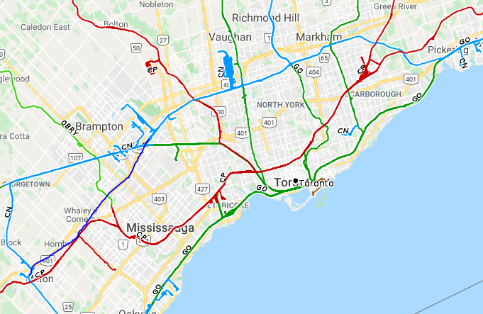

The 'Missing Link' was envisioned to do two different things.
One, was to remove CN traffic from the portion of the K-W line running through downtown Brampton, via the dark blue/purple in the image shown above.
Two, was to remove traffic from the CP line between the missing link's westernmost point (red through midtown); and shift it to the blue (CN) across the top of the City, via the same routing.
If you look at the dark/blue purple line, CP traffic, theoretically could have been diverted from ~ Milton to roughly Rouge Park, where the CN York sub heads south and crosses the CP mainline.
This would allow for greater Milton Service, but also a Midtown GO line to Agincourt (or points beyond)
That said, you're not wrong that the initial suggestion was to focus on CN and freeing up the K-W corridor; but the CP line component was being talked about; though not with CP to my knowledge.
The Mississauga Study I cite below considered a 3-track configuration, but I know a six-track model was looked at.......2 for CN, 2 for CP and 2 for passenger rail.

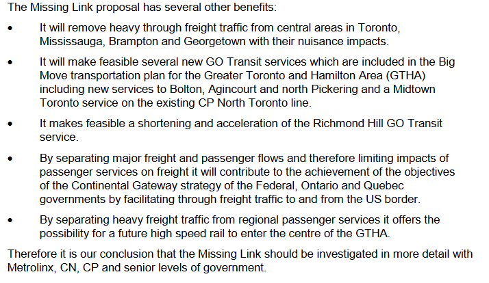

Mississauga did a report on this :
Link here: https://www7.mississauga.ca/Departm...ction-2018/Missing-Link-Feasability-Study.pdf
From Said Report:

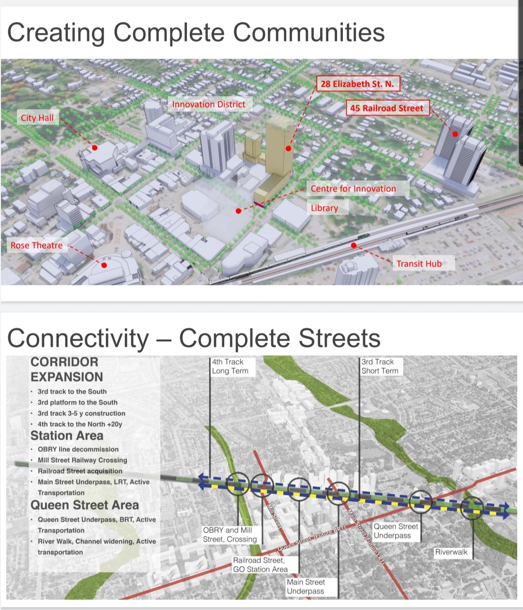

Just to be clear. The current plan for the halton sub is to have a 3rd track through downtown brampton. And a grade separation at Silver or somewhere between Mount pleasant and Georgetown?
Couldn't they put 4 tracks through downtown brampton and relocate the existing station?
I'd think there'd be space - the ROW looks to be over 120 feet wide - is that enough for 6 tracks? 5 for sure.
Can they do 2-way all-day with just one new track and a grade separation? There's already 3 (and in some places 4 tracks) almost all the way west to Brampton, and then from just west of Brampton to past Mount Pleasant.
The documents showing the changes around Brampton that I saw a while back (in City Council minutes, I think) did indeed show a fourth track pencilled in on the north side. The heritage depot would be moved.
Why not do it now? To keep costs down for a while, I presume. One step at a time…..
