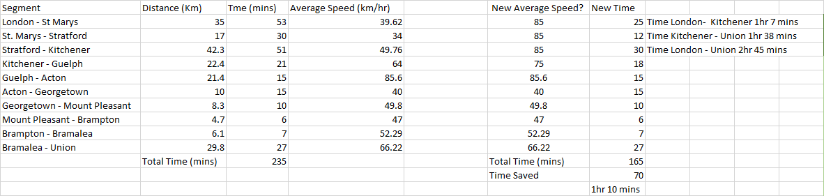

I did some basic calculations assuming a speed upgrade on the London-Kitchener Segment to an average of 85km/hr and with your calculation for guelph
An upgrade to the London - Kitchener Segment of the line would save at least 45 minutes and maybe an hour depending how fast they can get the tracks to. The potential upgrades at Georgetown could also save another 10 minutes but aren't shown here. the total time would then be 2hr 35 minutes for London-Toronto and 1hr 28 minutes for Kitchener - Toronto.
