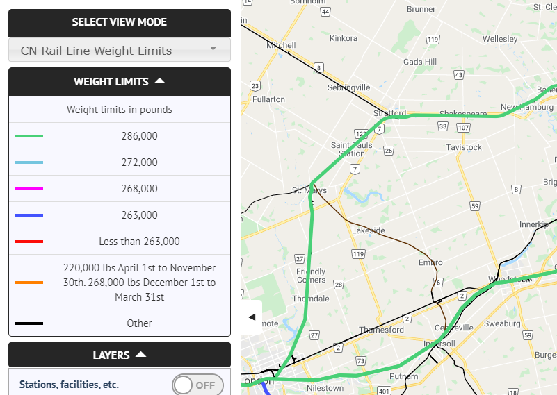

^A quick browse through some old documentation tells me that the whole line had a weight limit of 268,000 pounds as far back as 1978. Heavier locomotives have been known to use the line occasionally (mostly on detours, and sometimes when the old GM plant needed to do testing on new units) but any heavy car or locomotive would have had its own documentation and specific restrictions.
The CN rail map shows the North Main at 286K. However, as we saw with the ALP-45 derailment in Montreal Central, the track forces exerted by the trucks on an MP40 may trump the nominal weight limit.
It should be noted that all of the other lines in the GTA also have that same 286k weight rating according to that map, and yet the MP40s seem to operate on them without difficulty.
For the record, the ALP-45 derailment at Central Station had to do with a poor wheel profile choice and a different truck design that was far more restrictive to turning forces than the weight of the units.

Just out of curiosity, is this the case though: "The biggest drawback to GO in London is weight restrictions in St Mary's."?
I don't know. I've never heard of this restriction before - only in the railfan community.
And as Paul correctly pointed out, much heavier locomotives have operated on the line before, and in fairly recent memory too. So at first blush, it does not appear that it's strictly a weight loading issue.
Dan
I would say it's true from a specific narrow perspective, but taken in the bigger picture it's hyperbole.
The bridge is likely where GO trains (and VIA, for some time now) move the slowest at present. And it's a single significant cost item to rectify. But the line in its entirety needs fixing up. That single slow bridge is hardly what's impairing service..... the slow end to end speed is a bigger problem. Running slow over a single bridge is not that big a deficiency.
It may be a (hypothetical number pulled out of thin air) $10M tab to fix the bridge, but it's also $1.5-2M per mile to fix the 60ish miles of track west of Kitchener. So not the only biggest drawback, in overall cost, just possibly the biggest single line item.
