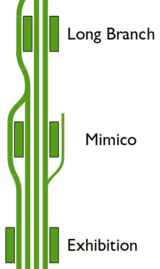

While the most part of the line is triple-tracked, there is just enough quad-track east of Long Branch to make bidirectional express service practical in addition to 4 tph local service. Since half of the service doesn't continue west of Oakville, there's enough room on the west portion of the line for an eastbound express to operate entirely on the eastbound local track. On the eastern portion, eastbound local trains pull off onto their own line at Mimico, allowing the express to overtake them at Exhibition.
Here's an extremely oversimplified track diagram of the east end of the line:
And a timetable showing how eastbound express service could be overlayed onto 4 tph local service while only using a single track through the triple-tracked segment, leaving the two other tracks totally free for VIA and westbound expresses.
I showed the local service turning back at Burlington (assuming the aforementioned pocket track is reinstated) since this reduces the fleet requirement by 1 train compared to running all the way to Aldershot. That's already a third of the 3 trains required to provide a separate hourly express service to Hamiton (3h round trip / 1h headway = 3 trainsets).

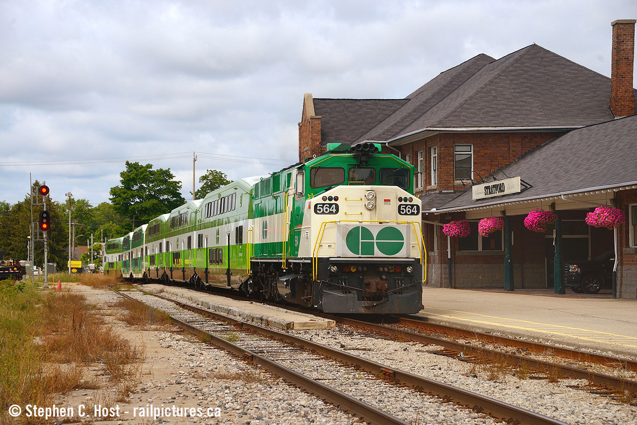

What is the length of the Stratford station platform? Can I handle a L6 or L10 GO train?
