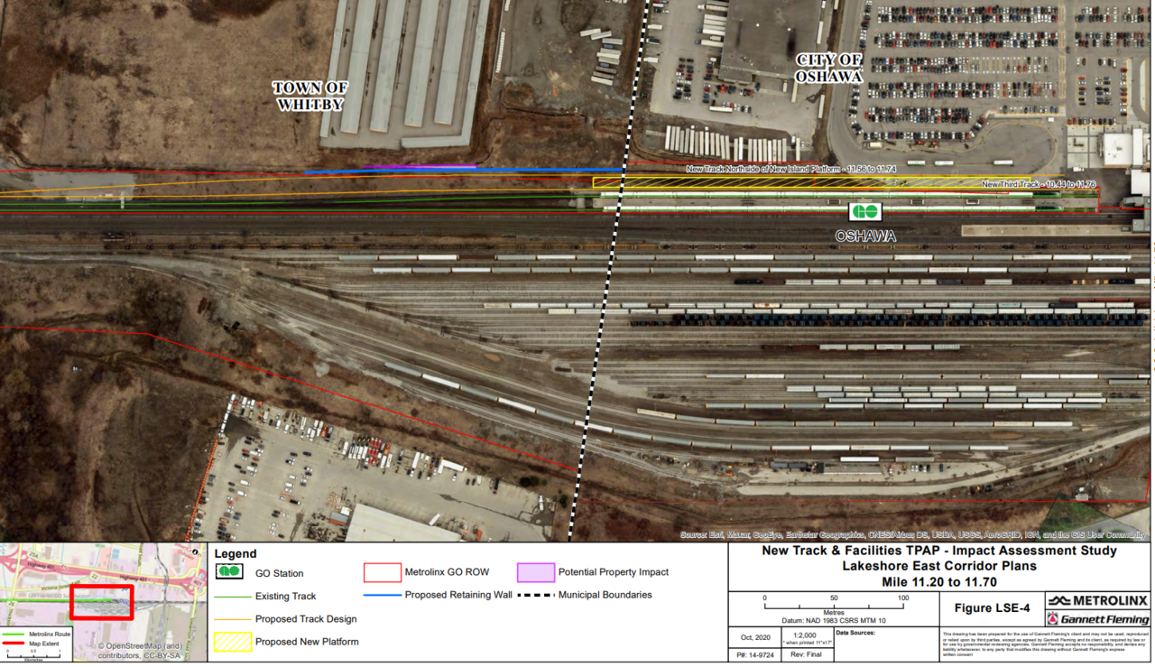

This could go under GO Construction, but I'll put it here since I'm going to refer to the Bowmanville Extension. I wonder if the drawing below from PDF page 40 here provides some insight for what may happen at the Oshawa Station for the Bowmanville Extension. Source: https://www.metrolinxengage.com/en/content/new-track-facilities-environmental-project-report

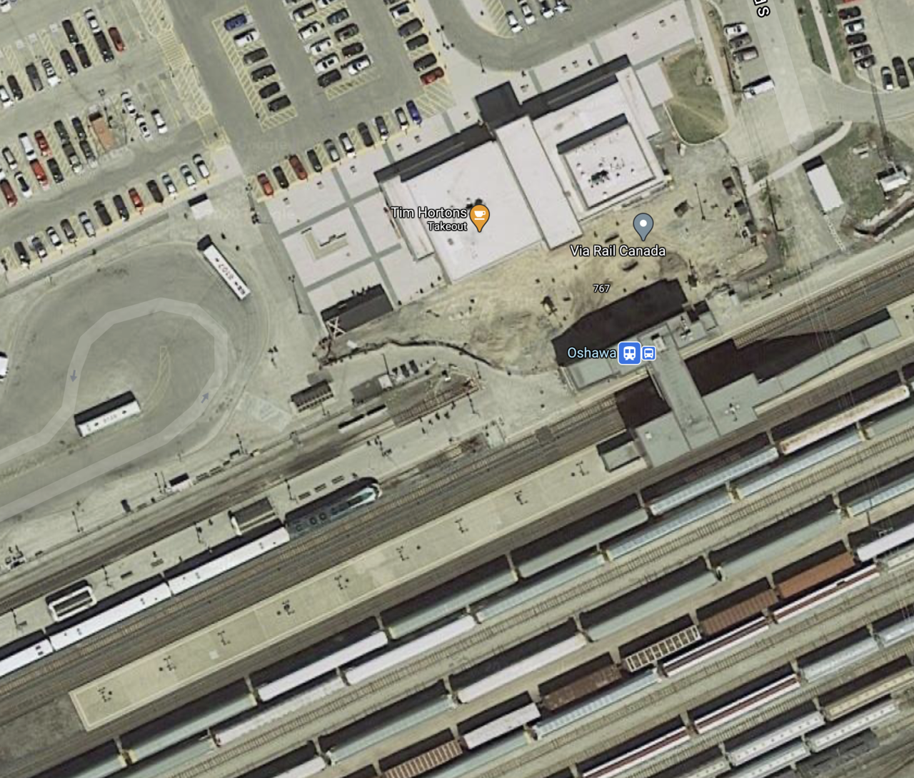

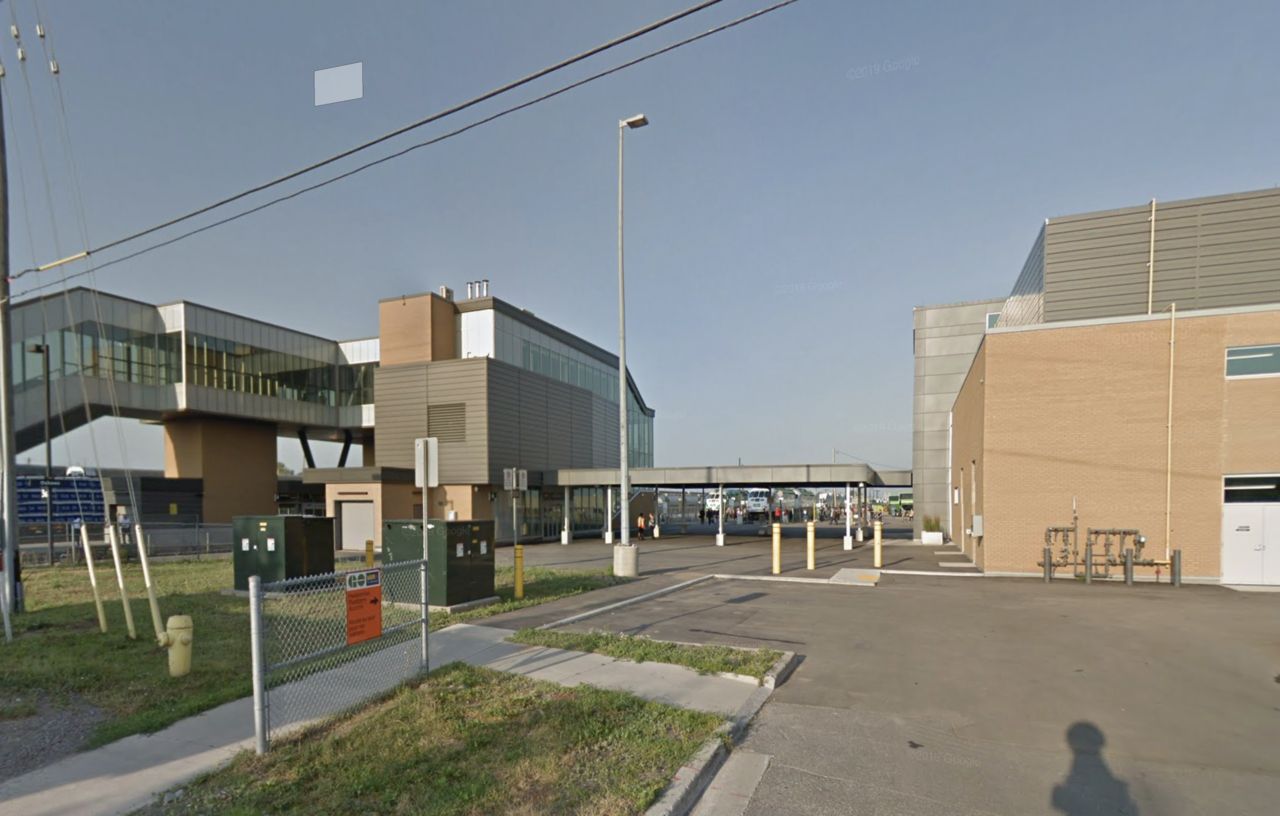

Dashed lined for the Extension added below. Not sure if a second track would extend under the new Oshawa Station platform bridge (picture here looking west towards the existing GO tracks).
Did you add the dashed line yourself? Ok that confused me for a bit.
What you are seeing here is a third track and 2nd platform being built out to Oshawa simply for being able to roll trains out of the whitby maintenance facility into oshawa easier and start trains there.
Granted the bowmanville extension will be changing up the Oshawa go station in 5 years, but again that project is unrelated and changes will be made then.

Totally get that the project is separate from the Bowmanville Extension, but is it safe to assume they've designed the platform/track for this TPAP in a way to make it easy to do the Extension? Given it's now been over a year and a half or more since the CP GM spur route was mentioned (at the May 2019 Durham townhall) I assume that there was some alignment.
The changes at Oshawa station aren't an impediment to that. The proposed change merely moves the existing platforms to fit under the new station passenger bridge. T
Just for clarification re "The proposed change merely moves the existing platforms to fit under the new station passenger bridge" - from the above track plan, it doesn't look like to me any of the existing platforms need to change? It looks like they are only adding a new platform to the north.
That's a good point. I took another look at the drawings. My first thought was that once a track is extended eastwards, all track access would have to be from the bridge.... but it does look like the new track is a stub track, which effectively shifts the two stub tracks northwards, so they can be accessed at grade. It would be the southmost existing stub track that is extended, and that wouldn't block at grade access to the other two.
^ Yes, I did add the dashed line. Sorry, thought I made that clear.

I just had to poke at the Oshawa platform layout a bit more. The northmost platform at present is a siding track connected to the Kingston Sub, and accessible from the north. No bridge is needed at the moment, but if a GO Bowmanville track is extended towards Bowmanville, that bridge will need a new section added (it's likely roughed in already) and the only access to VIA will be by going up and over.
Seems unlikely that the current south GO track could be bent up and through the gap on the north side of the existing bridge stairway, due to curvature. So it is indeed a puzzle as to GO's intention. Given that the latest plan is for 2WAD all the way to Bowmanville, one would expect GO to want two tracks through the depot. The change in the layout of the stub tracks could be interim, I suppose.
